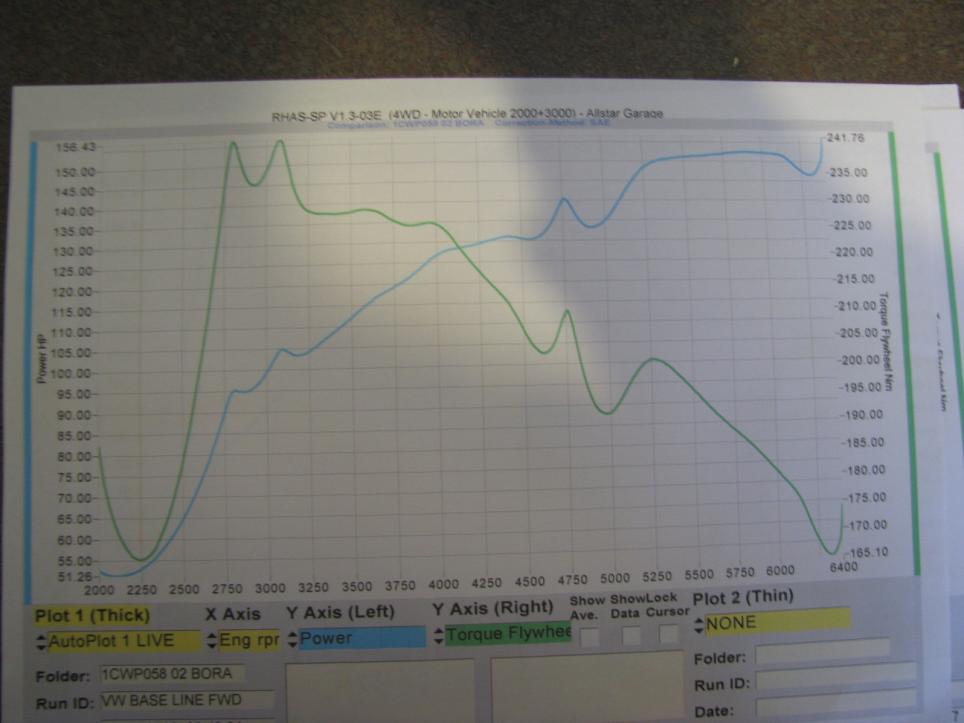

    First run in 4wd, you can see how jerky the curve is as the haldex kicks in and out
    I then pulled the fuse so we could get more accurate figures in 2wd mode

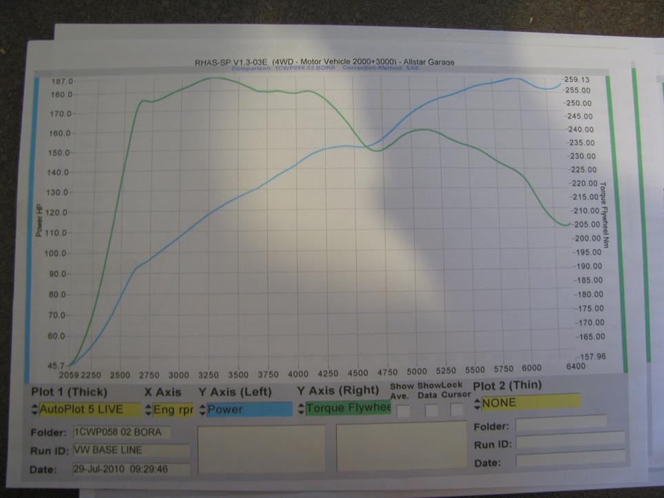

    Torque - You can see how early it makes peak torque, great for daily driving

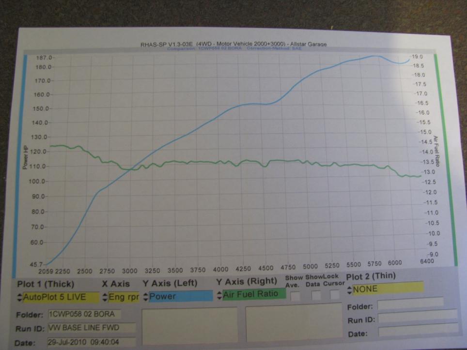

    Air/fuels - Nice and smooth, could run a little leaner for more power, but for a mostly factory tune its good. Gotta love wideband controlled ECU's

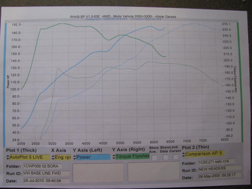

    And a quick comparo to the old car (2L VVL SR20VE) - almost the same power but a lot more torque
    Cams are going in next week and will have another run, should hopefully crack 200whp

    Wow definately interesting.
    Didn't realise it was that dead under 2800rpm, looks worse then it feels.
      thats just when the dyno operator got the foot down, its hard to get meaningful readings down that low

        It also doesn't help that these car are drive-by-wire, and so the ECU determines how quickly the car develops power, there's no direct physical relationship between the accelerator pedal and the throttle opening.
        Nothing to see here...
          yeah, it looks like the DBW throttle also pre-empts the rev limit and drops power at 6000rpm too

            187hp, that's 140kw, and the motor is 150kw from the factory right?
            So with ~20% drivetrain losses for front wheel drive, stock should be around 120kw atw.
            where do you reckon you got most of your power gains?
              yeah 150kw standard at the fly, so its a pretty good result.
              Dont think any one part has stood out, intake, exhaust and the superchips flash all probably helped, but I have no proof as I bought the car with all the power mods already done.
              Will be interested to see if I get the claimed 20-25hp gain the cams are supposed to be worth.
