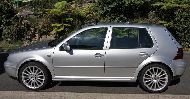

    looks good, bit hard to judge the wheel gap though with that shot and the 16's. Got any more pics?
    So that's a 2" (50mm) drop, and you don't have problems with front sway bar hitting driveshaft at full lock and corning?
    i thought it starts to become a problem after 35mm

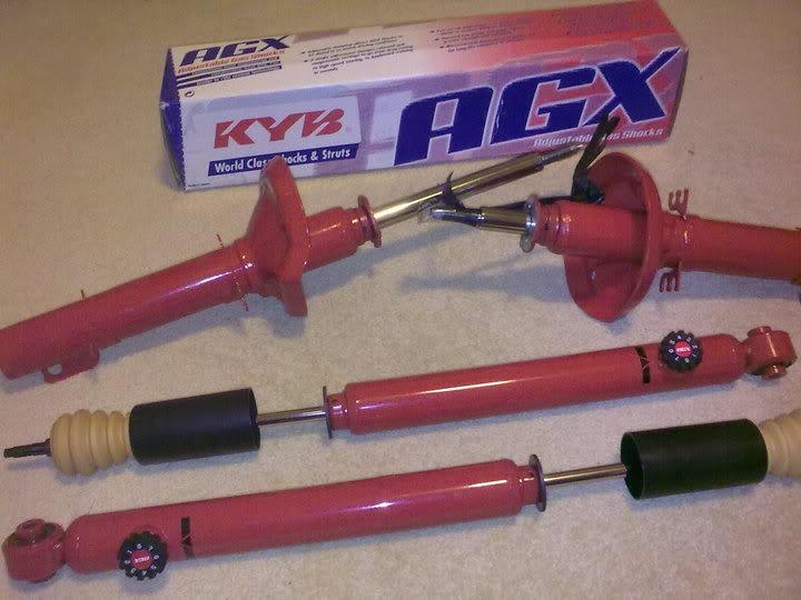

    My KYB AGX shocks arrived today
    Didn't know shocks were slightly pre-loaded to fully extend, and the tape securing them had come off 3 of 4 of the struts and they were all extended. (it's ok for them to be stored fully extended isn't it?)
    Fortunatly didn't come through the shipping box as it was long enough. Not the best packaged job, but i guess that's ebay for you, they only charged me US$135 shipping from the states which is pretty decent. Anyway already adjusted the knobs, front is 3 from 4, rears are 6 from 8. strange that the rears have more adjustments than the fronts, thought it'd be the opposite. (the higher number is stiffer i believe)

      surely that previous photo isnt 2"? its no where near tyres being near guards on stock wheels (or have you got a smaller profile to standard?) its defiantly lower and tidy looking, but not that low
        Originally posted by KINEZ-0 View Post
        [/URL]
        i think it's probably lower than you realise, that's why i wouldn't mind seeing another pic
        you gotta remember that the stock wheels are et42 and only 6.5" wide, so they are quite recessed into the car, which I guess makes them look further away from the guards. and being only 16's sort of makes it hard to see where the rubber stops and the gap starts. If you click to enlarge pic you can see it a bit easier.
        And if you look at the rear, the wheel does seem to have come forward like it does when you slam MKIV's.
        And for sure, i'll get pics when i'm done. i was hoping to have everything installed by two weeks time before a planned trip up the blue mountains, but ecs seem to be taking their time so i'm not optimistic.

          yeah could be. I was looking at it in the mirror to try and compare.
          I 2nd another pic! and get a tape measure out haha. photos never look as low as they actually are.

            here's my struts that arrived today, not the best looking things but quality seems ok.
            boots on the rear struts seem super dodge though!
            Do you re-use the stock dust boots for the fronts?

                  MY GAWD! i knew they came high but i dont think iv seen one like that, front looks higher then the back for once?
                  no wonder you got a 2" drop without changing the sway bar haha. i understand now... How many KM on the car when you had that pic.
                  I only got the suggested 40mm lower and i was wearing out drive shafts.
                  I reckon! I was thinking maybe it wasn't a gti, but there's an intercooler on the front...
                  this is my car atm, with stock suspension. i've got a feeling it has sagged a little bit, because i compared it next to a Golf SE last week, and my car was considerably lower.
                  But this pic is a little misleading because the road is slopped towards me which makes it sit a bit lower on the side the pic is taken (the other side would look bad)
                  I'll try get equivelant photos of before and after on level ground...
                  btw that last pic from KINEZ looks much lower than the original pic posted. looks very good in that pic
                  Don't forget when we say 2", or in my case it will be 1.5", this means the reduction from the standard height of one of the regular models.
                  the gti is a bit lower out of the factory, and yeah I gues it sags a bit
                      agreed, i bet with your 18 wheel and tyre package they are bigger rolling diameter also with a stiff side wall. actually making your car higher. but should be closing up the wheel gap a bit?
                        Yeah, re-use the stock front boots. You don't have to but it just makes things cleaner on the piston rod
