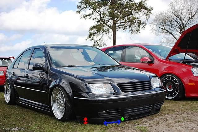

    Looking at getting a 4mo front lip for my bora (from ECS as apparently they have one that'll fit my 2slow), just wondering if anyone can get me a measurement of overall height (red), and also the height (green)/width(blue)/depth of the two outside cut outs on their lip.

    The lip starts off at 110mm right at the tyre and comes up to be 100mm as it turns accross the front of the car.
    That opening is 50mm high but it's not consistantly deep. Right accross it's 255mm but only 100mm of that is very deep.

            I think the depth overall is very similar to the 4mo, but it curves up to the front instead of coming almost straight forward to give that vertical shape at the opening like the 4mo.
            I really struggled to get a measurement on it due to the curve sorry.
            I guess if you need a few more cm clearence just at the front it will do the job. I know i wont be upgrading just yet as mine touches just about everything at current height and by swapping it will basically make my car longer and a bigger problem.

                  Just to update this. the bora 2lt and 4mo ones are the same heights as far as i could see.
                  difference being the 4mo is squarer, making the front have more over hang at the lower point.
                  ...meaning if the 2 lips were taken from flat ground up a ramp the 4mo is likely to scrape.
