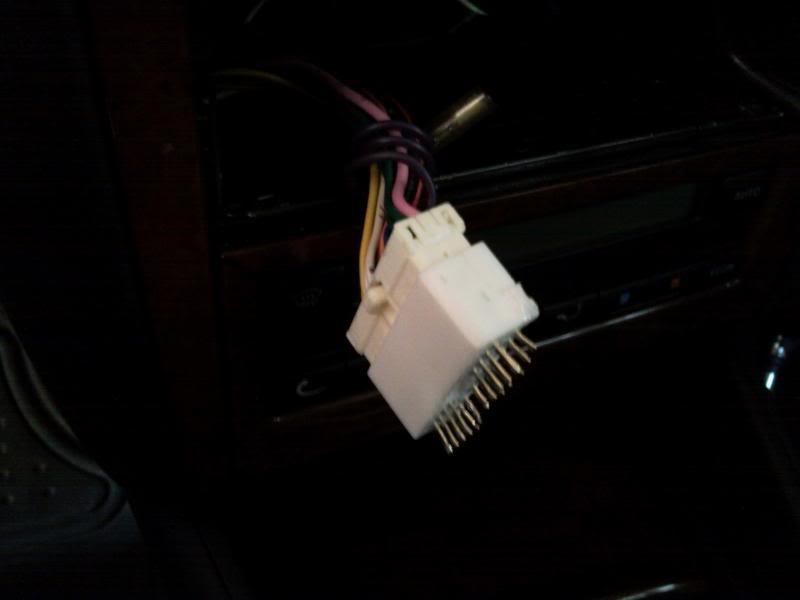

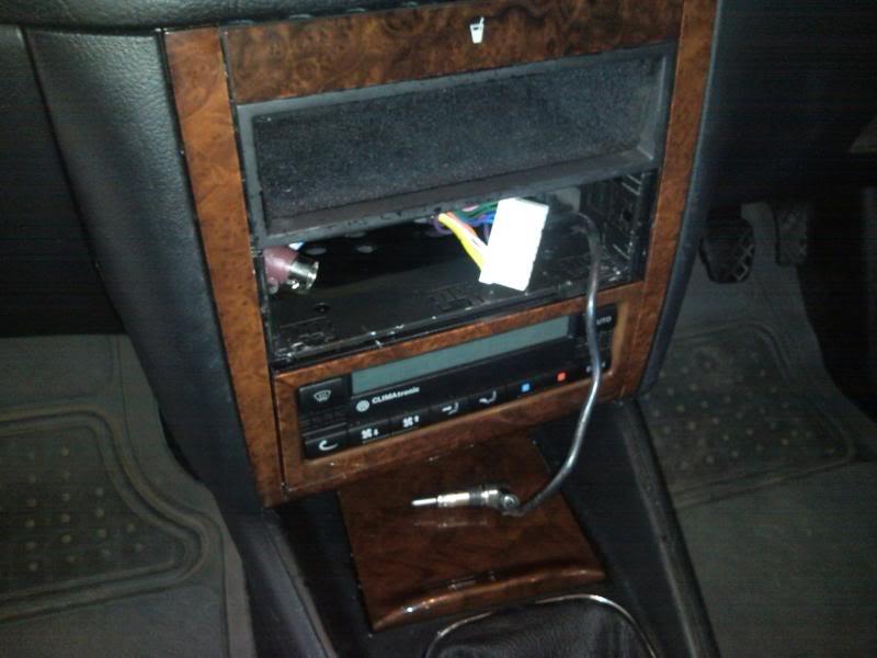

If you grab your old unit out of the dash you will we the part we are after.
Hopefully if nobody has been there before you this is what we want to see.
I tucked the stacker cable behind the dash as the unit as I am putting in is just a single disk changer.

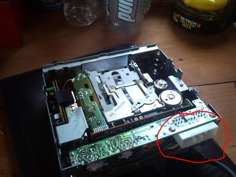

Now to time to destroy!
With the unit opened up you can see that the plug we are going to turn into an adapter is soldered onto the circuit board. I tried to get the part out gently but in the end gave up and settled on a less dainty approach

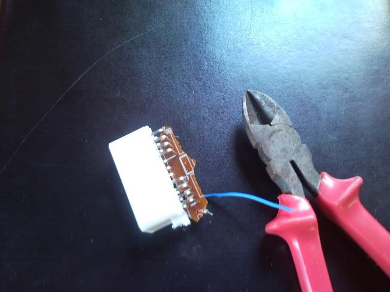

Wire cutters! Take that Eurovox!
Here is the part free of the old circuit board ready to become an adapter. I plugged it back in to check that it still fitted in after my hacking
it did

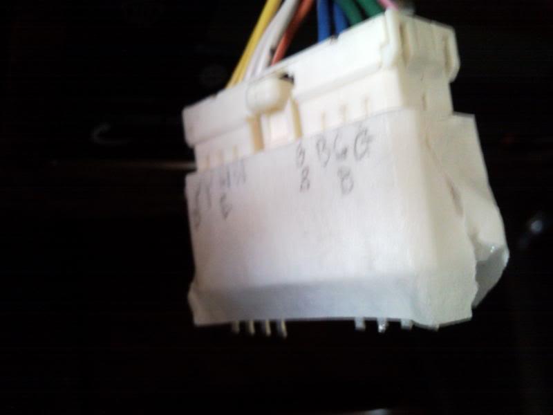

I stuck a bit of masking tape onto the plug to take note of what wire came out of that connection so didn't connect positive to negative or anything silly like that.

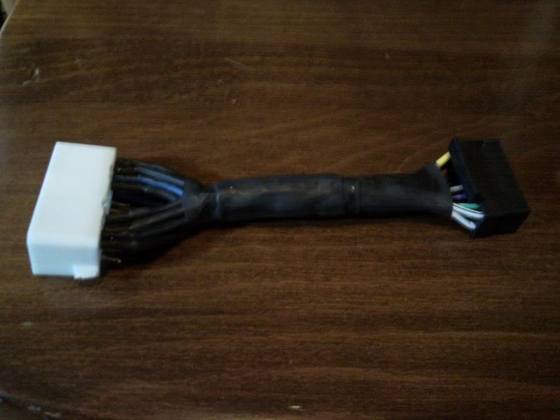

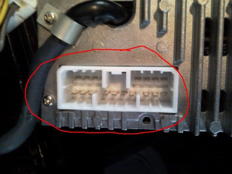

Now I grabbed my trusty soldering iron and some shrink wrap and set to business. I didn't take any photos of the soldering process as my hands were kinda full, but it was just a matter of matching the wires up, there is a wiring reference on the forum if you do a search, and your new head unit should have a wiring diagram to match up.

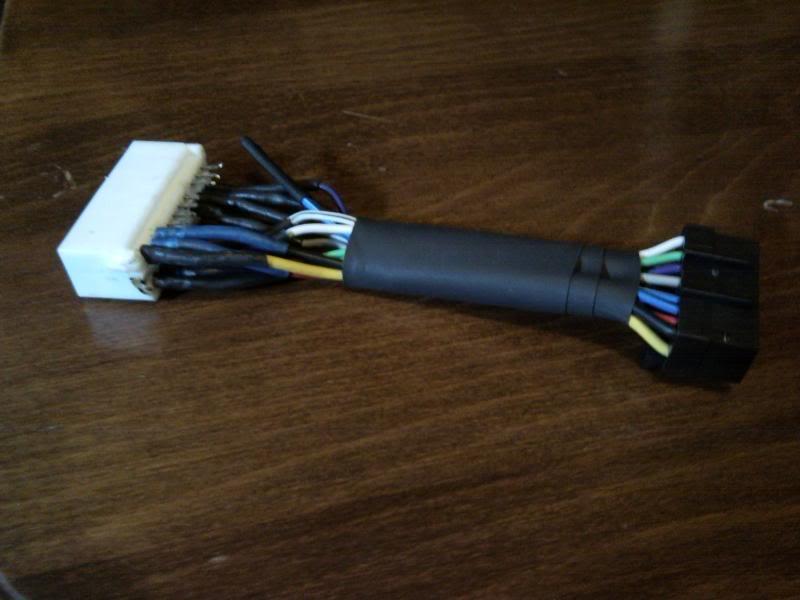

Here you can see how I shrink wrapped the terminals to make em nice and safe.
And here is the finished product.
Was just a matter of plugging the unit in and turning it on! Works a treat! I'll take some shots of the finished dash tomorrow for now I am going to have a quite drink
