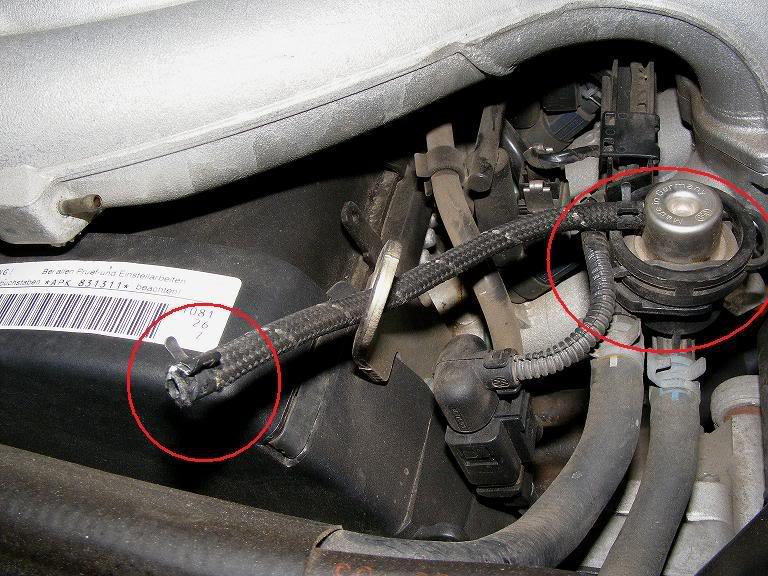

    Hey guys,
    today I decided to clean the engine bay of my Golf (2.0 Sport) and took the engine cover off to discover this little hose not connected to anything yet it has a little clamp on the end of it.
    Does anyone know what this hose (circled in red) does and where it connects?
    Any help would be much appreciated.

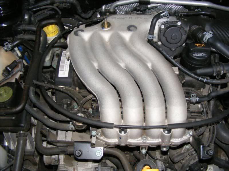

    lol, open your eyes! (look where the hose is pointed!)
    no idea what it is though
      I should mention, I put it through that metal thing so it was easier to take a picture, It was hanging down when I found it.
      Mk3.Mk4.Mk1
      My Mk1 Project
        In the second picture on the left hand side on the inlet manifold there is a nipple....attach it to there.

            its a vacuum line attach as above your car would have been idling poorly
              Thanks Will, done and done.
              I can't believe that I didn't even see the nipple right there.
              Mk3.Mk4.Mk1
              My Mk1 Project
                Thats your fuel pressure regulator on the other end of that vac line
                Kinda important
                  So you are gonna have 2 crap things happen with that off, excessive fuel consumption, too high fuel pressure, and drawing secondary air, very inportant and yeah that was 3 points
                  Renew the pipe mate its stuffed
