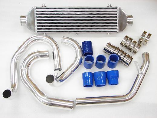

    hey guys! i was just wondering have any of you install a Front Mount Intercooler in your mk4's cause i'm stuck on how to mount the intercooler and where.
    this is the kit that i have
    everything is made for the mk4 but when i took off my bumper it had me stuck for answers!
    any suggestions please?

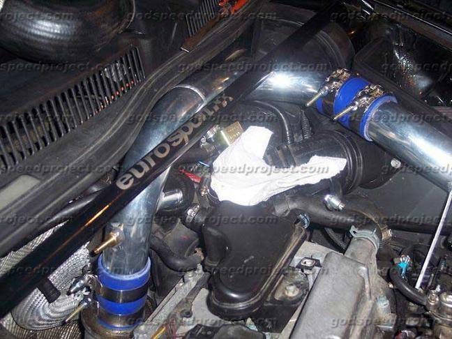

      here are some more pictures:

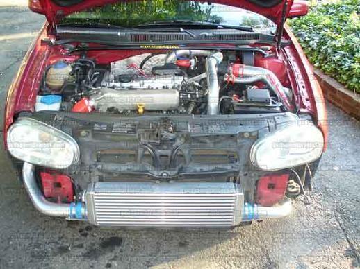

      this picture here has a different intercooler but the piping is the same, i just dont know how to mount the intercooler on and where to.
      i know this pipe is going towards the turbo. dont know the details and extras

        Similar idea to my A3. Pictures sent. I reckon a trip to Bunnings for some aluminium bar and stainless bolts would be the way to go. You can see in that album how mine was mounted. You'll be able to do somethiung similar no doubt.
        Gavin
          i dont want to cut the front bar. its mean to me lil modding to get it to fit.
            I reckon yours is shallow enough to fit under the bumper without cutting. I wasn't bothered about that and wanted the biggest IC that could go in.
            The aluminium is just to make brackets from.
