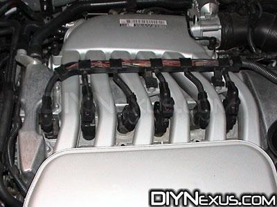

    what ignition leads to use and where to get them ??for 2.8 bora with coilpack
    My V6 2.8 Bora doesn't have leads. The coil packs are right on top of the plugs. Your car may not need leads?

      Yeah, I am thinking the same. I thought they were all single coil pack motors.
      Gavin
        Pete and Gavin are correct.
        The Mk3 VR6 had leads, but the Mk4 V6 went to t coil-on-plug design - the coilpacks sit directly on top of the spark plugs in the top of the engine.

          i dont have the coils on my leads i have the coil on its own
            should i be looking at mk3 leads. but they dont seem to look the same .im starting to think i can only get these from the stealers
              Andrew what's the engine code mate, sticker in the service book or the spare wheel well.
              Or a photo of the engine, we are still not convinced that his engine needs plug leads.
              Gavin
                mine is late 2001 2.8 whats you model must be later
                Pete
                  So where are the coils sitting?
                  On the Mk3 VR6, they sat on the passenger side of the engine IIRC.
                  My understanding though is that all 24v V6s in Mk4 cars have individual coilpacks situated directly above each of the the spark plugs, and thus there are no leads.
                  Nothing to see here...
                    Still need your engine code to be sure but it does look like it has leads as you say. VW or Imparts would be the source for them.
                    What makes you think you need them? I am not a big fan of changing stuff unless they are broken, especially as they are likely to be big ticket items.
                    Gavin
                      The 2001 V6 Bora used coilpack with leads . They are different to mk3 VR6 leads in that they have a puller attached to them

                        would this be it 1j23w7 or is it this aue
                        Gavin
                        http://www.vagcat.com/epc/cat/vw/BO/...08/57/2549055/
                          AUE is the one and in that link I posted there's all the VW numbers. Item 13.
                          Gavin
                            thanks for that . i had a look and become a member (had to) .from what i understand they sell them individualy cyl 1 cyl 2 ect . can i change my set up
                            to the later model setup from the bora ??
