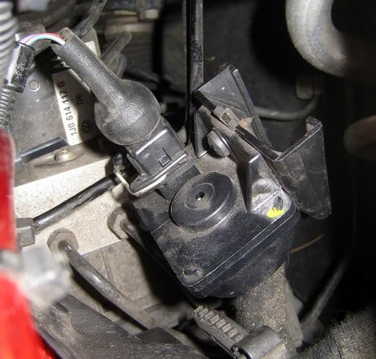

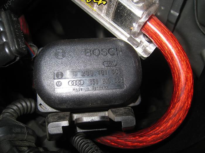

                can anyone identify what this is? and where it goes???
                here's the back of it. seems to have a mounting plate on it. and underneath there's a hole which looks like it could be some kind of sensor... dunno

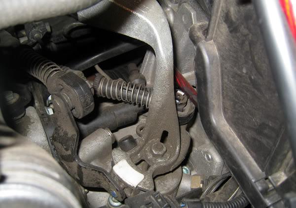

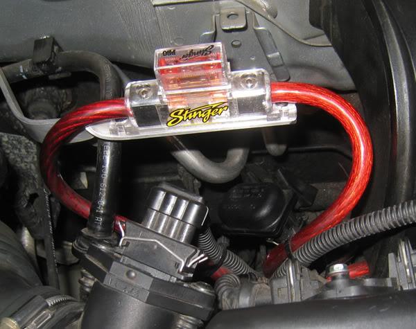

                another thing i noticed, i got my stereo installed 9 months ago by one of the main guys in the business... i have to say this looks very suspicious, the positive wire to the amps is very loosely running up against what looks to be a mechanical part in the engine bay... not sure what it is but doesn't look like a good idea... what is this moving arm?

                  according to the part number on it its a "Switch - Altitude corrector"

                    the bottom picture looks like the cable shift mechanism. The long weird looking thing is actually a weight that makes the shift feel nicer
                    FOLLOW US ON FACEBOOK
                      The cables with the spring connectors on them run back to your gearstick inside the car, and the moving arms are what actually selects the gears in your gearbox.
                      Nothing to see here...
                        yeah i did a google and found that... still no idea what it does though. would be nice if it was something like a boost pressure sensor, but i don't think so.
                        Ok i got my stereo installed by FHRX studios, and fortunately they photo the whole process of the installation, and it proves that they removed it from it's mounting position, and left it to dangle down below. (edit: no dramas, all fixed, simple error)
                        it's supposed to mount on that triangular bracket, though am having a bit of trouble getting it up there... daylight job i think.
                        still wondering what this sensor is for...

                          Its an altitude sensor . As your elevation increases the air gets thinner so the ecu raises the boost to compensate

                            interesting, so does have a little to do with boost...
