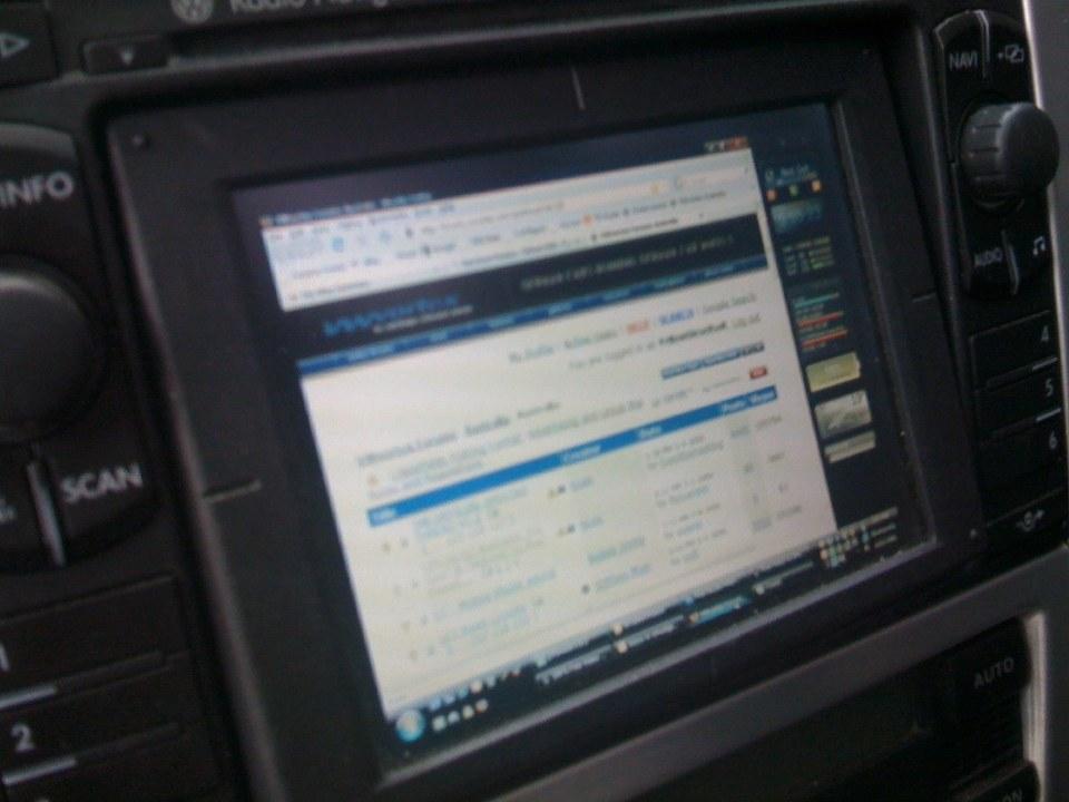

                          Functionally it works the same as the MFD but it has buttons as well to switch audio sources, from cd > radio for example. On the MFD you have to go into a submenu to do that!
                          Also has fast forward and rewind button which the MFD doesn't.
                          You just don't get that "Simpson-esque" cartoon map display.
                          The display replicates the one you would see in the dash display (the one in the pic below is just the compass mode display).
                          The buttons match the climatronic better too
