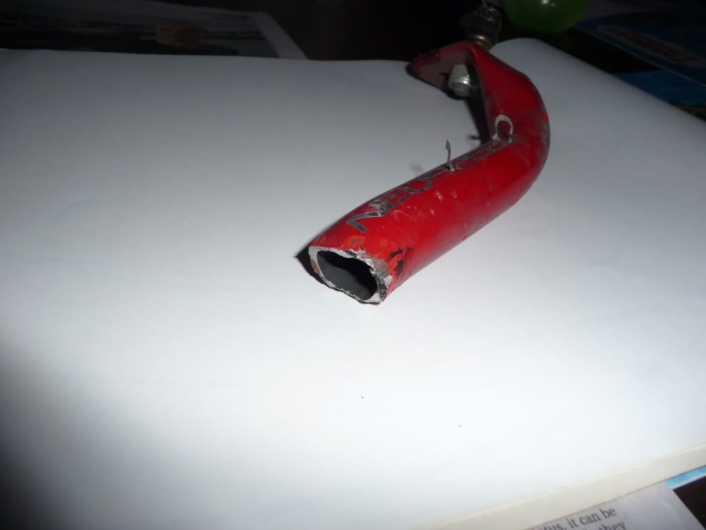

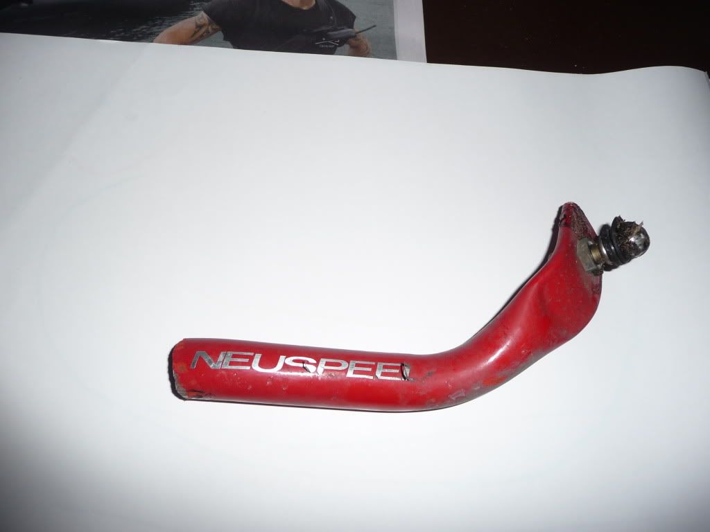

              My Anti-Sway Bar snapped too!
              I bought an Neuspeed Anti-Sway Bar for my Bora V6 4Motion (also the hollow 25mm) way back in January 2008. It has been great but today it snapped ?? I heard a bang and saw a section of red pipe shoot across the road. I was travelling less than 50kmph and on a very gentle bend on Burwood Highway (for those in Melbourne - who would know this is hardly a demanding piece of road). So given that it is almost 2 years old, I don't expect much come-back from Neuspeed.
              The advice I need is it worth trying to see if I can get the solid bar from Neuspeed (who may take pity on me and at least offer a small discount) Or what else would others recommend I look at? Whiteline? H&R ? Eibach?
              Picture attached and also this - photobucket so I hope it works!
              2003 Bora V6 4Motion
                its clearly a design problem. It cant hurt to contact them to see what they have to say about it.

                    I would be jumping up and down about it to them, obviously it is a design problem or they have a severe flaw in their installation instructions!!
