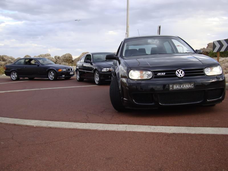

              Thats what i've done. I'll post pics if you want
              1991 BMW 318is RED E30
                yer that would be great.
