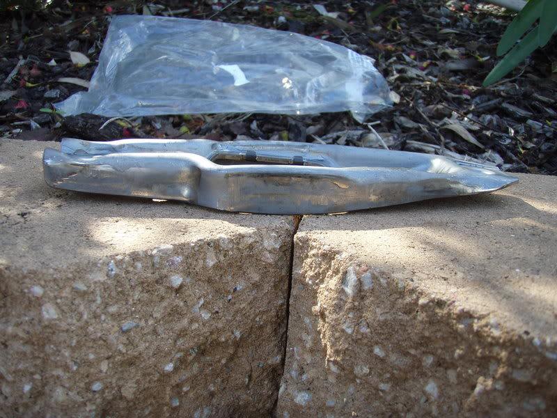

                    I don't think this is a problem with the clutch itself but the fork that holds the release bearing falling apart.
                    It a VW part and they are known to fail. I had one go on my A3, a new one was $44 from VW.
                    Look closely you can see the cracks developing.
                    The new straight one.

                        David Nelson is my contact, mate. You should have got back to me.
                        If you pull yours down and find the fork is dodgy, call me, I have mine in the garage. Only got a couple of thousand Ks on it.
