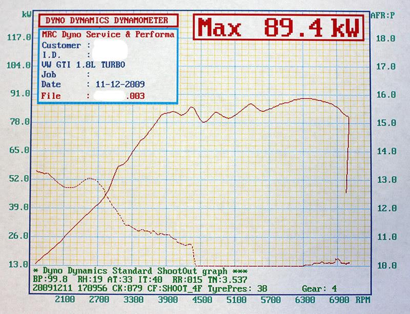

          • Got my car dyno'd at MRC in castle hill, and as expected, i'm down on power.
            3rd run in 4th got 89.4kW (it's a chipped gti running 16-27psi unitronic program). quite an ugly power curve too, quite jagged.
            but the air fule ratio is the most concerning. at 4300rpm, it drops from 10.8, to off the scale (ie. under 10), and only slightly gets back on scale at around 6400 rpm.
            i'll post the graphs in my MAF thread shortly...
            Oh btw, i've never taken my car to a dyno place before, but Marc from MRC was VERY helpful. spent quite a lot of time with the car and really showed interest in my cars problems. so for what its worth, i really reccomend him.
            they use dyno dynamics FYI.

            • Lets see the graph mate. Be more concerning if it were leaning, what flash do you have, some might like to throw a bit more fuel than others for safety.
              Cheers
              Jmac

                    Unitronic flash. They're from the states and have only been supporting the Australian market for a short while. Yeah i hear that they tend to run them a bit rich, but surely this is more than a bit rich yeah?
                    more here:
                    • go back
                      get it done in gear 3.
                      gear 3 for 5 speeds
                      gear 4 for 6 speeds
                      thats how we've always run the dyno days and gets the most accurate figures.

                      • i'm not gonna spend another 80+ to get it tested again just to get better accuracy.
                        i looked for a mainline one near work, but yeah i found this one nearby and they could do it the day after i called
                        anyway no-one told me to get it done in 3rd, so i let the guy do what he thought was best.
                            fair enough ..
                            with 4th gear you will get a low read out. get in touch with either crescent motorsports, tell them you know me otherwise todd from mainline and either of the 2 will sort you out ..
