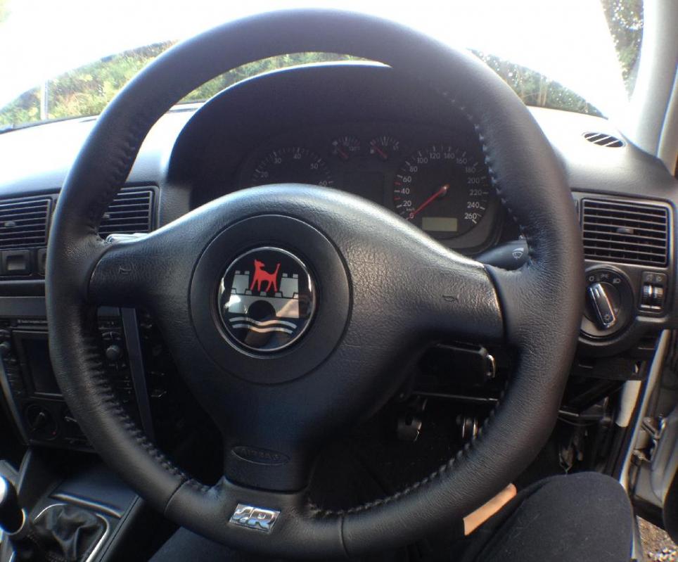

  • Originally posted by RolfGolf View Post
    Fit my recovered wheel this morning - .2kW extra ...
    How easy is it to fit that wheel. I cant get my old one off
    • Originally posted by sandwg View Post
      It's pretty simple really. Plenty of how to's on the internet such as:
      [Mk4 Golf] Help Steering Wheel Airbag Removal Doing My Head In - Interiors - uk-mkivs
      and even videos on YouTube detailing the process. (Some show removing the instrument cluster to get access to the rear of the wheel, but you shouldn't need to do that if you have a medium sized flat-blade screwdriver. You will however need a 12mm multi-point bit or similar to undo the wheel itself though.)
      P.S. I disconnected the battery prior to removing the airbag just to be on the safe side.
        Thanks, that's the info I need. I have the 4 spoke one and fitting a 3 spoke.
          No worries - this YouTube link shows what you're trying to do with the spring clips. (Disregard the fact the guy has trashed his wheel!)
          Volkswagen MKIV 4-spoke steering wheel airbag removal - YouTube

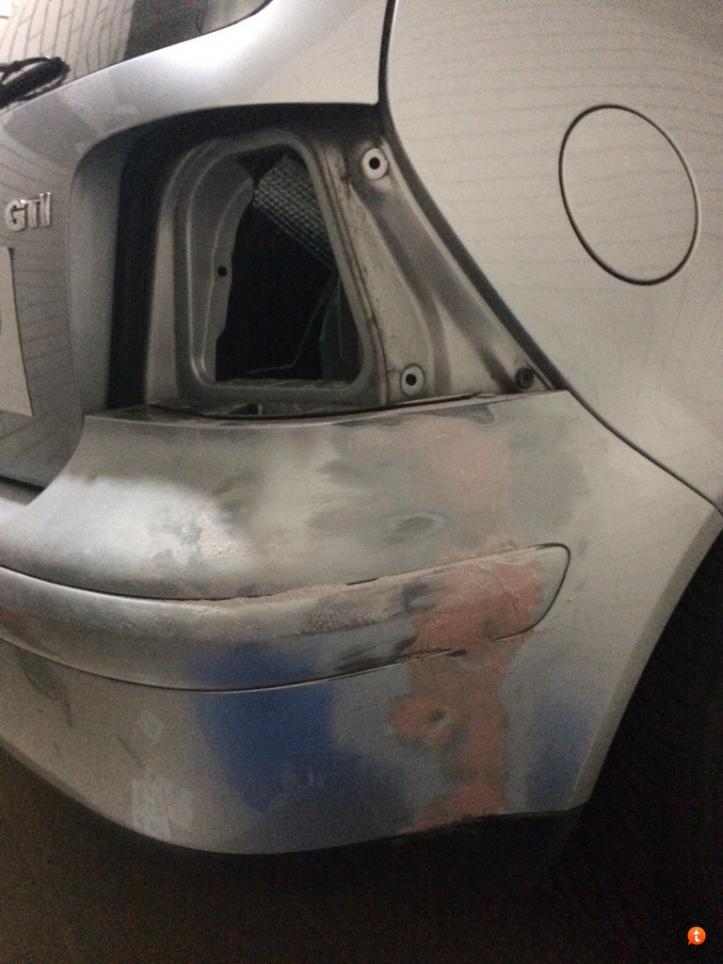

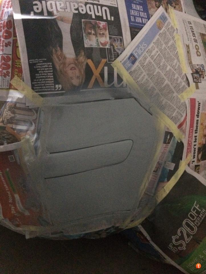

                    • Fixing up some scratches today.
