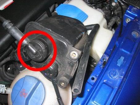

          It's not your waterpump is it? Assuming that this is my waterpump it sometimes makes a loud ticking noise and you can feel the top of it (circled) ticking away. However it would seem that yours is coming from elsewhere. Just a thought. Jimmy and/or Matt should be able to help you out pretty quick smart I would imagine.

            Trezza, I believe that has to do with your brakes, your water pump is located on the block and is linked in with your timing belt/chain

              that unit that is in between the coolant and window washer tanks is the activated charcoal filter which filters fuel vapor from your fuel tank and redirects it into the engine.

                Woo there we go. Learnt something knew today. Thanks for the knowledge.
                Either way it makes a nice loud ticking noise sometimes.

                  Thank Bentley's manual
                    Ev.

                          I have that ticking noise only when i park....when i give it revs...it just stops. But when its just sitting there idling...i can hear that tick...of the top of that box..that circled bit. I put my hand on it..and yer its ticking. Can someone email me as to what to do about it. Would appreciate it enormously.

                            It the activated charcoal filter control solenoid mate, you will here it most at idle, ticking on and off as it is meant to. It works in accordance with the ECU, and does a couple of things, it controls fuel vapours being released to the inlet manifold. Your ECU dictates the duty cycle of the solenoid, The 02 sensors give feedback to the ECU on how the mixture is going to keep it close to ideal mixture, lets say the engine is leaning a bit the ecu will run the solenoid for a bit and thats when you here it clicking you will notice its in line with the inlet manifold, when it clicks it lets the vac of the manifold suck in the vapours, this lets more fuel vapour into the inlet manifold. Dont worry about the clicking its totally normal.
                            When you park your engine heats up, when you rev the coolant pump is circulating the coolant more then the engine get marginally cooler, thats why you hear it then, its working perfectly
