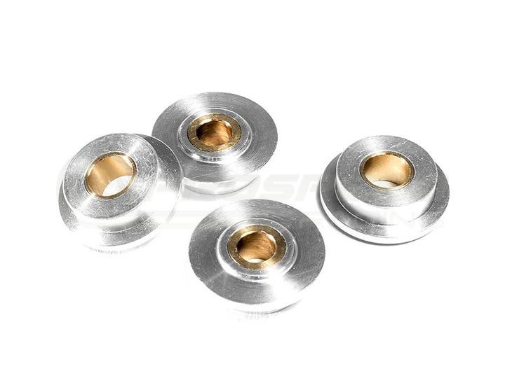

                  • #39
                    Originally posted by guile View Post
                    builds coming on well mate...
                    any pointers for fitting this please, I'll be installing one over Xmas break...
                    [ATTACH=CONFIG]53622[/ATTACH]
                    Thanks mate
                    It is pretty easy to install. The only thing I would check is if they have supplied you with all the hardware.
                    In my case they must have forgotten to supply the grub screws to set the shifter lockout but I had plenty of new bolts that resolved that issue. The most annoying part for me was setting up the shifter lockout -- I still haven't set it up properly but I will be fixing that very soon.
                    One thing I would recommend (which I did not do) is upgrade/replace the cable end bushings.
                    • #40
                      thanks for the tips, I'll check the hardware first thing...
                      I've already replaced the shifter bushings so that shouldn't be an issue...
