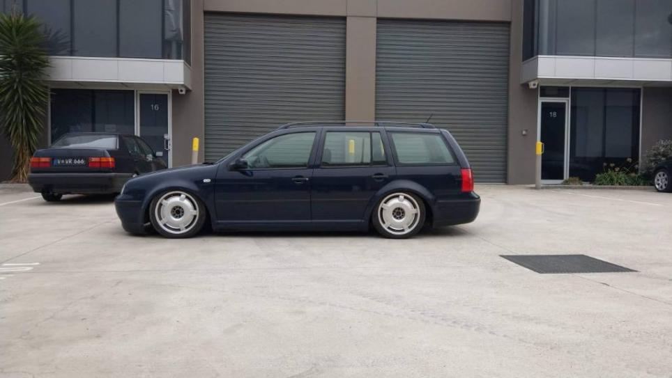

            Alignment done. Drives sooooo much better with fresh rubber (even if cheap stuff) and wheels pointing in the right direction

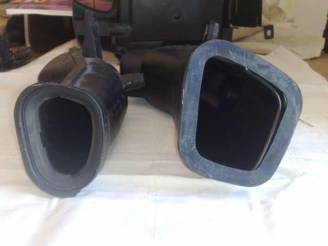

                      R32 airbox, maf and intake pipe sorted thanks to bug_racer. I'll give them a clean up and new air filter.
                      Now just need to order mk4 r32 dsg snorkel, clean and fit my pd150 intake and upgrade the race pipe to a bigger one. Intake side of the motor should be sorted.

                        Mmmm I've been eyeing off an r32 DSG airbox swap for a while. Darkside development sell them new but it's so expensive. I hope you got it for a great price.
                        • #72
                          Yeah that's what I was looking at.. Lots of dollars for prob not much more wow.
                          Think so. Do you know if there is a difference between the 32 Air box and the dsg one or is it all in the headlight cover and snorkel? I've not had much luck confirming this

                            The main difference is the snorkel size. Having the other parts just makes it look factory fresh, as it all snaps together as it should.
                            I think it would make a difference, especially paired with uprated oversized turbo intake pipe.

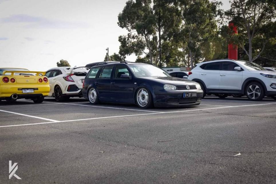

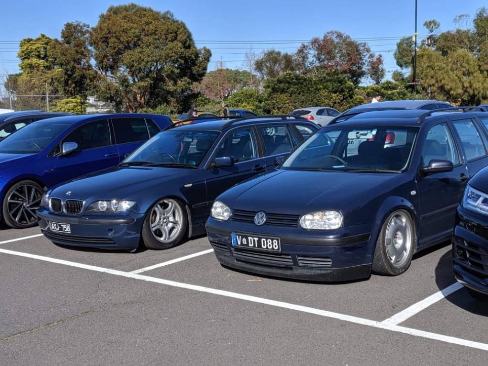

                              No progress for the wagon.
                              Went to check out black label invitational and somehow managed to park next to a bagged blue wagon also on stockies.
                              Mate also found these pics floating around on facebook. Should have washed it...

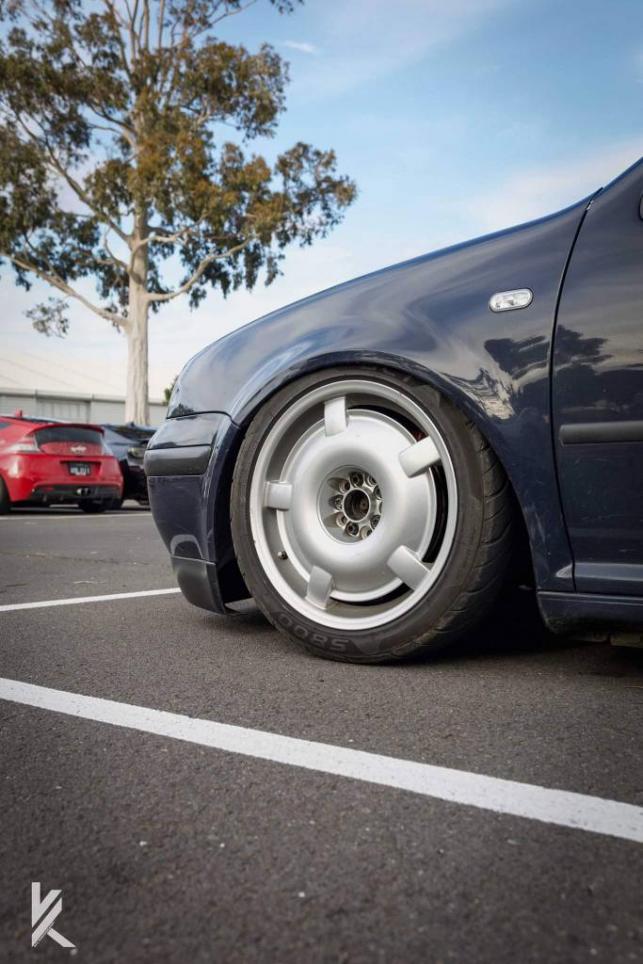

                                Stole madglf3s amazing projekt zwo wheels for GAD after a failed attempt to get my planned wheels on.
                                Drove from Melbourne to Canberra via Wagga, thrashed the car around the city, then drove back as far as yass before the fuel light came on.
                                5.7lt per 100lt on a 48l fill
