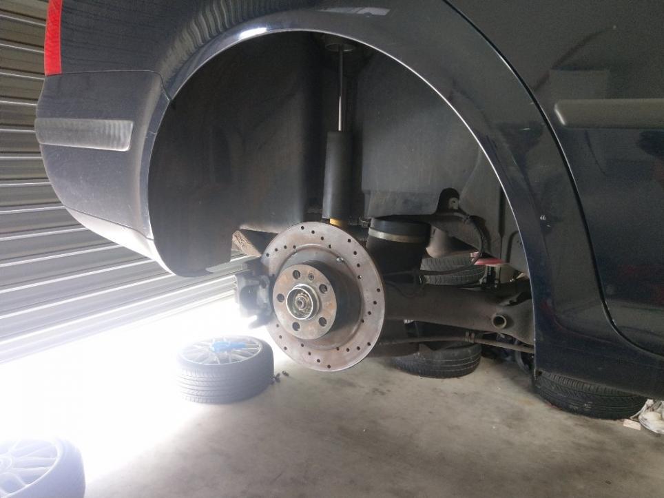

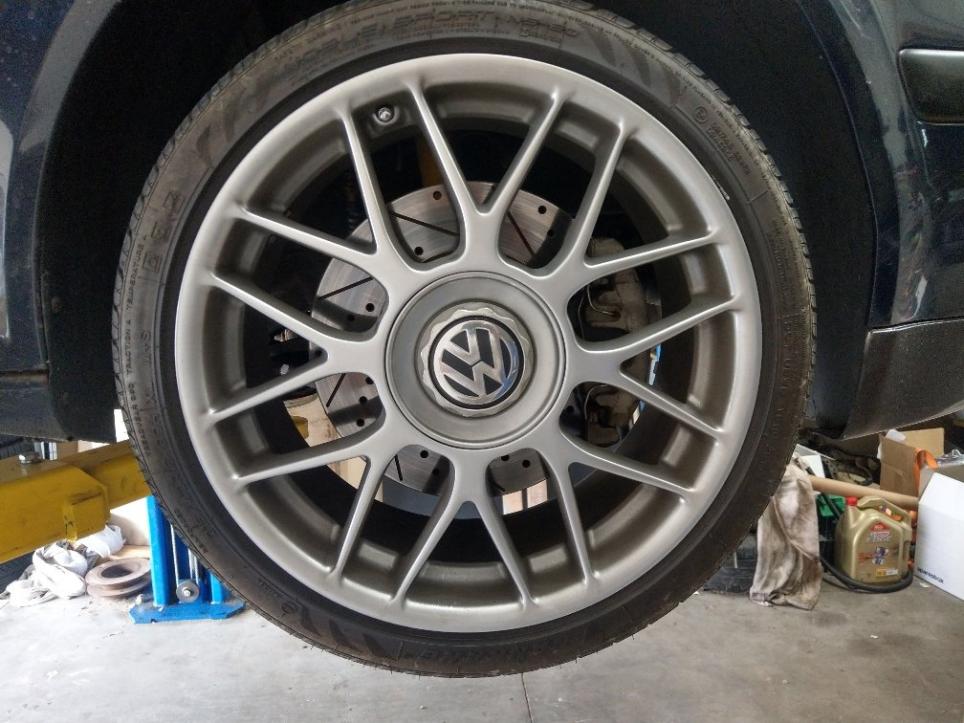

      • Fitted up the new rears along with some used but much fresher Bendix pads I had laying around.
        Had a fight with the passenger side stub axle, everything was rusted hard shut like the drivers side. So new wheel bearing and stub Axle from the bora went on.
        Didn't think about it until fitting but the disc offset on the 280mm rears makes them sit a long way back so dust shields had to go.
        Ordered a genuine passenger front door lock/ mechanism so fingers crossed that sorts my non functioning lock and all should be sweet for the first time since owning the car
        Photos:

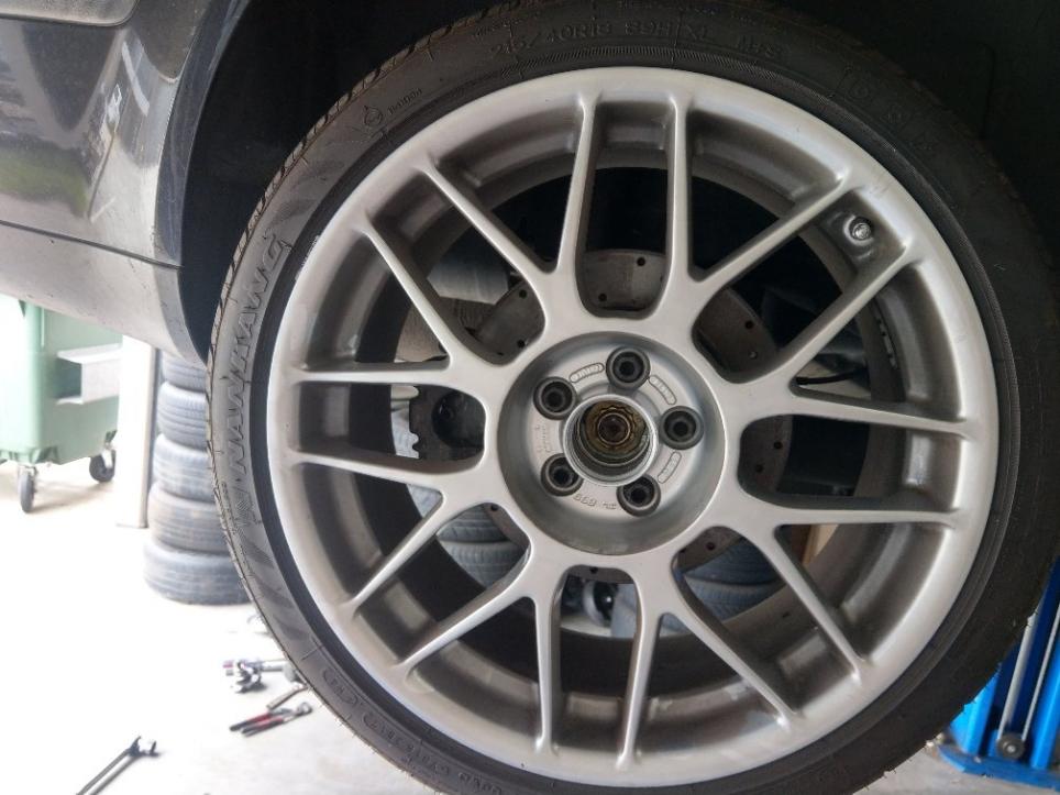

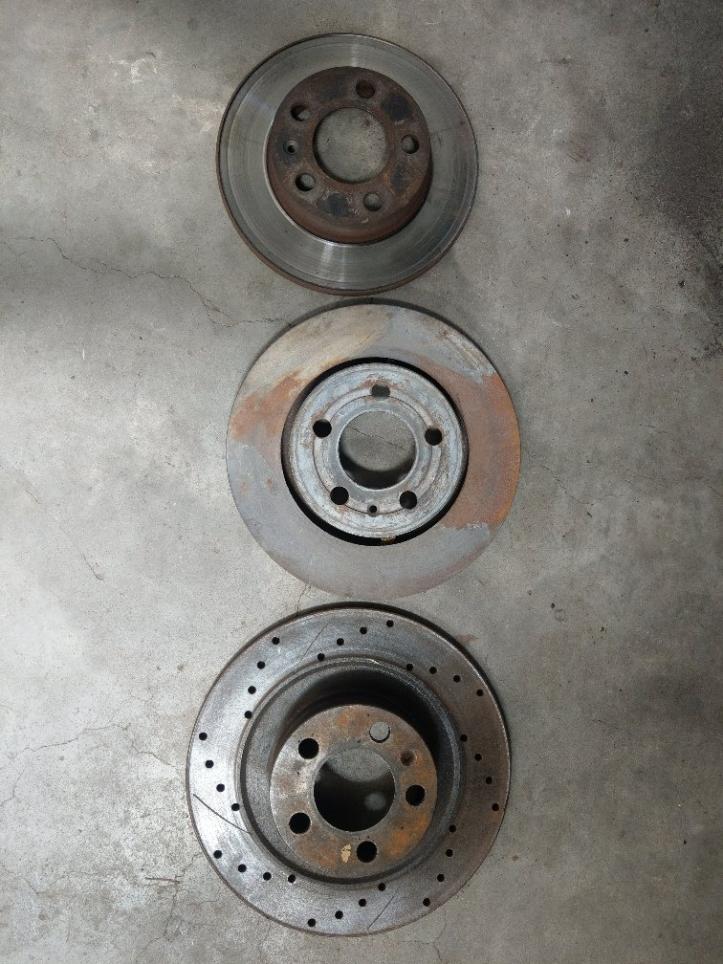

        232 solid vs 256 vented vs 280 solid
        On the car
        Wheel with no cap the 280mm rear, wheel with cap 312mm front

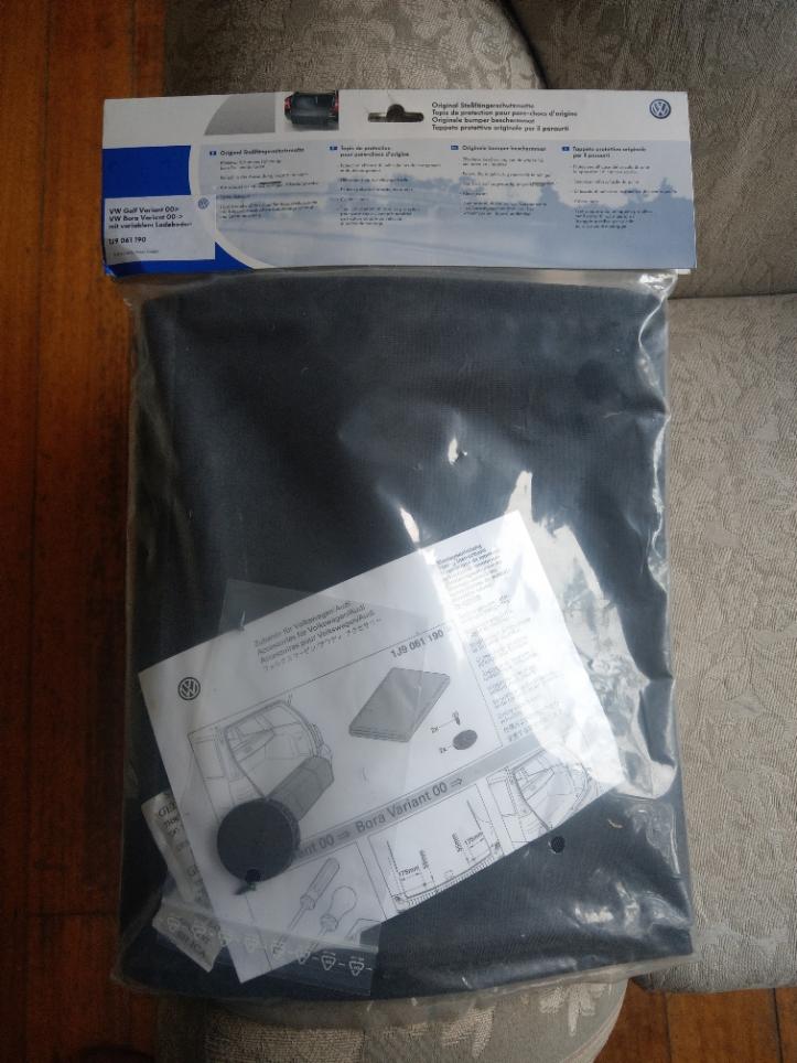

          Finally received this in the mail after orginally being sent the wrong item.
          NOS fold out liner that protects the rear bumper from scratches etc. Not something I plan on using often but will come in handy.

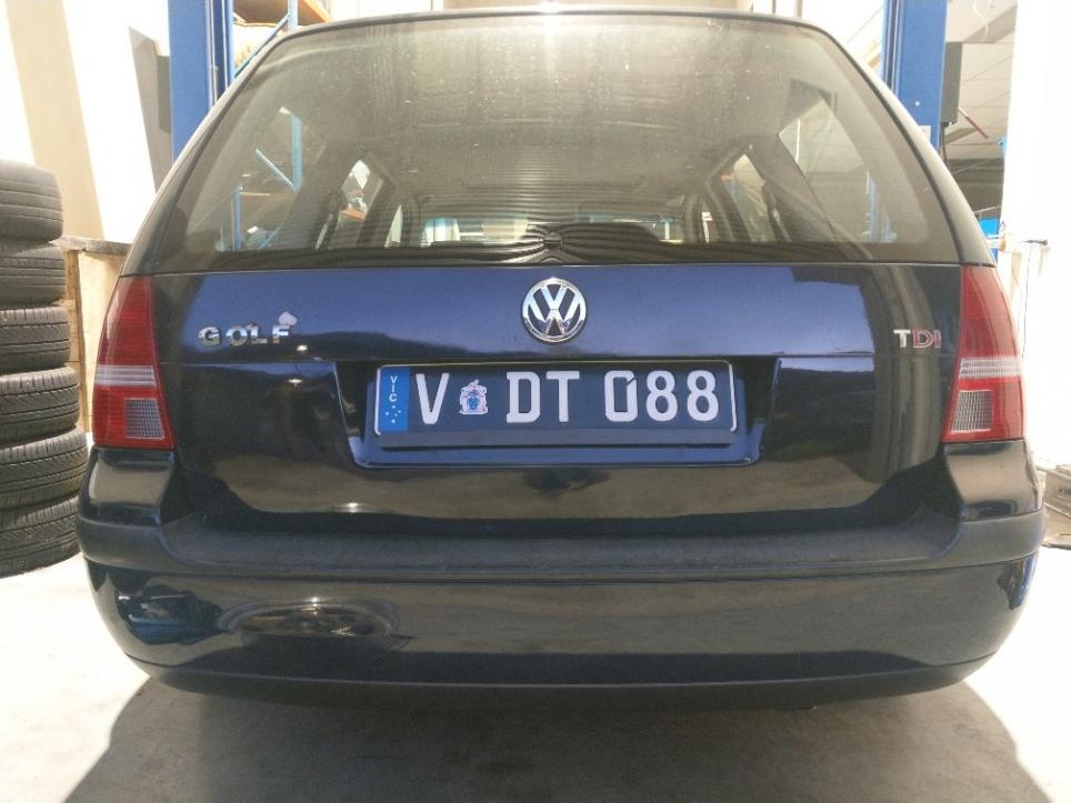

          • Not much to update
            Tail light upgrade.
            Orange to oem clears. Need to play with the alignment a bit

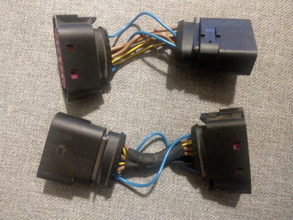

                        • I hate wiring, but also not being able to adjust the xenons headlight angle was a little annoying on the bora. Added wires to the adapter so it work with the factory switch rather than install the sensors. Thanks to Graeme for the help chasing oem wiring, plugs and grommets
