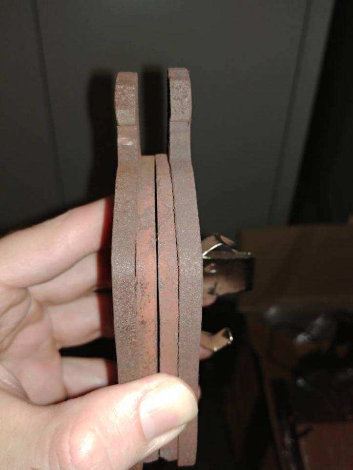

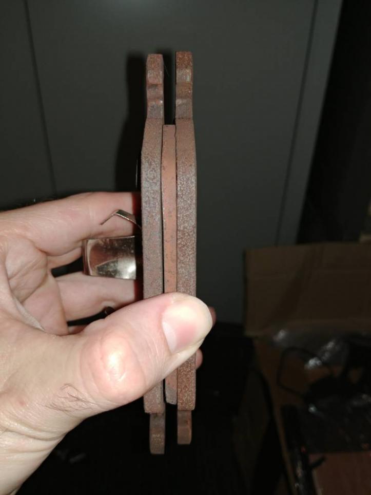

    Hey guys,
    I completely removed the front brake pads from the Gti tonight and I noticed that one side was experiencing normal wear, while the other side is just horrificly uneven.
    I have always experienced a slight squeaking/rubbing noise from the extremely worn pads from install.
    I don't think it's merely a slides lubrication problem, I am thinking the caliper is sticking.
    Do people rebuild mk4 calipers or do they just buy new one's?
    Any other advice is recommended, thanks.

      Yeh I know, after reading that I was fairly confident about the problem because The rubber bushes were run for the last 5 years, and I only installed the tyrolsport stiffening kit within the last year.
      So when I pulled out the front left, I was in disbelief to see the pads so even and in great condition.
      I spoke with Greg from brakes direct he said it would be a slides lubrication problem. So I guess I will just buy some decent lube.... My current caliper lube dried out fairly quickly. But apparently there is for extreme lube for metal on metal situations, so I'll buy some of that.
      I find it hard to believe that one caliper was better lubricated than the other. They both got the same amount of treatment..
      I have had the discs machined and I have new brake pads, so I'll report back in a few months.
      In regards to the stiffening kit, I didn't really notice any difference between the original rubber and the tyrolsport kit. I certainly didn't hop in the car and go wow! The original rubber must be phenomenal thou because it was in great condition considering the heat they have been subjected to for the last 16 years.

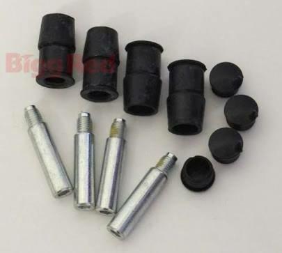

        Have you checked the seals for the slides? Strange one side would dry out more than the other.
        2004 VW Bora 4motion | 3.2 Swapped - R32 Trimmings | BBS CH | Forever fixing this bitch
          There really isn't any seals as such. Just the slide bushing and the end cap. Both were in decent condition when removed. One side didn't seem lubricated any more than the other.
