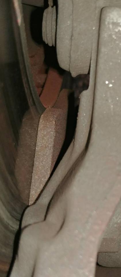

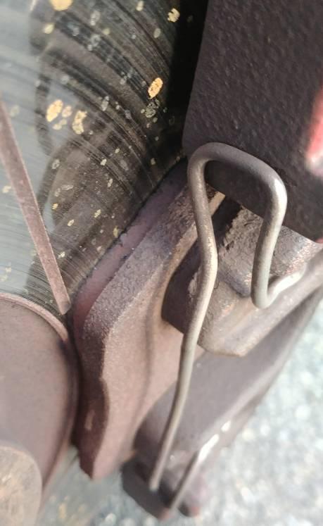

    I used this technique today. I found my spline kit, hammered it on and it held really well while turning the lock nut off. Thank you for the advice.
    The outside pad has plenty left, but the inside pad had nothing left!!! This explains the insane metal on metal noise haha.
    Do brake pads wear evenly?
    Is one brake Pad subjected to greater forces than the other? ....maybe under the intense track conditions they just disintegrated because of cracking etc?

      You might want to have a close look at those discs on the inside.
      If they can't be machined, you might have to bin them.
      With regards to the uneven wear, it's probably due to the slide bolds not being lubricated, as well as where the pads contact the caliper and it's bracket.
