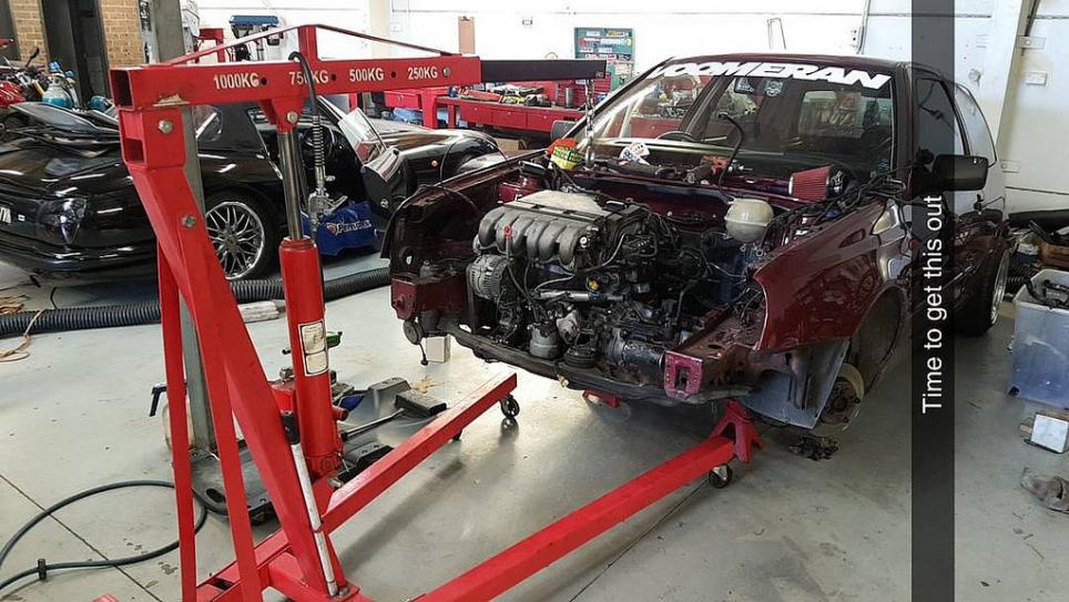

    Nick and James had recently bought a mk3 cl and done a vr6 manual swap on it and i thought id grab it off them for a good price

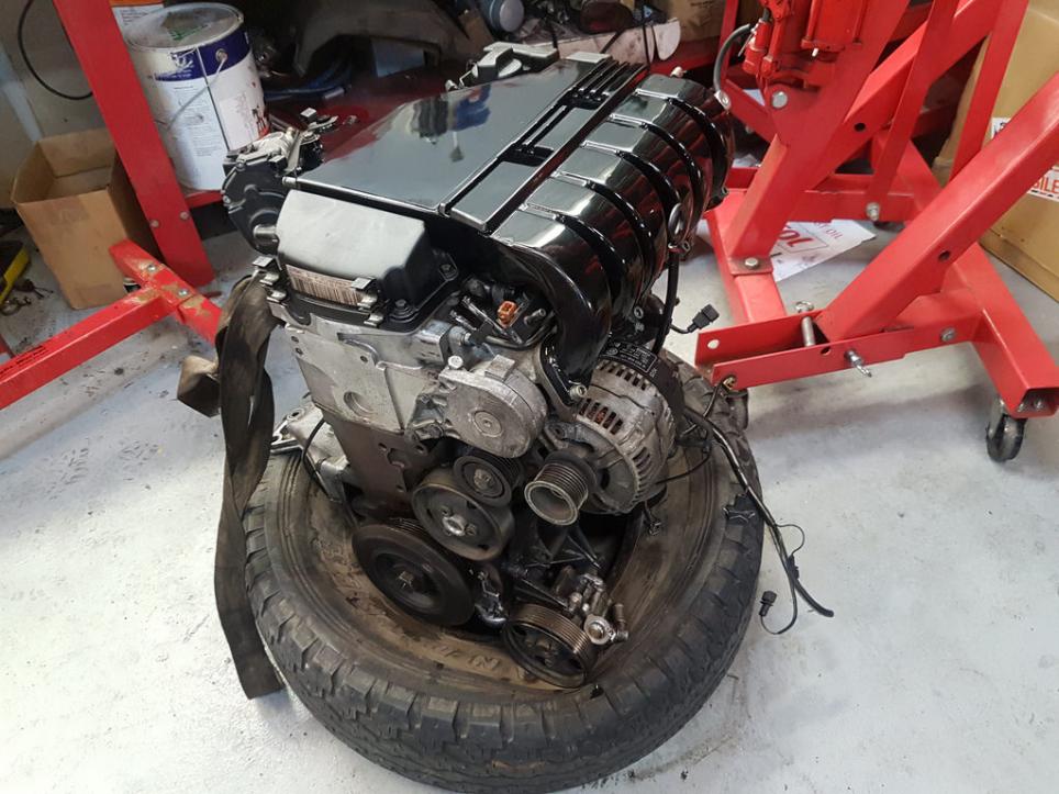

    Engine

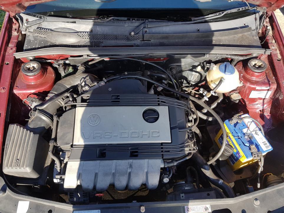

    - AAA - 12v VR6 / recently Rebuilt
    - VR6 5speed box

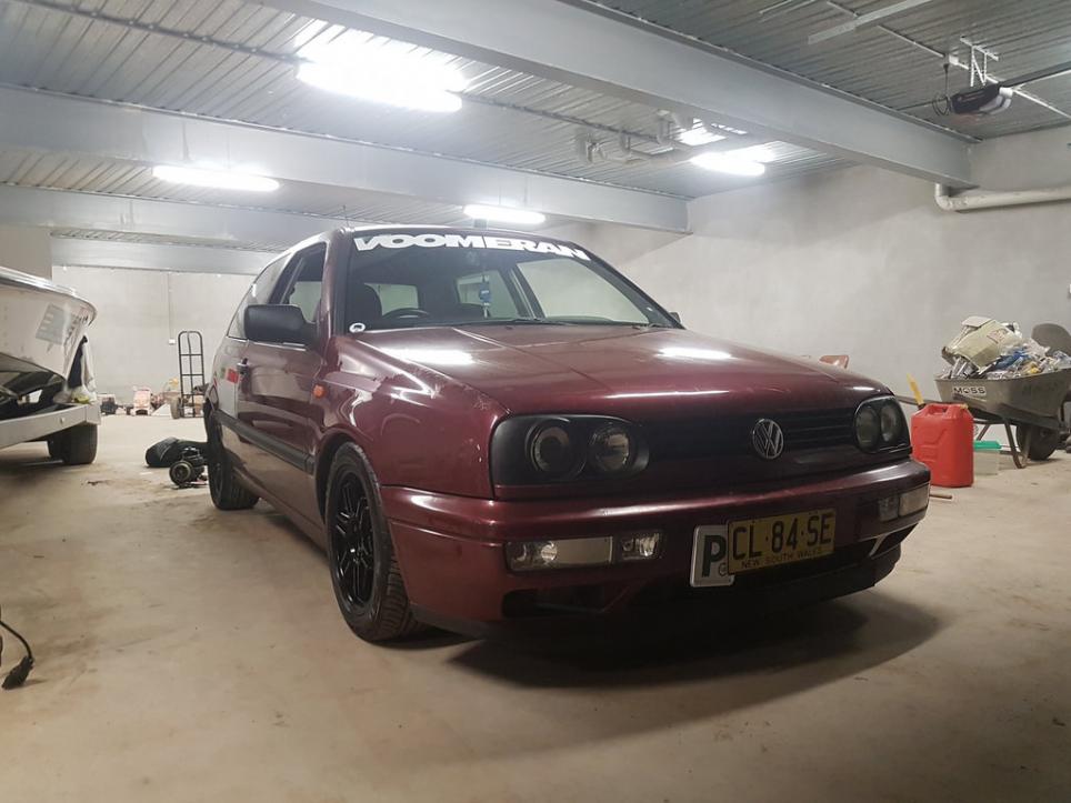

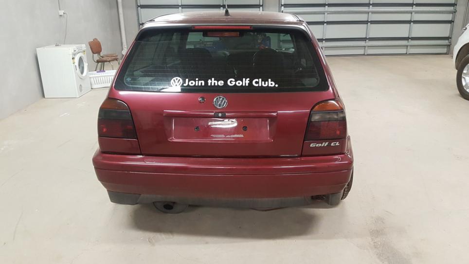

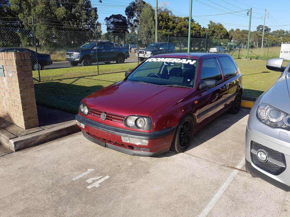

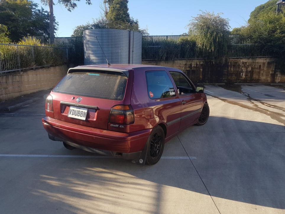

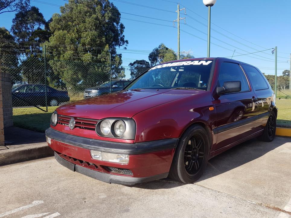

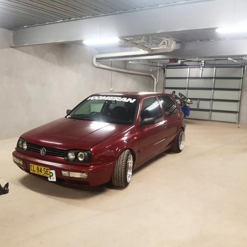

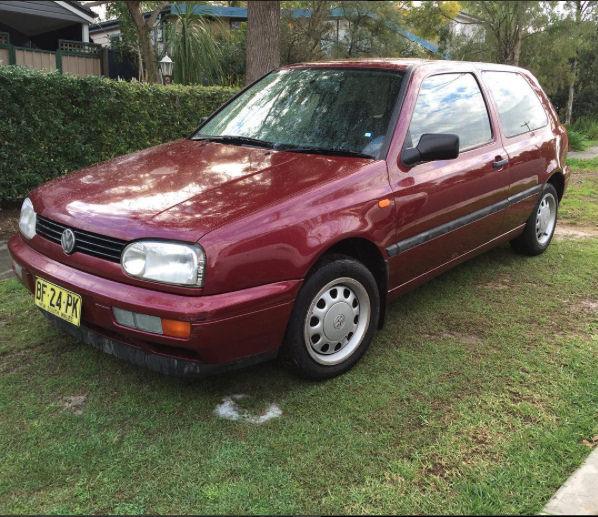

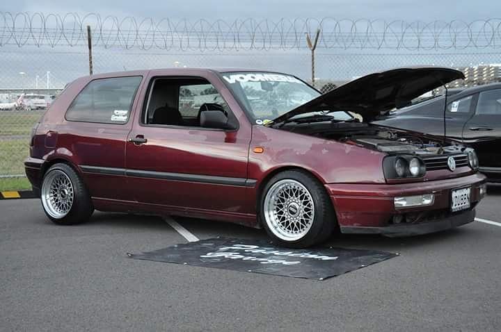

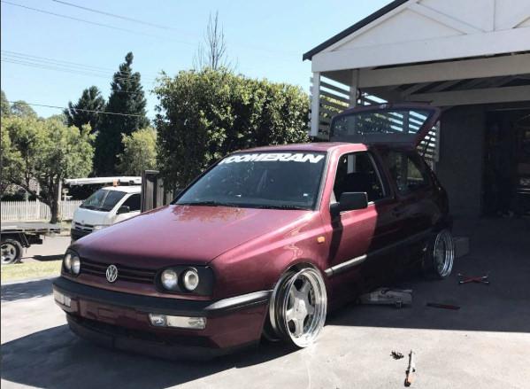

    When James first bought it
    How it sits today

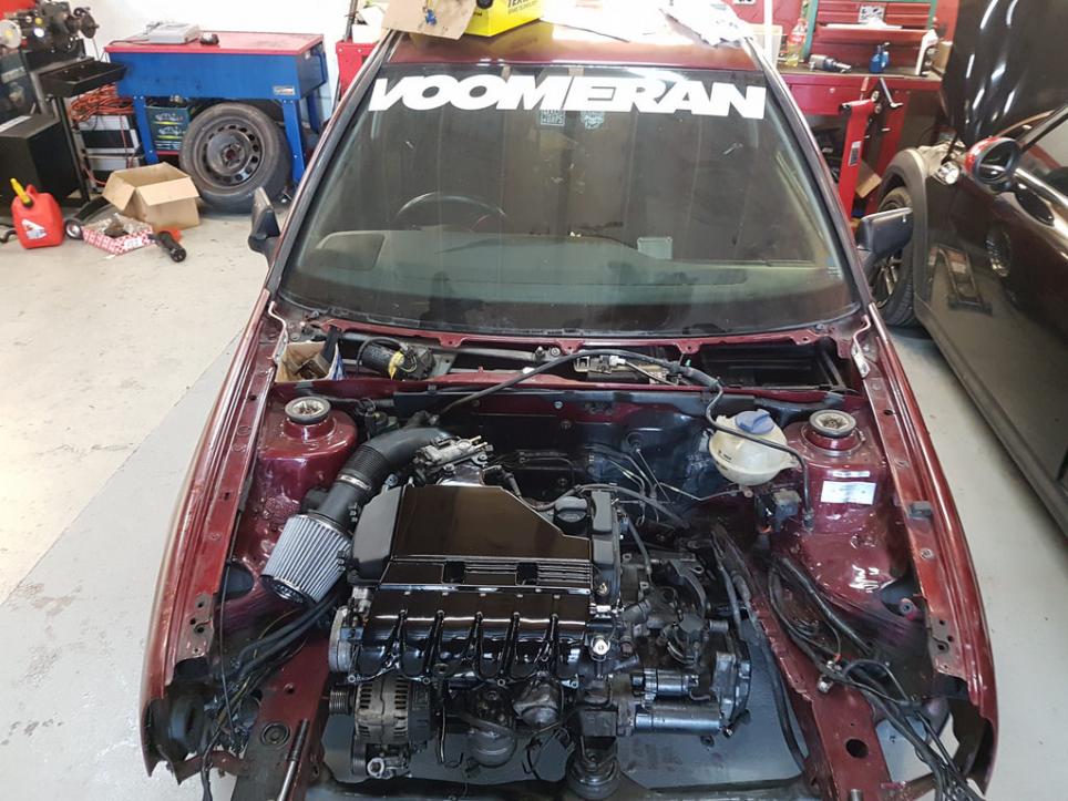

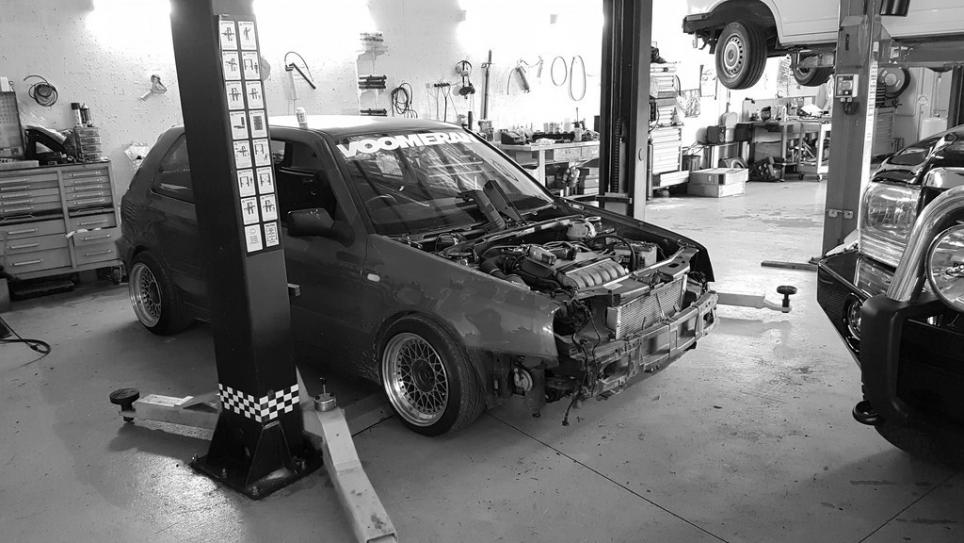

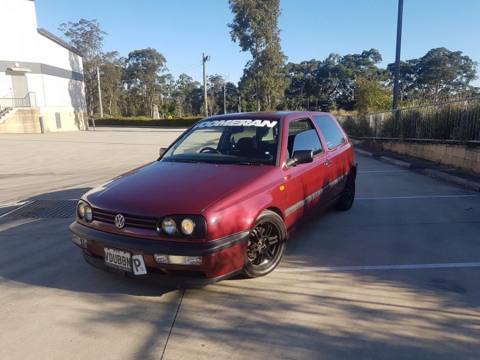

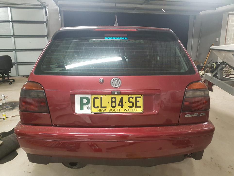

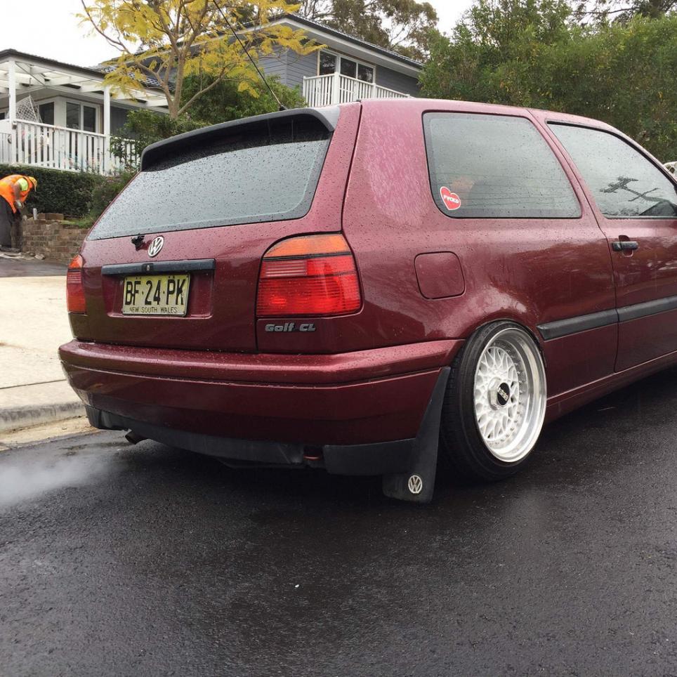

                        then after Vits i decided to change over the bumpers and wing and few other trim bits as well, i polished up the good side of the car as best as possible and tried repairing the outer door trims back to black as well but i ended up pulling them off
                        anyways Fitted Friday came around ( farking terrible ) so good ol raymond let me borrow some wheels for the event i ended up liking them so much i bought them off him with his help and now i have a set of BBS RM001's in original 4x100

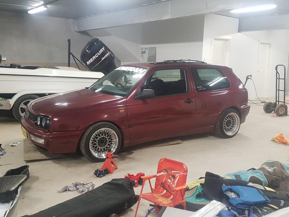

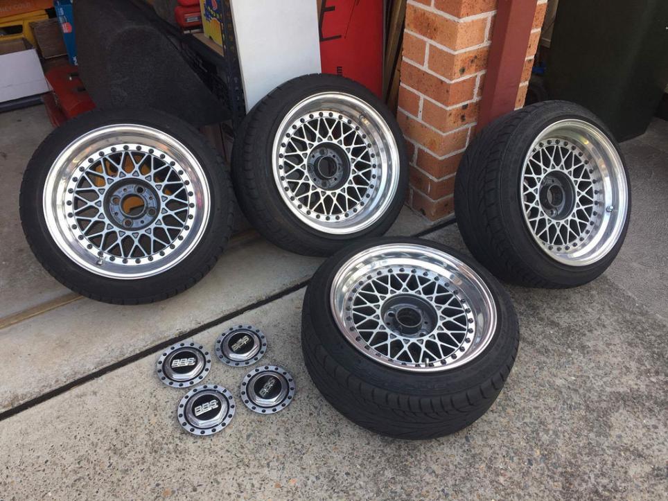

                        but before then the boys test fitted nicks RS's on the golf and it looked awesome !!!

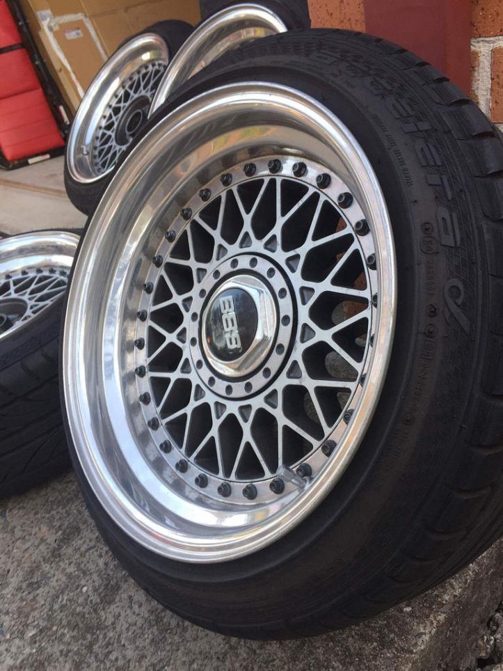

                        Specs follow - BBS RM001 4x100 15x8.5" +0 on the fronts and 15x9"-6 on the rears, so they poke a bit but nothing that cant be fixed some rear camber shims and front camber plates
                        i got sick of looking at the **** side trims so then i pulled them off and i plan on either painting them to the same colour as the car or just redoing them in gloss black

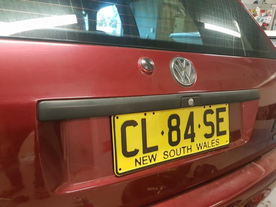

                          i also picked up a genuine heckeblnde, which really looks awesome and blends really well with the vr6 tails and the colour of the car

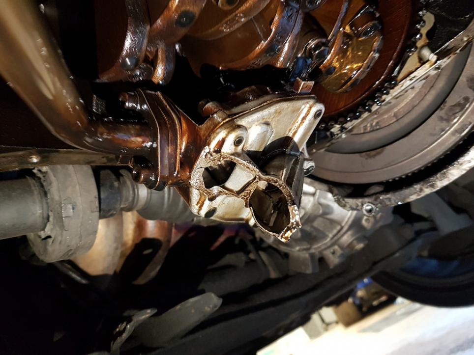

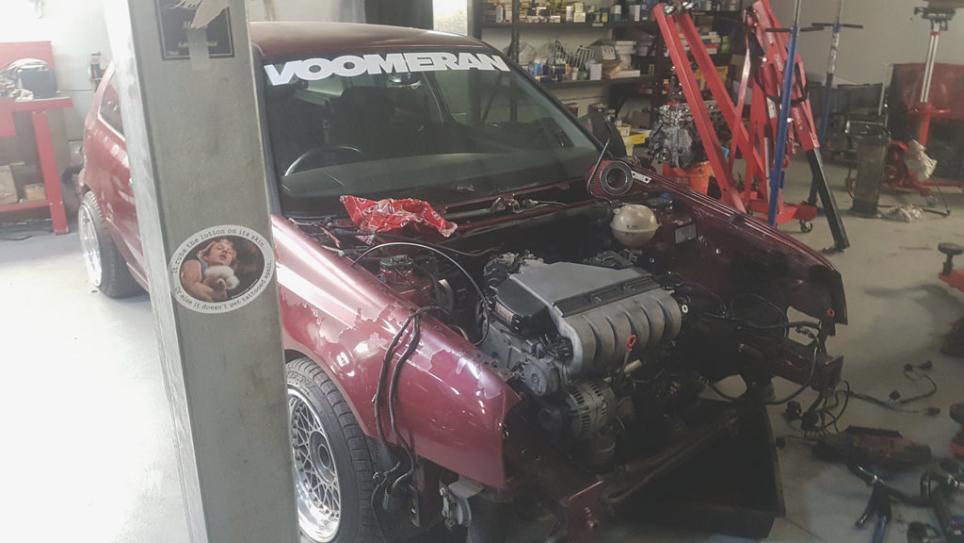

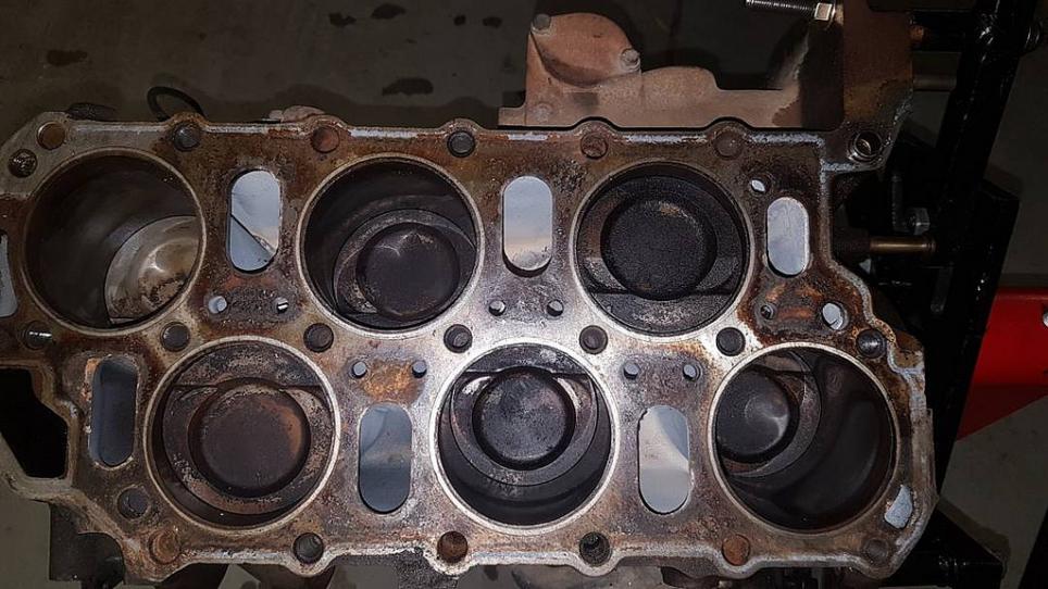

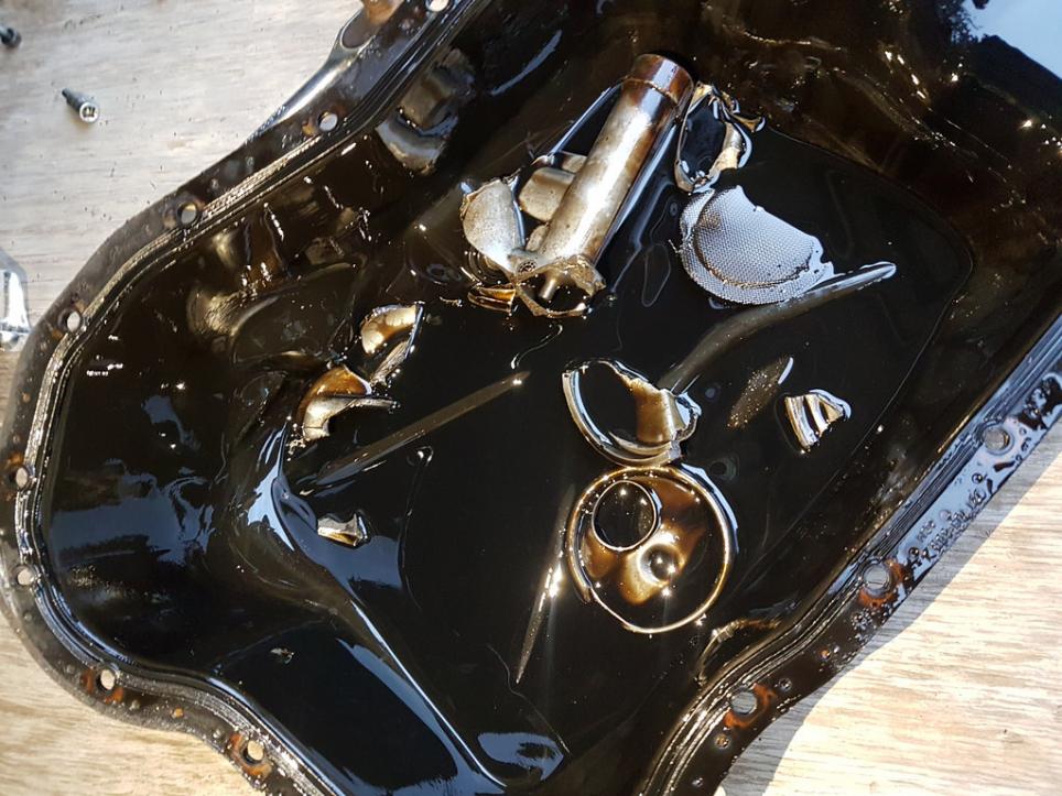

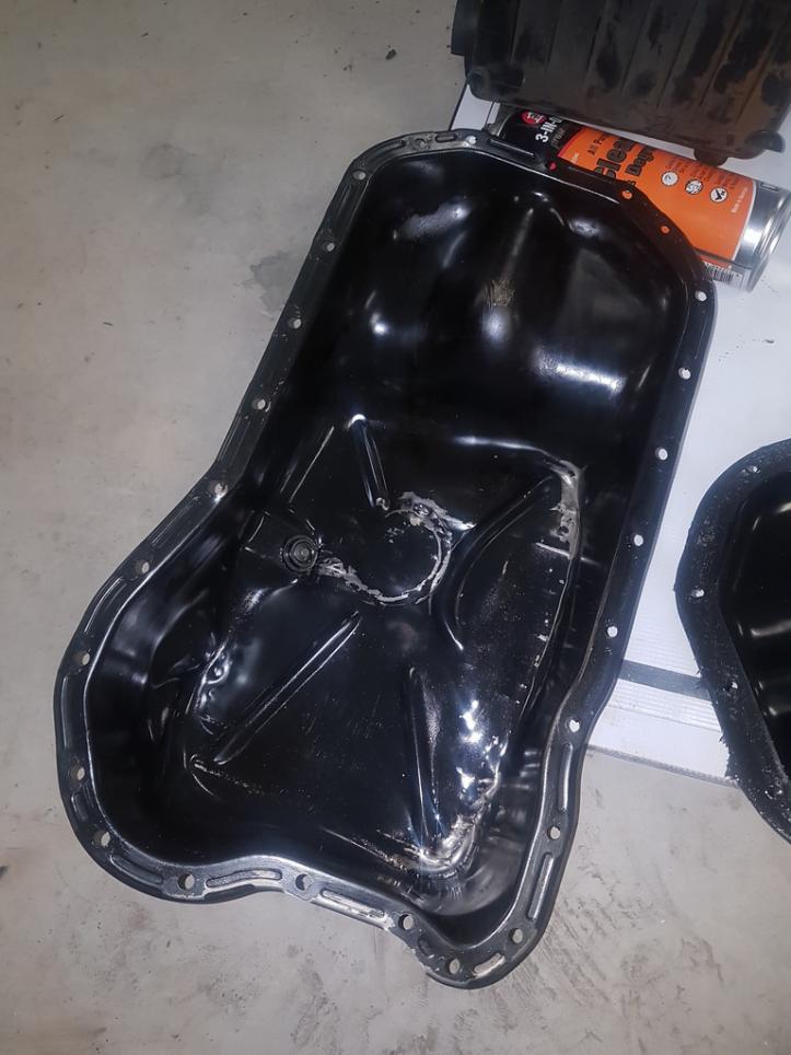

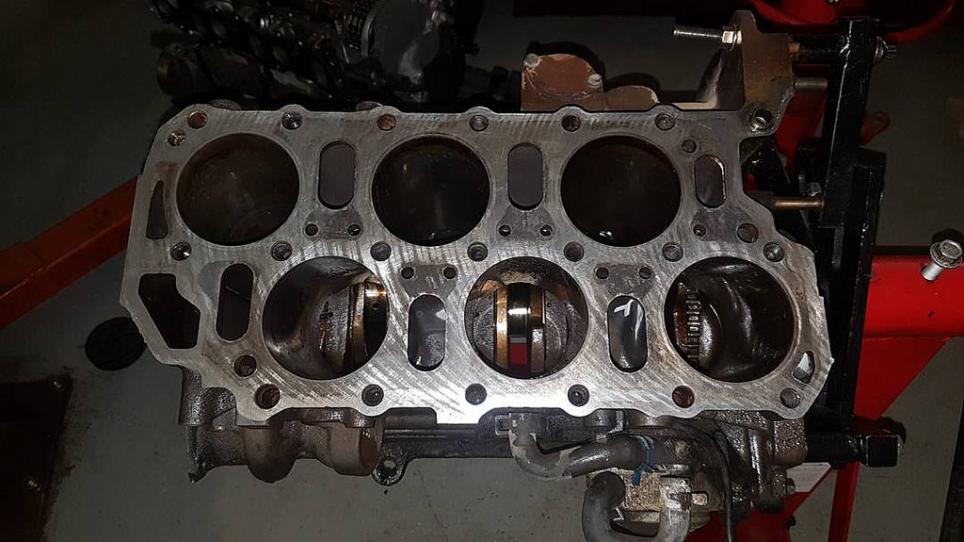

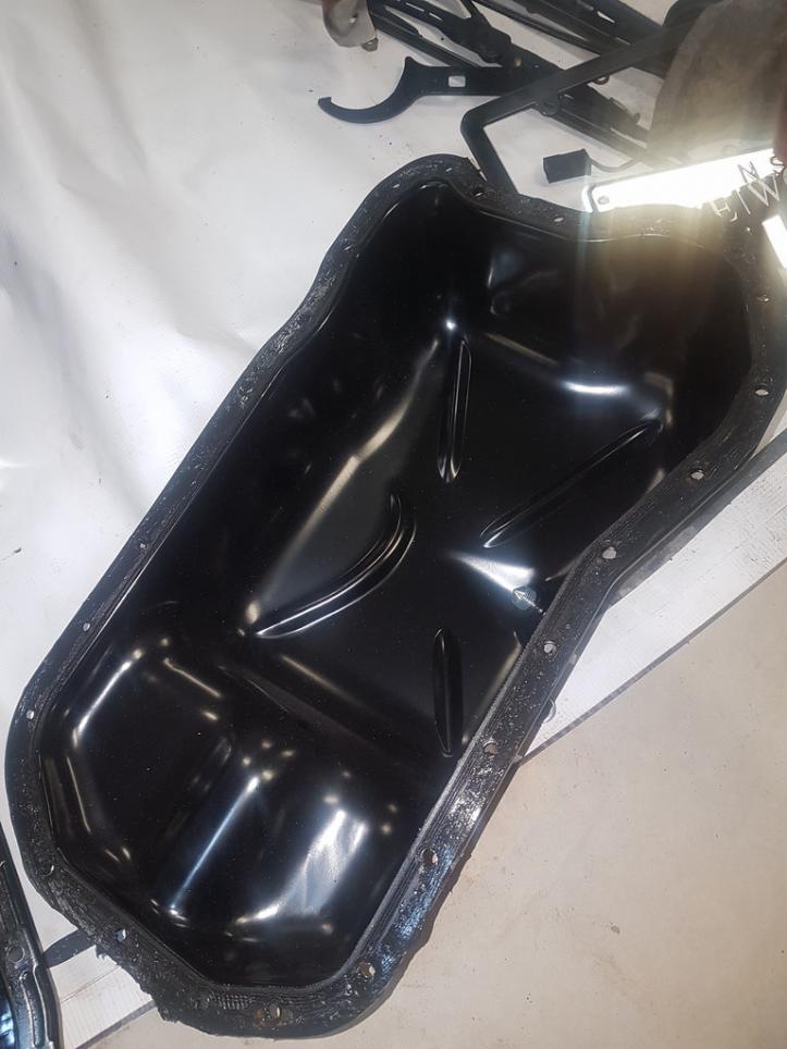

                          but then one saturday arvo I'm leaving work and driving a bit too fast someone pulls out infront of me and i serve and hit a nice big hole in the road and slam the car into the ground
                          then my oil pressure light comes on and then my motor goes boom....
                          as you can see the sump never cracked it just pushed up so far that it bent and shattered the oil pick up !!
                          so i put a new sump and oil pick up on for testing purposes
                          So life goes on i ended up putting a deposit down for the voomeran kit which includes flares, wing and front lip
                          but still haven't gotten around to paying the rest of it so it can be shipped

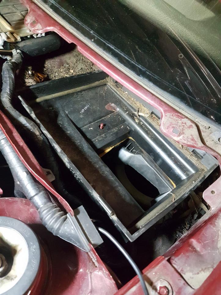

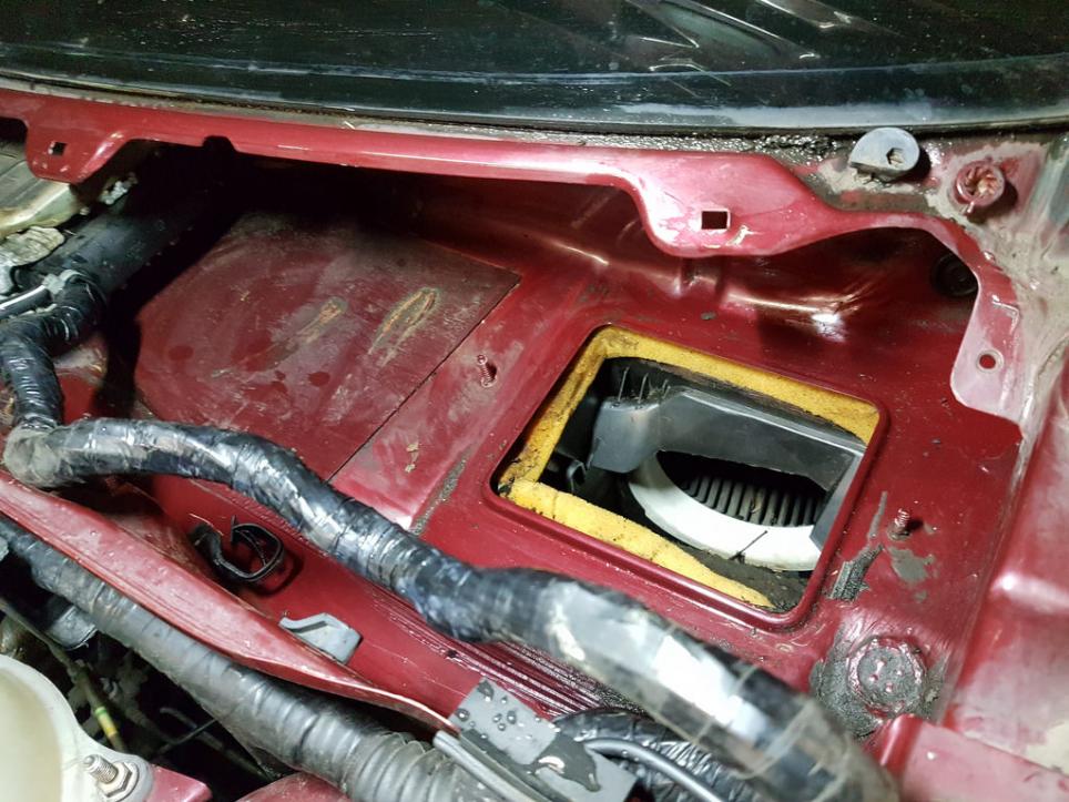

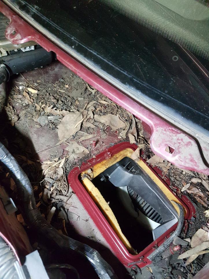

                          i also cleaned out the rain tray and that whilst the car wasn't going anywhere anytime soon haha and in goes a new scented cabin filter, lol even tho i don't have aircon !!

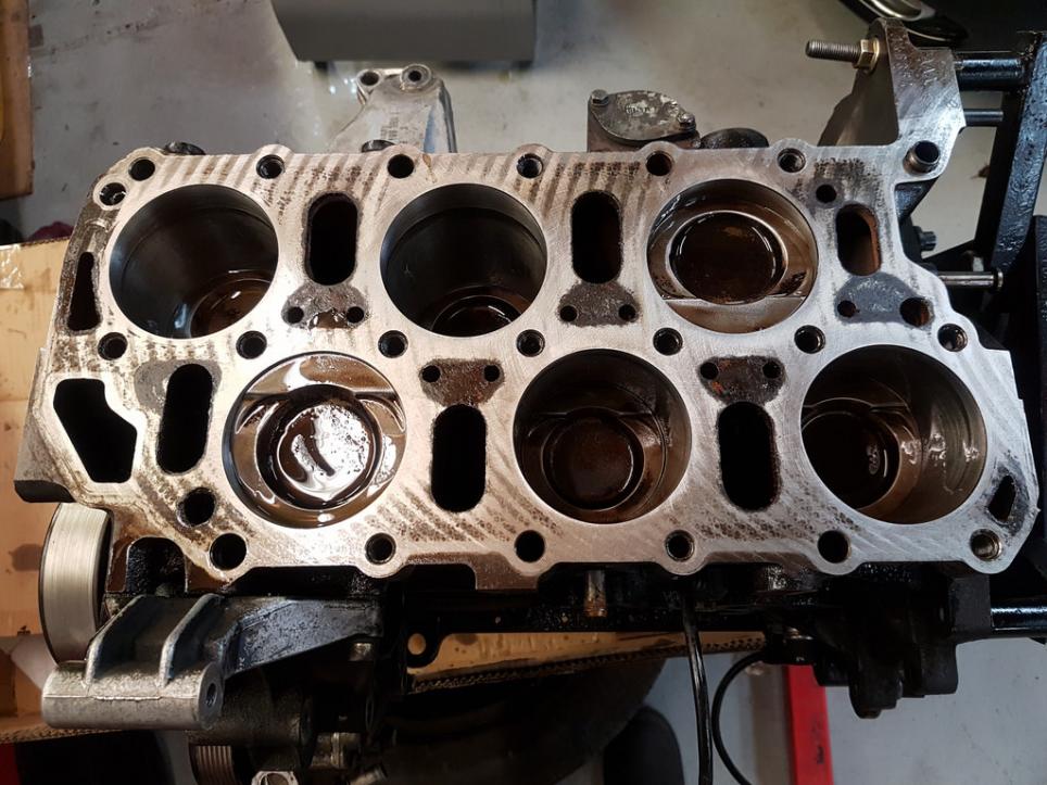

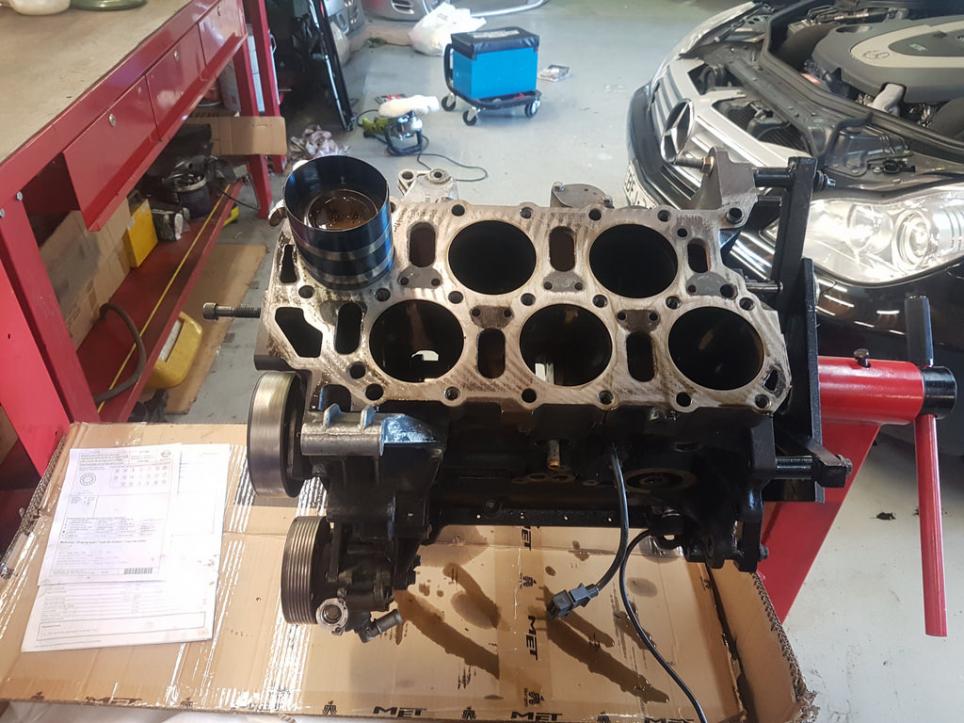

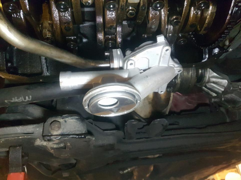

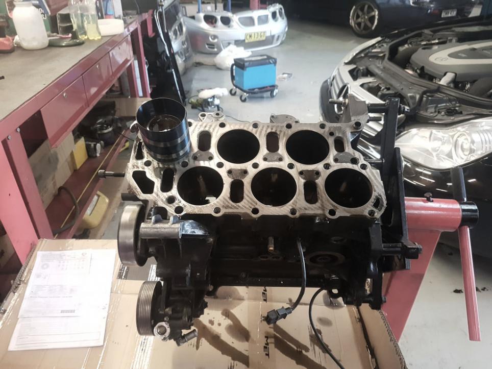

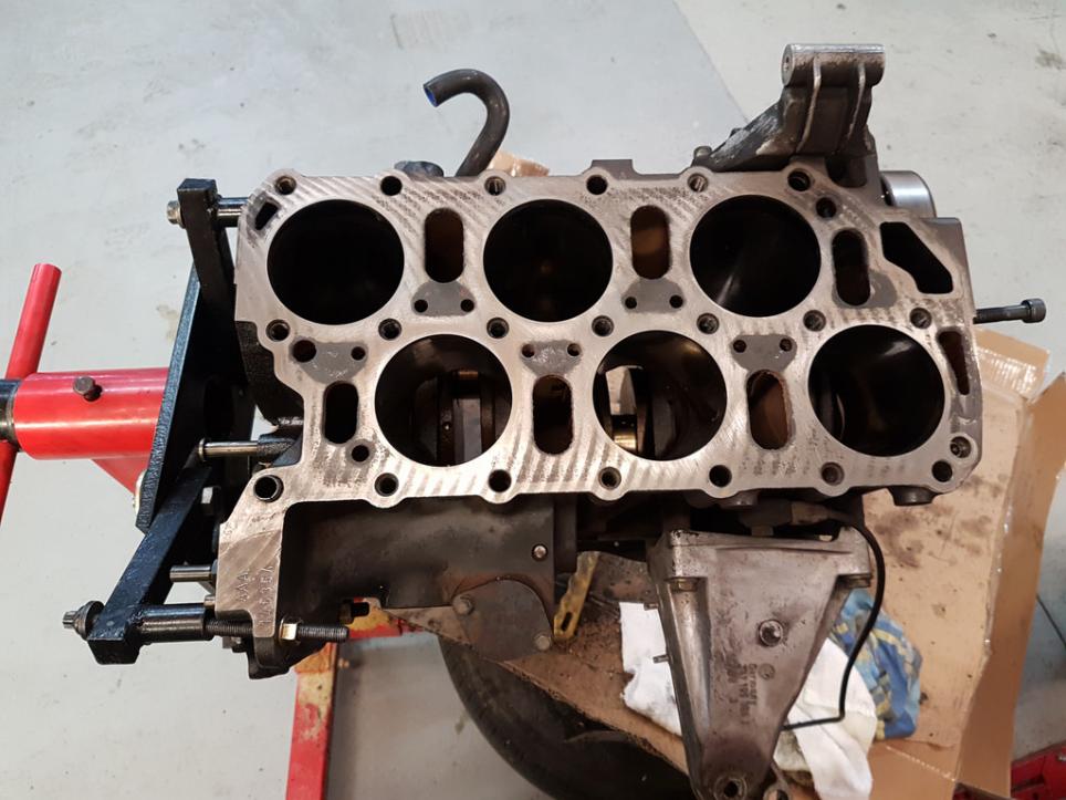

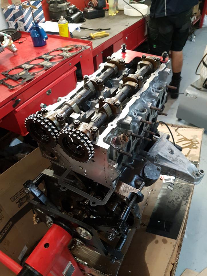

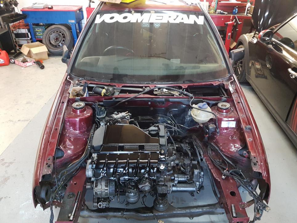

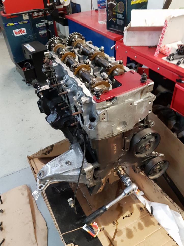

                            so after replacing the oil pick up and realising the bearings are defiantly gone i strip the motor and find that my bearings were completley cooked
                            so i started to rebuild the motor
                            lots of time and money
                            and i rebuilt it all my hand all by myself ( perks of being a mechanic I'm able to use my skills haha ) it was my first ever motor build so I'm pretty proud for how it turned out
                            and it runs as well haha runs really well !!
                            so I'm back to work on the 15th of jan and ill be able to finish off a few things then VDUBBN.3 will be back on the road
                            So during the motor build
                            i got a spare block and head off stu
                            i ended up using the crank from the spare block and all the pistons from the spare block as well
                            all new piston rings
                            all new main bearings
                            all new big end bearings
                            all the new main cap bolts
                            all new Piston cap bolts
                            all new headbolts
                            I stayed with the standard mk3 head gasket as i was getting pinging with the mk4 one installed originally
                            brand new water pump
                            brand new oil pump
                            Brand new timing chains and guides
                            lots of other stuff I'm sure I'm forgetting
                            and so after all of that i was able to turn the key and she runs !!
                            so not long now til I'm ripping around in it again

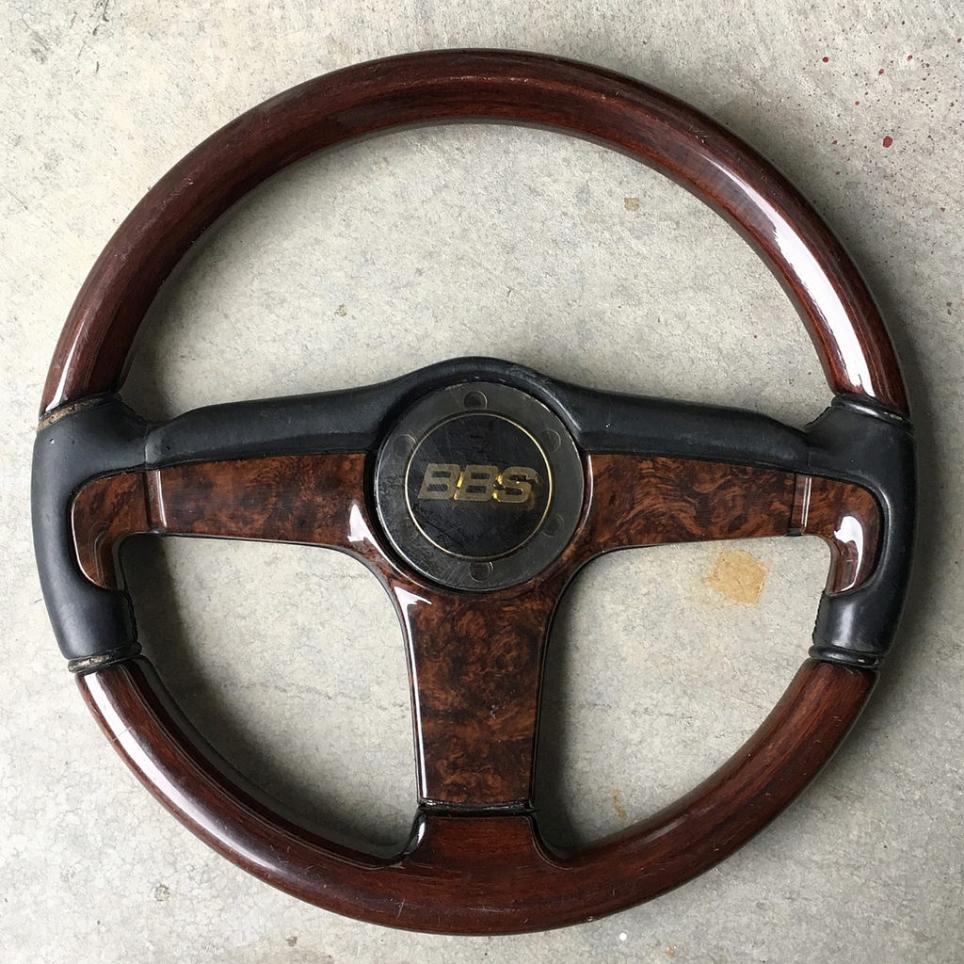

                              i also was able to pick myself up a very very nice BBS Steering wheel for the low price of $450 haha and a boss kit off ray again ( bloody legend )
                              the BBS should be able make the interior look a bit nicer as well and will replace my bora steering wheel
