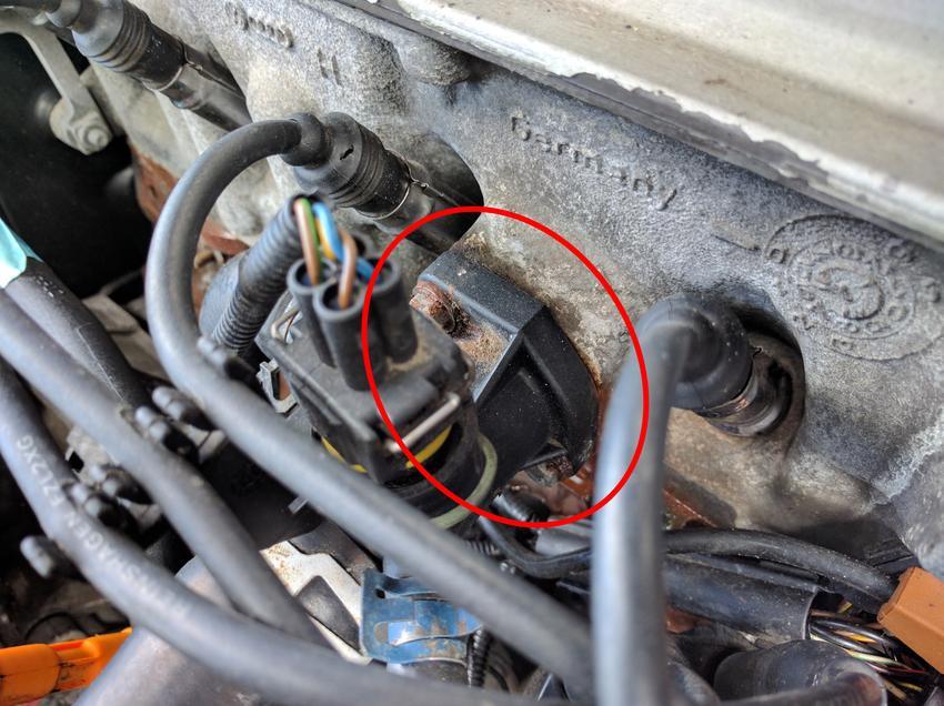

                I have a little bit of coolant dribbling out from this point:
                I'm planning on doing a coolant flush when I can pick up some G12+ (that's still the right coolant?) but besides from tightening the seal down, is there anything I can do to create a better seal? e.g. Clean the rubber and metal contact with anything particular etc.
                  I generally find it is necessary to replace the complete black plastic flange and seal to stop the leaking.
                  1994-1996 use G11 coolant (blue-green in colour) while the 1997 onwards uses G12/G12+/G13 (pink/pink/purple) coolant. I understand G11 and G12 should never ever be mixed - you will end up with a brown sludge in your cooling system. I understand that G12, G12+ and G13 are all compatible with each other. I have had my 96 Vento flushed completely and filled with G12+ so that all four of my VWs run G12/G12+/G13 to simplify my logistics.
