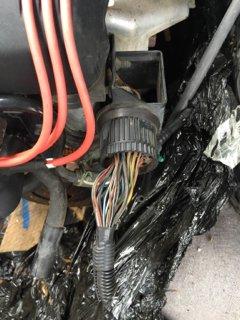

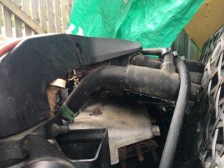

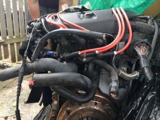

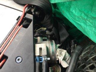

    Hey guys. Hoping to gain some some knowledge here. Can anyone let me know what vr6 engine this is?
    I hope the photos help! Cheers guys!

    What are you specifically asking for? It is a 2.8 , I don't know if I'm right but it looks like mine and mine is a 98 model
    Sent from my HTC 2PST1 using Tapatalk
      Meaning it may be a series 2 VR
        Not very helpful photos but it looks like AAA code 12V VR6 that was in the VR6 Golf but also and I stand corrected in some Caravelles.

          Im pretty sure all Aus delivered VR6 engines were AAA .
          Looks like a 94/95 engine judging by the throttle body . Does it come with an airbox ? If its an OBD imported engine its going to have SAI and EGR
          Bug_racer supports the rebellion of the euro revolution
            Just trying to figure out if it's the OBD1 or OBD2 vr6 I've been assured it's the AAA code but apparently there's two different kinds?
            No idea what you mean by SAI or EGR haha. Sort of just getting into mechanical side of cars..

              On the left side of the engine next to two hoses there is a sticker with a serial number, will tell you what kind of engine it is. Even what number VR6 engine that was produced from factory, they followed a sequential order.
              Past - '95 VW Golf MK3 VR6
                Damn. I tried to take as many photos as I can whilst I was up there. It's packed away at a friends house roughly 1 hour drive away. Didn't even think to look at the sticker haha! Just need to try to find out to get an engine loom and ecu for a conversion I'm doing into a MK1

                  Secondary Air Injection and Exhaust gas recirculation
                    You have an obd1/early motor engine. The only difference in aussie motors is the throttle body and intake manifold
                      But you have a different engine loom that's correct? As I need to get one to help convert the 1.6l 4cyl in my mk1 into the 2.8l vr6
