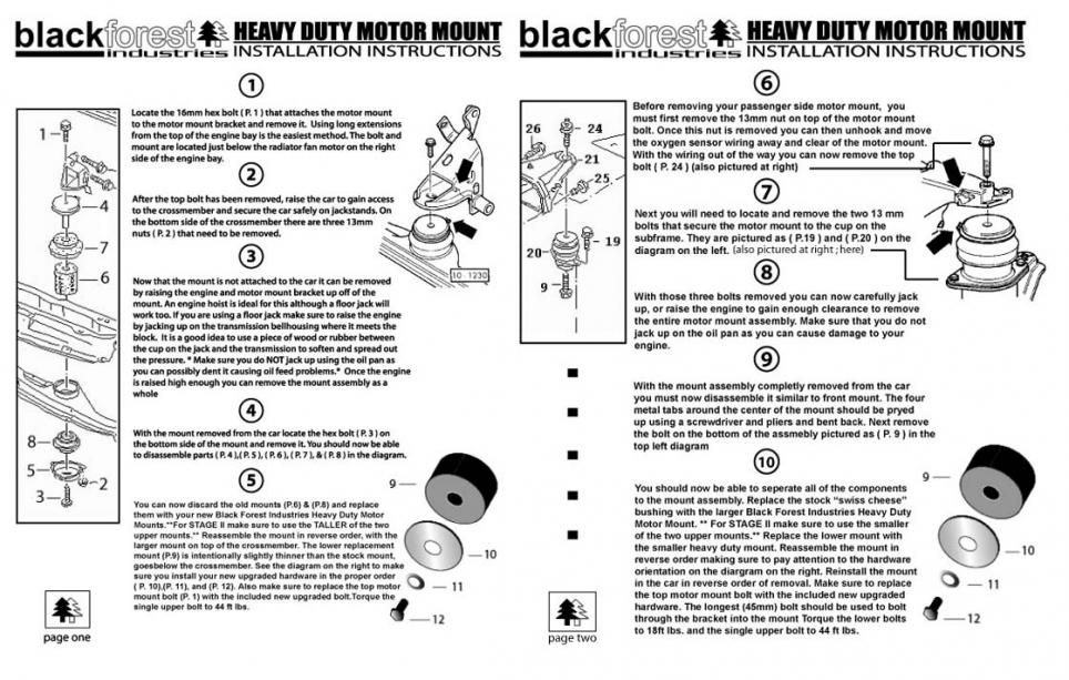

So, Tim is bringing me some stage 1 engine mounts on friday, and seeing as I have a shocking engine mount problem at the moment (you really don't want to know) they'll be put in ASAP! I've got to juggle the possibility of seeing you lot over the weekend, having my gf's birthday dinner+party+another dinner AND try and do engine mounts...cos I'm working full time now.

You don't wanna know about my engine clunks lol...you seriously don't wanna know about my front mount which apparently is too good for a top bolt.Originally posted by JoeVRYeah the gearbox one went in fine... the old one moved like an old video game joystick so it copt a face full of bin, and yay the mystery clunk has gone away (only one clunk left). My front mounts look fine, but the Black Forrest ones should be an upgrade anyway, I'll see if it's as easy as you say.....
I've got a pretty good instruction print-out for blackforest ones, tim assures me it's the same method for the BFI mounts
here's hoping it's not impossible to do on my own!

HAHAHA is THAT what bfi stands for...never put that togetherOriginally posted by JoeVRThanks Mickey, Tim did send me that, isn't BFI 'Black Forrest Industries'?
I'm going to have to get a team of people to help on this, when the jack has those tyres leave the ground...I'm a total noob.

All is well
except my hands and arms. Bruised, battered, ripped and split to say the least I suppose.
Worth it though! I'm liking the new engine mounts
my car feels the same power-wise but the engine feels more solid so that's a plus. No more movement and no more gearbox jerking in fast gear-changing!
I use my car daily and I've driven it around a lot since Saturday...It's not as bad as I thought it would be, BUT I thought it was much worse when I first drove it. lol, I thought ''what have i done...''
