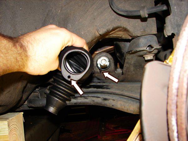

                But does it have the hole for the breather tube in the steering boot?
                (not my pic/arm)
                  (not my pic/arm)
                  Yes yes they have.
                    No don't have. Is it big problem??? Do i need that hole?
