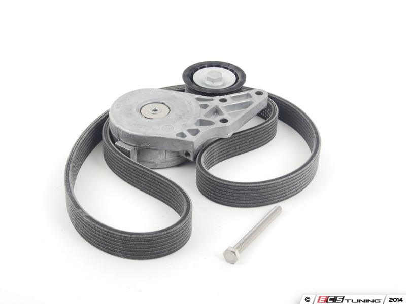

                  4) Accessory Drive Belt with Belt tensioner
                  More of a preventative thing. I could see the belt being worn so going to replace it with a brand new drive belt and tensioner so it eliminates any issues that may come up with this later on.

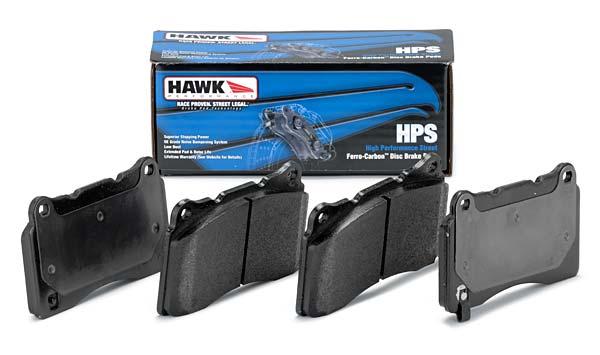

                  6) Hawk HPS pads (front and rear)
                  New pads for front and rear.

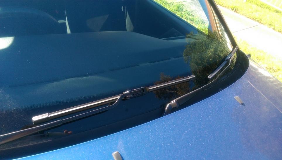

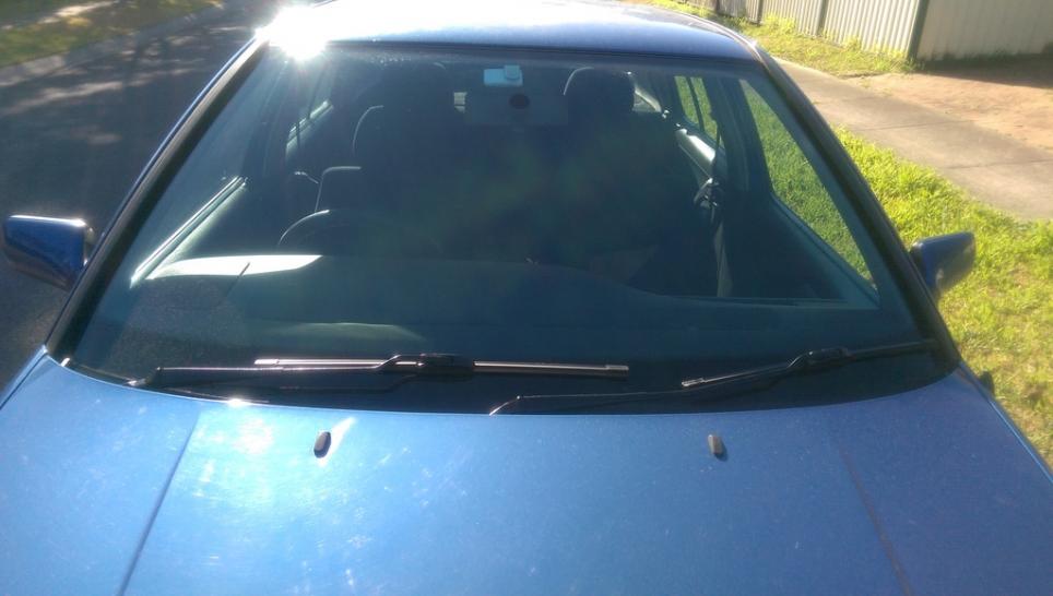

                    Decided to take off the rain tray and windshield wipers to give them a refresh. Had a can of touch up paint in Satin Black finish which was designed for repairs on pre-painted metal. Took the wiper arms off, prepped them by sanding back the existing paint with 400, 600 and then 800 grit sandpaper wetsanding, then gave it about 6-7 layers of black. It came out looking pretty much brand new.

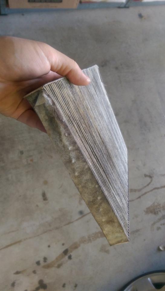

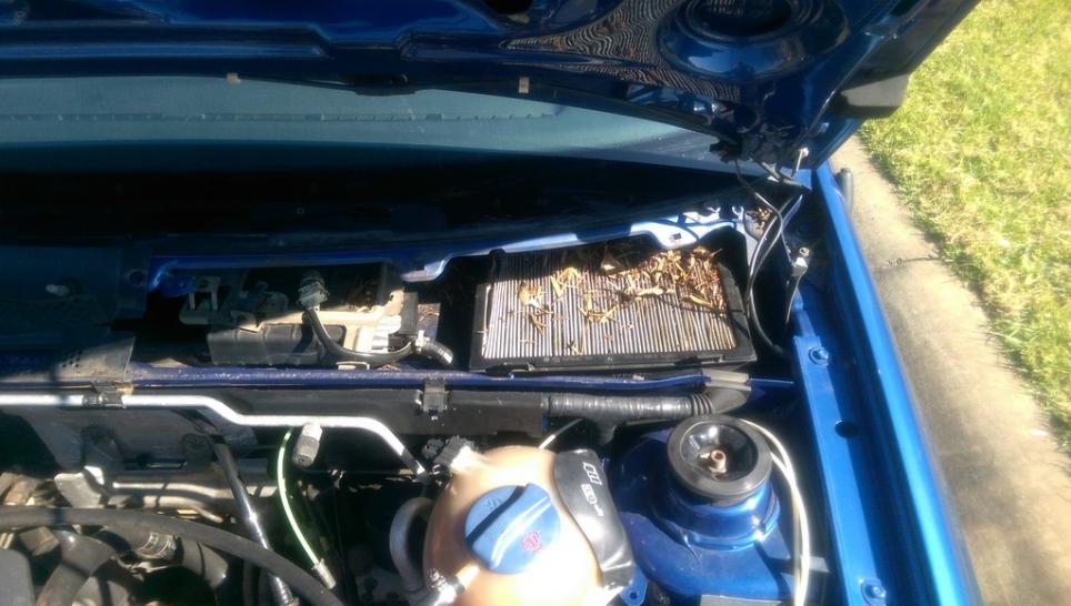

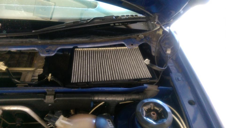

                    Taking off the rain tray gives access to the cabin filter. Unlike the MK6 where the filter is below the glove box inside the car, the MK3's had it on the passenger side underneath the rain tray. Don't ask me why but it's there. This is what I was greeted to :
                    So much buildup of dead leaves and other crap in there. Ordered some MANN Cabin filters to replace the old one and in the correct fitment. Much better.
                    The wiper blades were beyond shot and it was actually pretty dangerous when driving whilst raining as it wouldn't do anything, so I ordered some Bosch Aerotwin wipers. I have Bosch units on my Golf R as well and it's a really nice blade with a clean wipe.

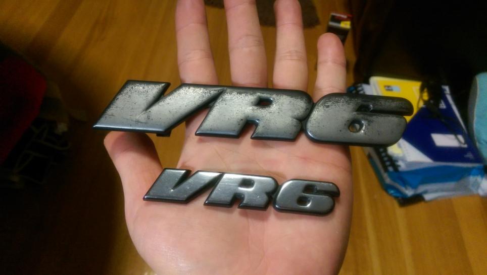

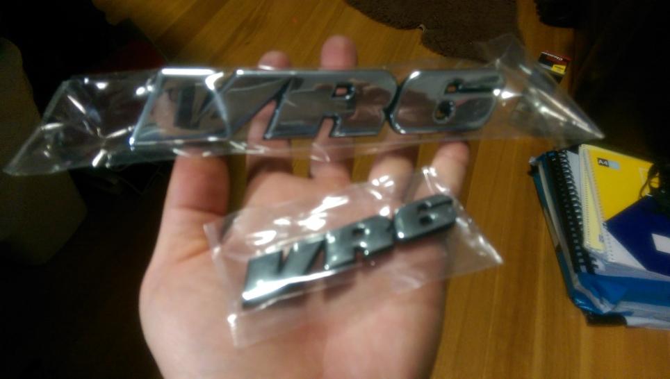

                    Also got some new badges to replace the tired old worn ones...

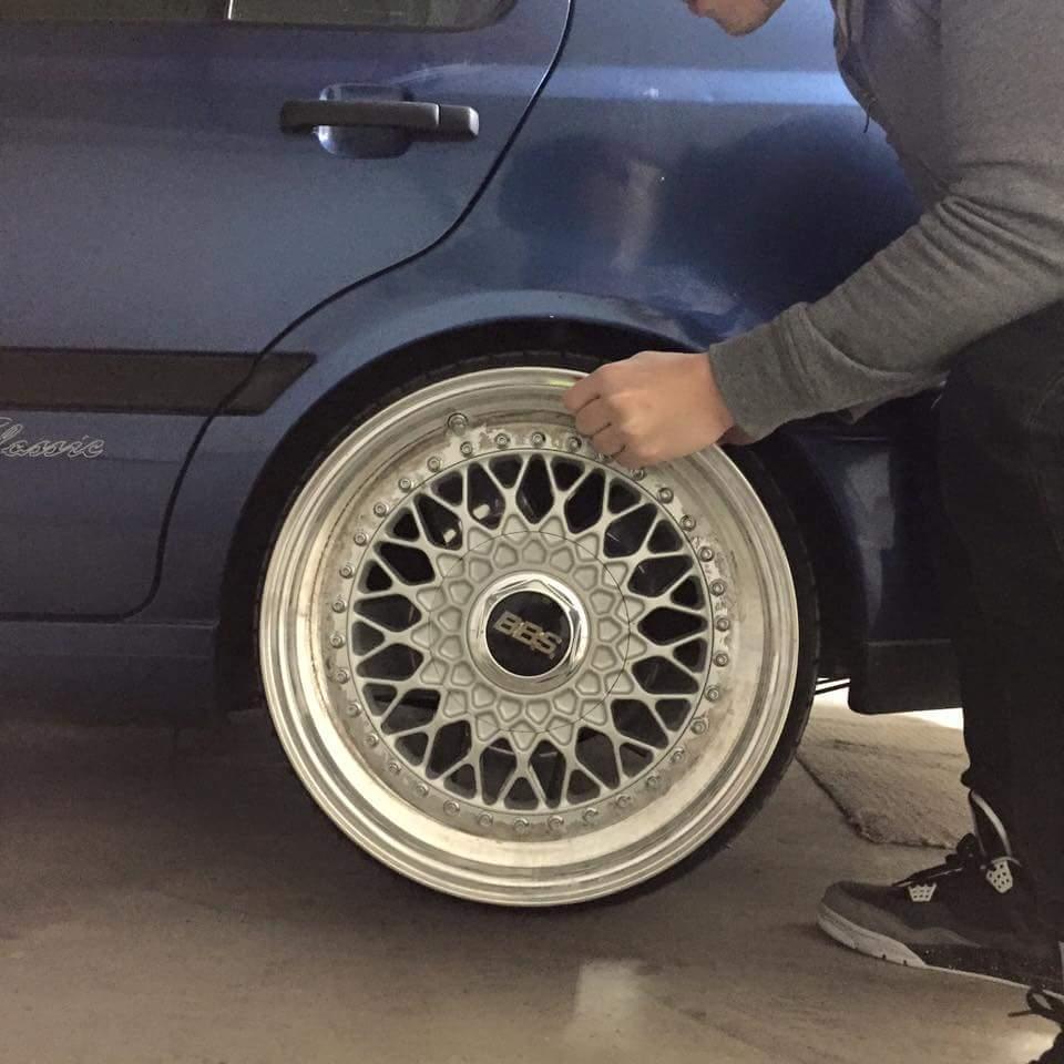

                    Will also be re-furbing these BBS RS's soon. 5x100 PCD, 16x7 and 16x8 with slant lips. May also re-barrel to make them 16x8 and 16x9. Going to get the lips polished up, repaint the centres and re-furb the original BBS bolts too with the help of Ray from RAW works. Should be good!
