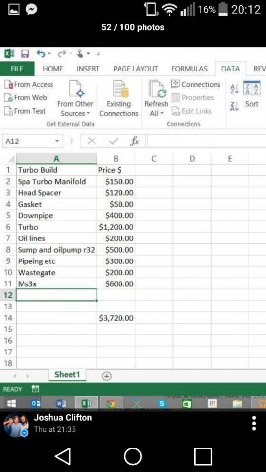

    My quick excel turbo build, this was without approx 4-500 of ARP bolts and studs and a few other things, this was also done as the cheapest you could possibly get most parts. If you want to do it properly it gets up there.

                        Cliffo's spreadsheet is a good expectation. I'd tack on another $500 for mess up's etc, also if you don't have an exhaust.

                              The thing is if you cut corners, **** will break. You won't be able to run your stock ECU, I haven't really looked into chips but my understanding is they don't work in Australia (well, if at all) as they're mapped in the US or whatever, doesn't work on the ECUs here or the fuel/conditions are different etc. Not really sure. So you'd probably want to look at running a standalone ECU. Here's my list:
                              -ARP Head studs
                              -ARP Rod Bolts
                              -ARP Main studs (depending on how much boost you want to run, you could go without these)
                              -Head spacer to lower your compression
                              -May want to look into cleaing the head up a bit
                              -Clutch
                              -Fuel injectors and rail, pressure regulator
                              -Oil pan with fittings, oil lines to the turbo
                              -Peloquin or Quaife LSD (you don't have to but that FWD wheelspin will be ridiculous)
                              -Have your timing chains been done? Your engine is at about 200,000km right? They'll need doing soon.
                              -Exhaust manifold (ATP to fit RHD cars or custom)
                              -Downpipe (3")
                              -Catback exhaust (probably want to run 3" or 2.5", 3" will increase power)
                              -Standalone ECU (megasquirt is a good budget option)
                              -Tuning time on the dyno (unless you learn how to tune, lots of info out there and its possible)
                              -Turbo (depends what you want, I'd suggest Garrett GT3076 or something, research to decide what you want)
                              -Front mount intercooler
                              -All piping for intercooler
                              -Short runner intake is optional
                              Now that your car is going really fast, you should probably look into your brakes and handling. Maybe 312mm Audi TT brakes, some decent rubber, maybe some coilovers that are a bit better handling than Hot Tunings and maybe strut braces.
                              That's my list for now... Might have forgotten stuff, but basically everything adds up! Keep researching and see how it goes. You live nearby so if I get my **** sorted some time soon and get started on my build, you should come round!
