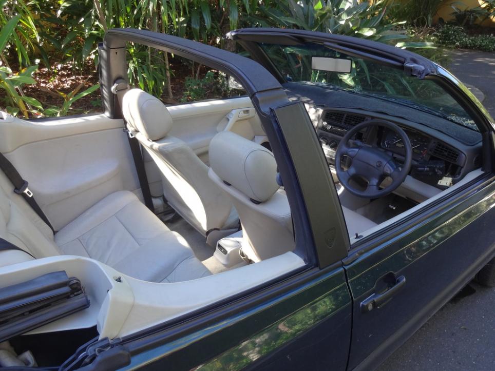

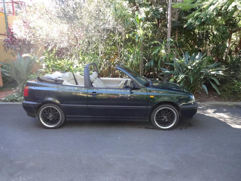

    Hi all,
    Thought I'd share some pictures of my first foray into Mk3 ownership which if I'm being honest came about by surprise.
    You see, I've always been into Mk4's and for me the ultimate Golf is the Mk2, so Mk3's never really did much for me, but since moving to Aus and realising Mk2's were rarer than unicorn poo and Mk4's still commanded quite high dollar all of a sudden Mk3's looked appealing. Plus living in Byron the idea of a convertible seemed appealing so when this appeared I had to have it.
    She needs a bit of work, the biggest thing being a new hood, which I've bought an aim to fit in the next week. Also the roof doesn't go up or down with the switch, is it a simple job of topping up the hydraulic fluid?
    I'm on the look out to replace some tired looking/broken bits too, namely a steering wheel, interior light and headlight switch, so if you have any bits let me know. Quite keen on changing the wheels to some oem ones too so if anybody wants a swap let me know!
    I'll try and keep this updated as and when I do things
