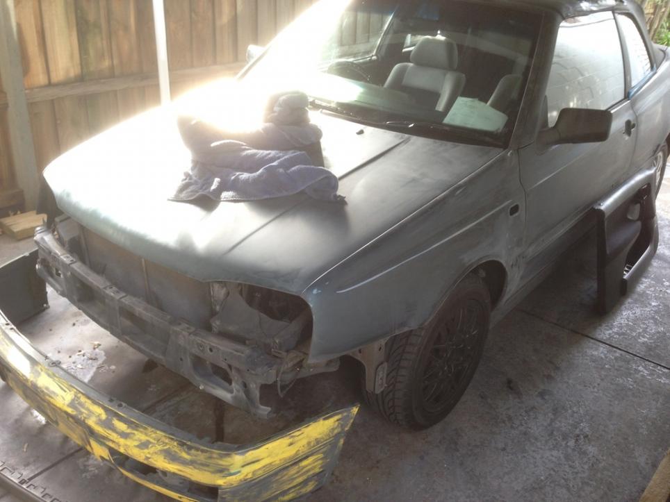

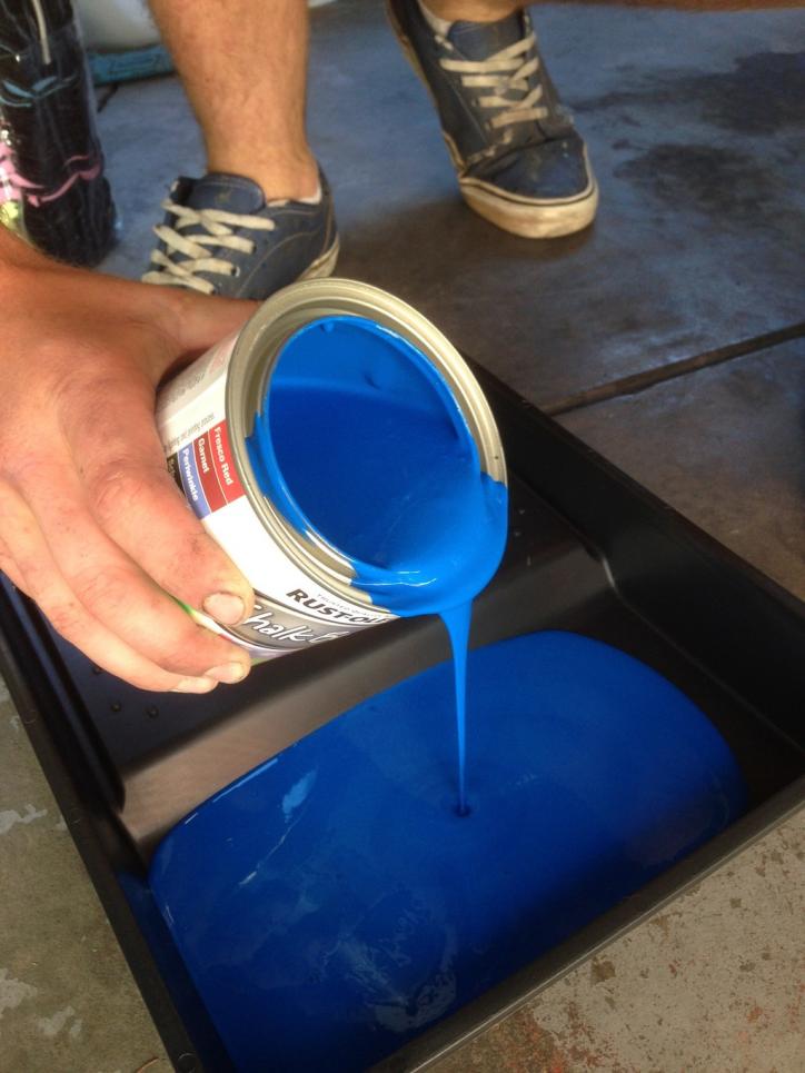

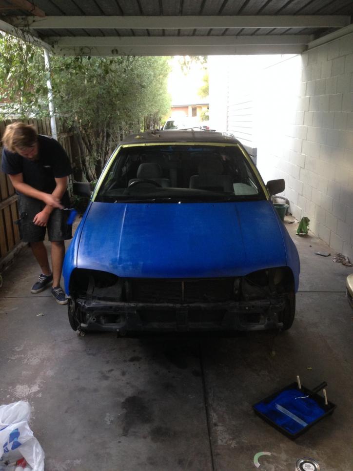

Back up on Saturday morning. Over the weekend, Tim and I painted the car. I had decided on roll on chalkboard paint after being inspired by another yellow MK3 which has been done the same. We wetsanded 240 grit all over the car and rolled on 5 coats of chalkboard paint. It's called Rustoleum tintable chalkboard paint and I picked it up from Masters. Considering it was about $150 in total for all paint and materials, I was pretty happy with how it turned out.

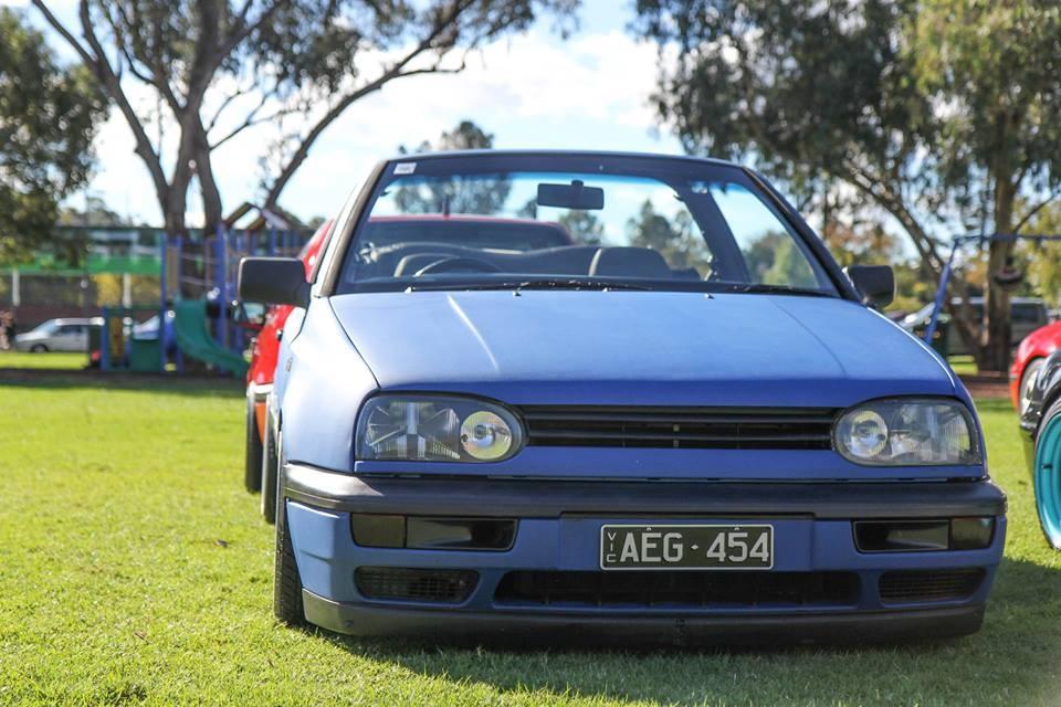

I drove down to the rego appointment on Monday half masked up with different coloured bumpers and not completed coats of paint. The rest of the week was spent after work finishing the painting off in the dark, assembling wheels, taking the sump off and having Jarred weld a 6mm bash plate on, installing coilovers and fitting the wheels up. By Friday I was putting together the last details. I packed the car, put the roof down and went to pick up my girlfriend was a huge grin. We met with a few others, drove up to the accommodation and had a mad weekend at VITS. More detail of the weekend is up on the VITS thread in the events section.
