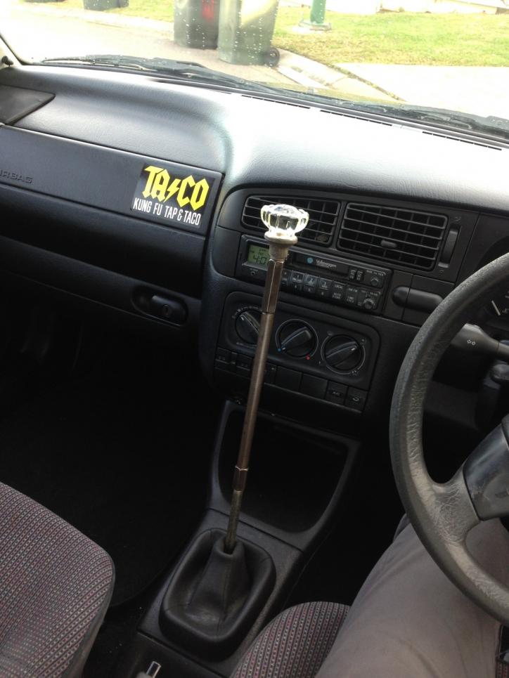

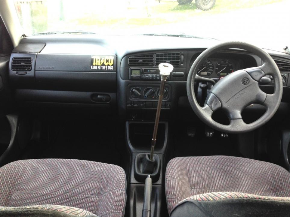

That sure is unique, I saw some guy driving around Logan the other day with a screwdriver as the gear stick.
how much throw you do get while driving it like that?Last edited by browntown42; 21-05-2015, 06:43 PM.Mk3 2.0. Mk3 VR6 CC. Future Mk2?
****, haha, you'd be changing radio stations whilst slotting third.... hahaha.... and them wheels would no doubt make the jdm purists tear a little; Not sure on them but they make me smile with the mismatched spokes, lol

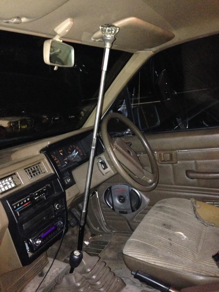

i drove for about a week and took the tall shifter out. was in there for bit of joke. i made a stupid tall one ages ago on my old navara...

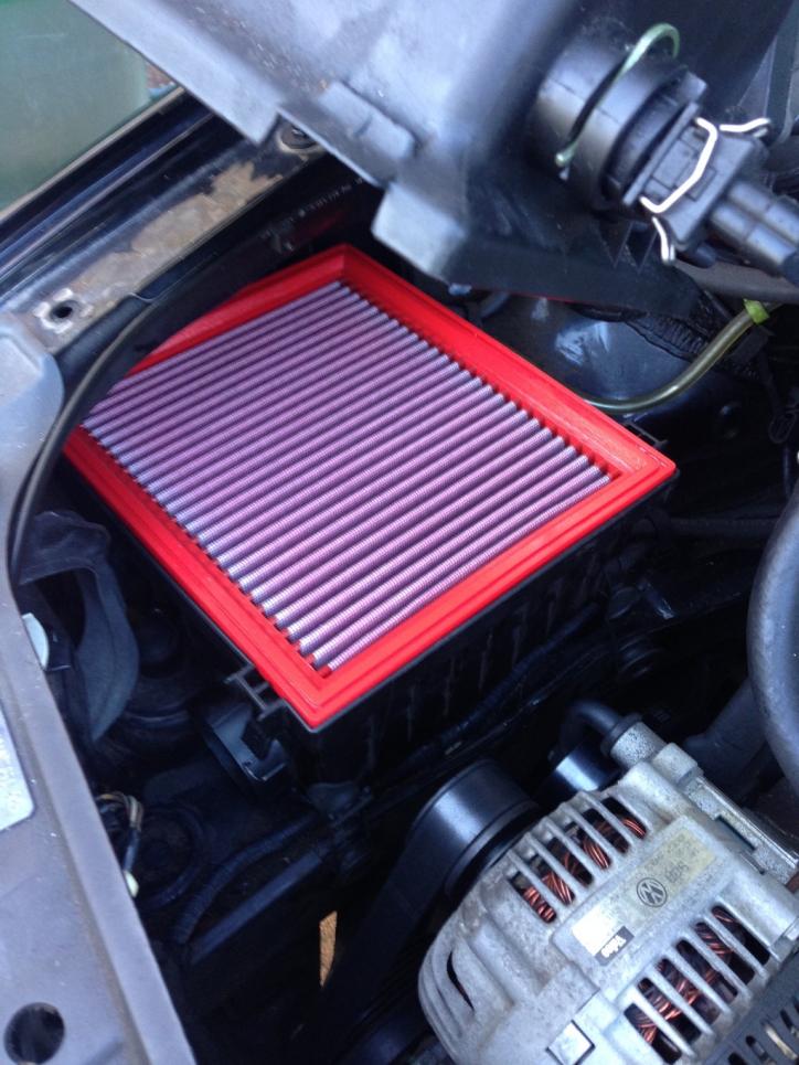

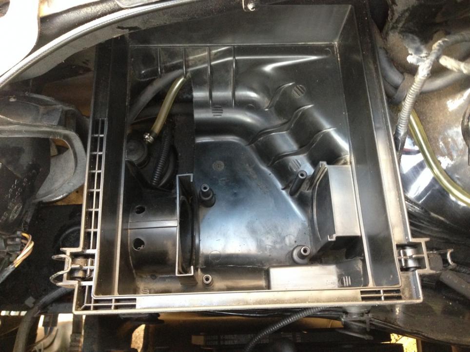

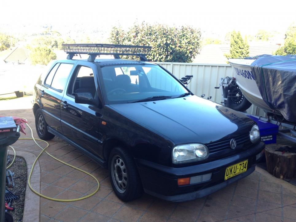

did an oil change the other day, did the DIY cold air intake mod and cut the **** out of the air box, got a BMC high flow filter, and adjusted the headlights and got new bulbs for them too.

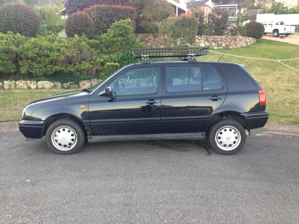

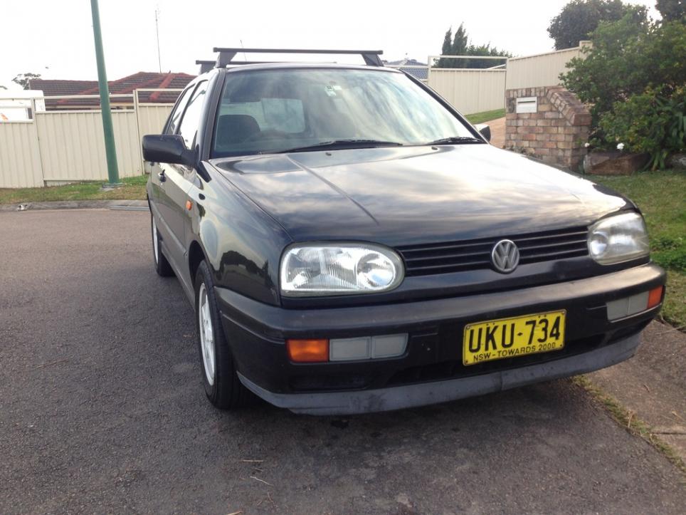

i also decided to get a roof basket too, gonna come in handy with carrying all my things up there!
ill be going to the snow this year so that will be good, plus it looks cool.

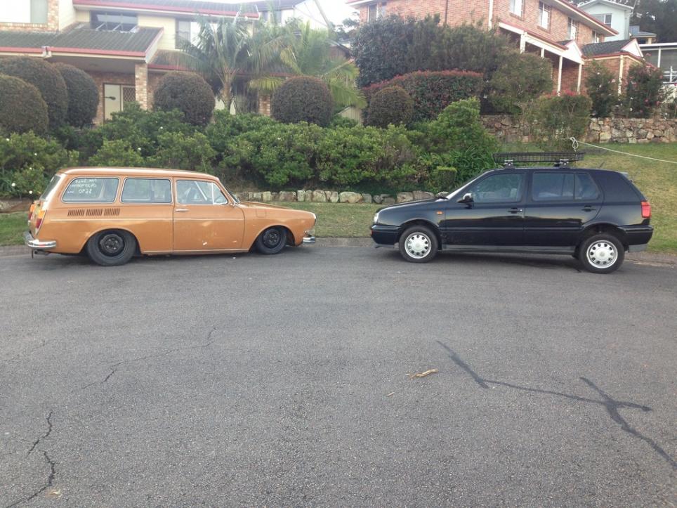

cleaned the stockies, need to get new rubber on them now. i know everyone keeps saying to slam it, but ive just got out of my squareback and im pretty done with being low at the moment. actually thinking of going the other way

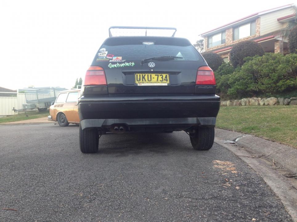

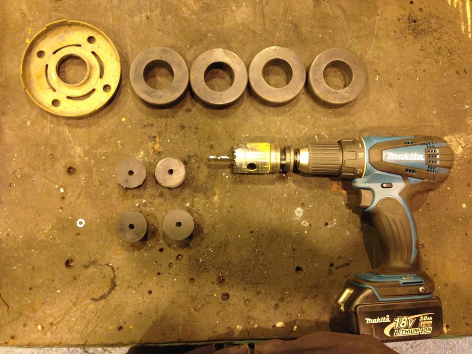

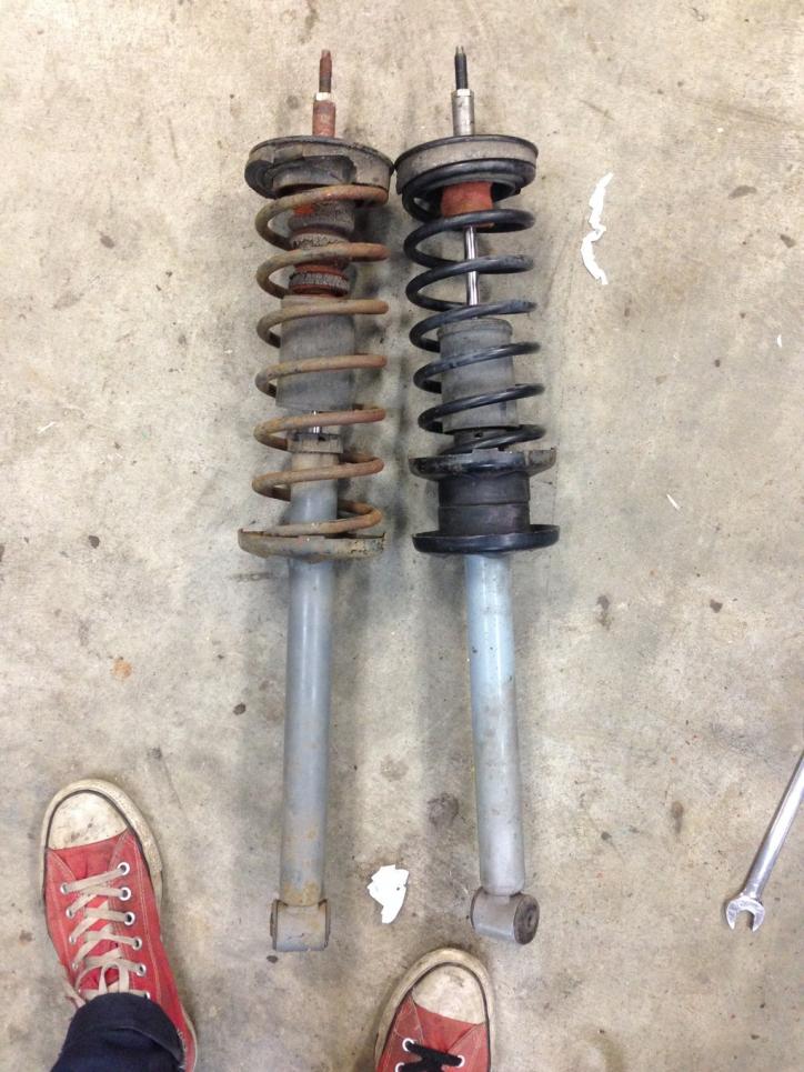

ok so having trouble finding passat struts so until then i have decided to go full on ghetto DIY.
this is only for the rear and gives about 2" lift,
stuff i used;
-4 hockey pucks ($5 each)
-lower strut spring plate
-probably best to use spring compressors but i got away without them
step 1 of diy lift kit;
drill out pucks to 40mm using hole saw
step 2
slide the hockey pucks over the bottom and then put the extra spring plate on and assemble struts
you can see in this photo it does actually raise the the strut but it just makes them stiffer thus lifting the car
step 3
install and step back, take a photo and have a beer.
this literaly took me all of an hour to do, and that was without spring compressors, if i had them it would of taken half that time.
gives a pretty good result for $20 and very little work.
next is the front which ill be using bilstein struts from and old car and spacing the springs.
