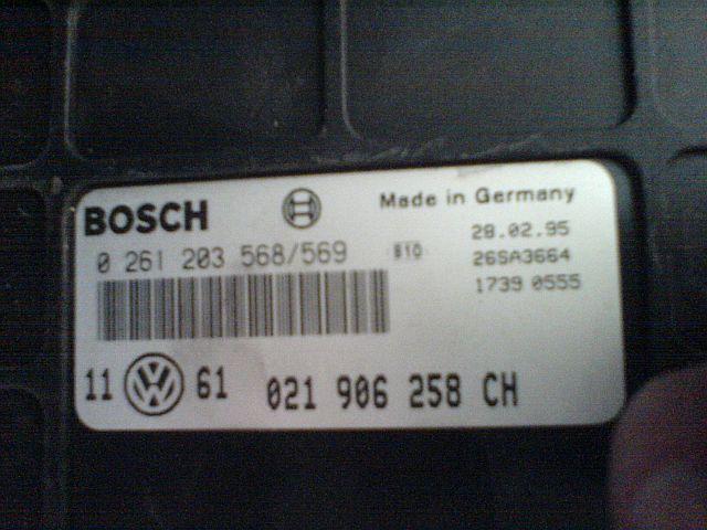

            To give you an idea this is my 95 VR6 ecu. From what I have been told its the "021 906 258 CH" part that is important. Also i believe some of the Bosch ECUs require the original chip to be desoldered from the PCB. So not always just a drop in affair

              OBDII vehicles need the original chip to be removed off the board, a new chip housing soldered on, and on which a new chip or the existing one can be inserted. This was the case for my 2l, any chip is sold with the housing and instructions so it shouldn't be too much of an issue. Try to get someone who can solder to help as its a rather delicate job, but no more than 15 minutes worth of work
              but for an OBDI vehicle, its pretty much just a removal of the metal electro-static shield and get a paper clip to pull the old chip out. Its literally plug and play.
