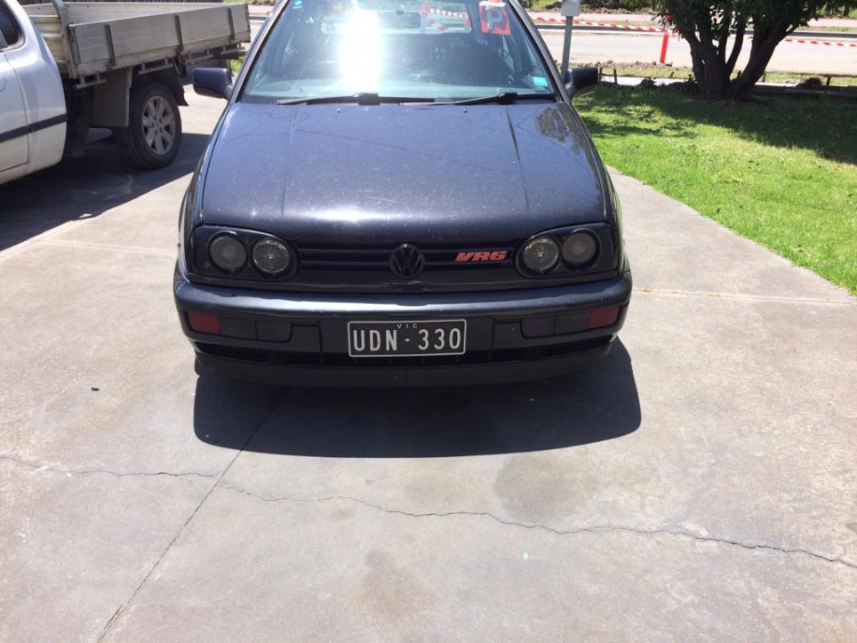

    • Painted my badge

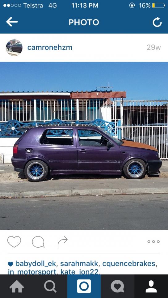

      • Thinking about welding my back doors shut and shaving it . I'll have a 3 door haha . Here's one that just had the rear doors welded, using the same front doors.

          • Not a bad idea with the welding of the rear doors, the doors on my 2d are very long.

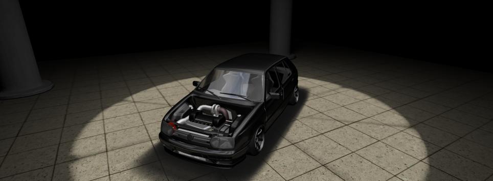

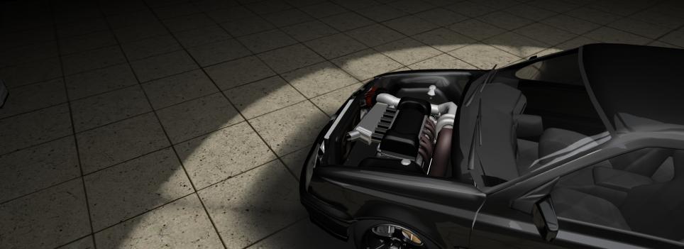

            • building a vrt on a 3d modeling site
