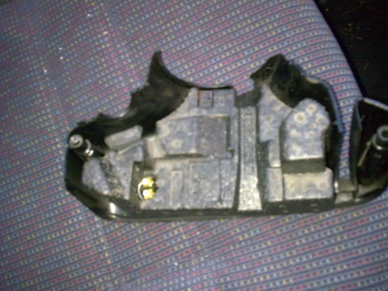

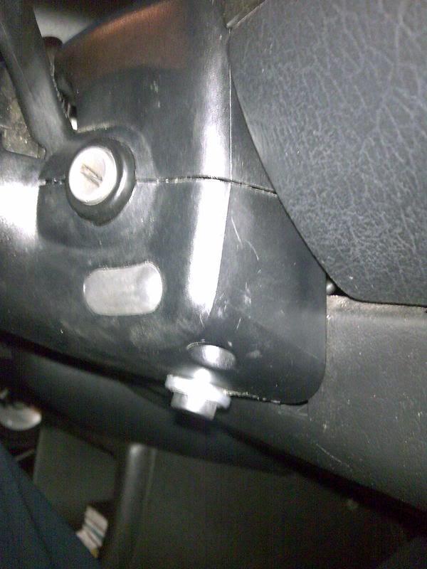

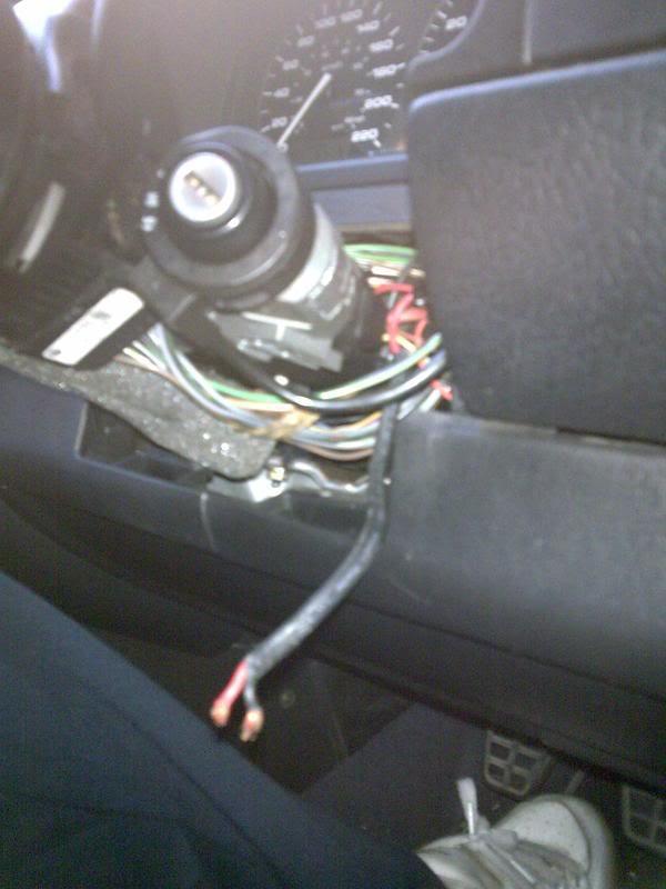

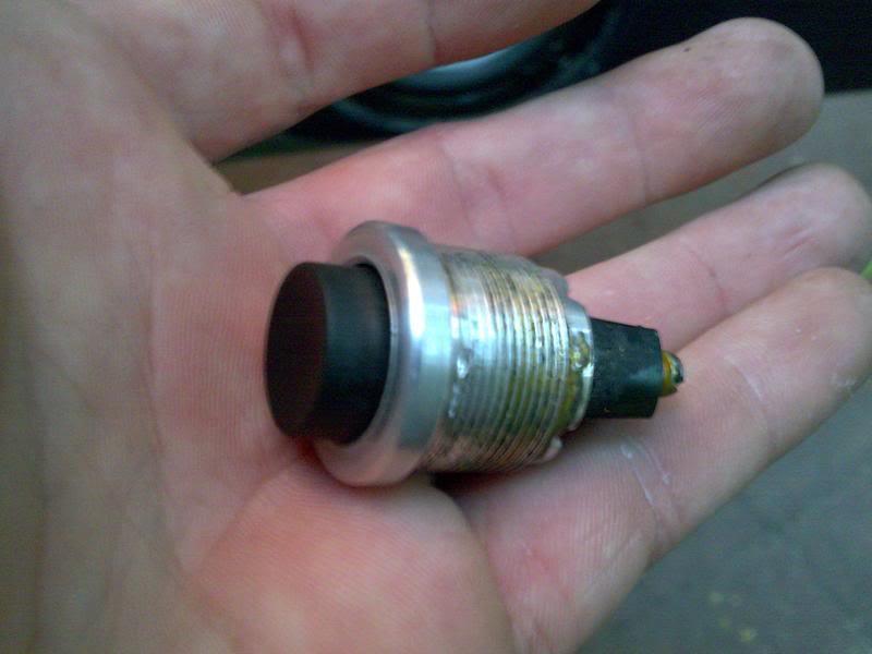

    I got sick of my button hanging down, dangling off a wire by the leg, so I decided to hide it and neaten it all up a bit. The button I had wouldnt fit inside one of the blank switches by the air con controls so next best thing was under the steeringwheel.
    This is what was already there:
    And the button:

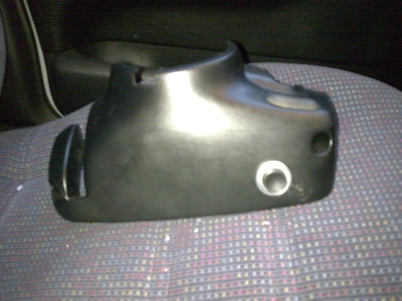

    Then drilled a hole for the button through the plastic and foam behind the cover and put the button in (fitted so perfectly!):
    And the finished product:
    (Sorry about the poor quality pics, phone camera was only thing around at the time!)
    If doing this and pulling the cover off around the steering wheel, make sure you dont break the stupid holes that the screws that hold the 2 parts together, they have caused me soo much grief, having to make new holes and find extended screws to fit!

        What kind of button is that? Does it have a special name? Electronics stores are going to be hella exacting about what i'll need.
        • #19
          Hehehe, found one!
          Was hoping for a circular one tho.
          • #20
            Ok finding alot of green circular ones on the RS components website, but need to know what kind of amperage rating we're looking at here. Being a starter button I'm assuming something around 30A @ 12v?
            • #21
              I think mine is less than that..let me check the packet. Green means go!
              • #22
                and then...???
                • #23
                  Sorry dude..packet says??
                  16amp at 12Volt.
                  Green means go!!!
