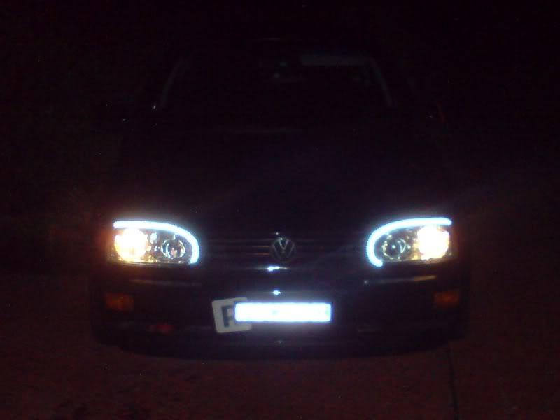

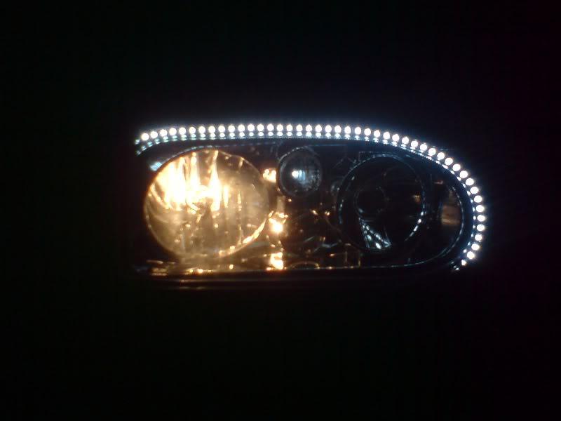

Parkers only:

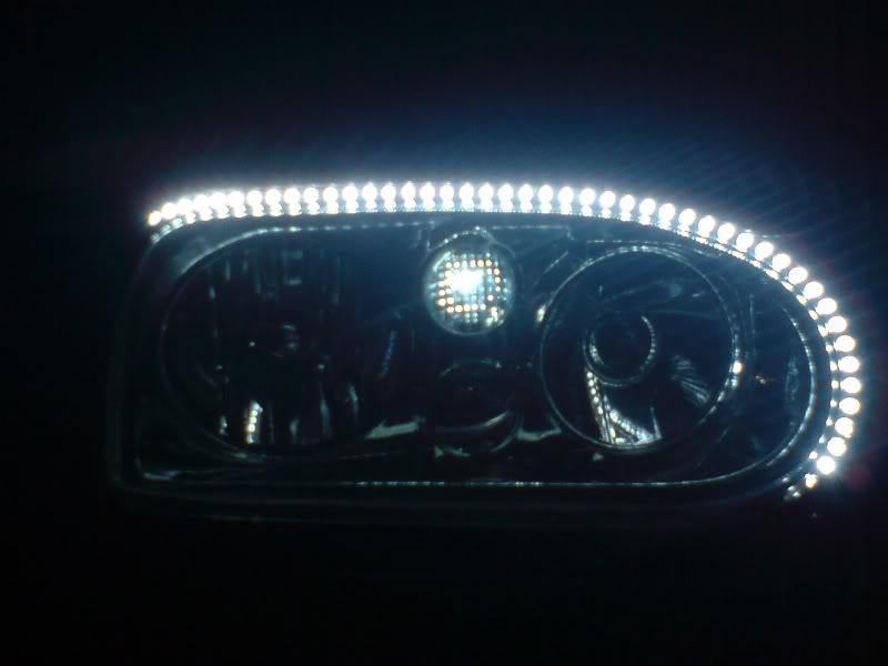

Main Beams:

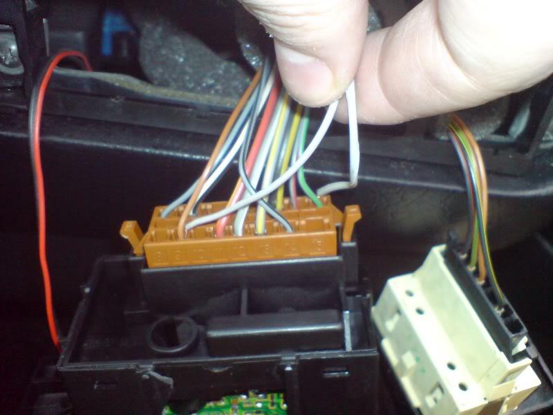

This is how I wired it up:
1. run power wire from both lights through the fire wall and up behind the dashboard.
2. pull out lighting thingo (i believe it is called a loom?)
3. turn lights to the 'parker' position
4. use a vu meter to work out which pins are for the parker lights
5. jam the wires into the back of the connector
6. re-assemble
Here you can see that I'm holding the power wires for the light strip

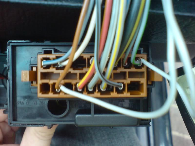

and here is a better example of where the wires go
don't hold me to it but i believe the one further to the left is the negative.
