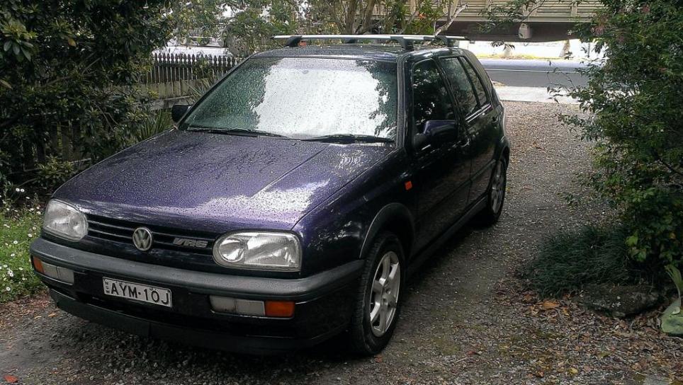

    Came across this beastie yesterday afternoon and bought it at 10pm last night.
    Now i know you should never buy a car in the dark but at the asking price, i was not too worried. The only real surprise i got was that it was purple and not blue as the online photo's made it look. Not a big deal.
    It has a few niggly issues such as a sometimes faulty guage cluster and occaisional starter motor problem. It also hase some sort of leak in the central locking pump thing where it continues to run for about 30 seconds after being activated.
    There is some terrible rear window tint bubbling and some paint fade on the bonnet but otherwise, it is in pretty good physical condition. Not sure if i will leave the roof racks on it or not yet.
    There is a huge difference in the feel of the the gearbox throw compared to my 4Mo though. It is like rowing a boat compared to the Bora!
    Is this common or should i look at a selector/linkage replacement or even a short shift style kit?
    Anyway, picture!
    The guy said something about it being limited edition. Not sure if he was referring to the color or maybe just VR6's being thin on the ground compared to other model. Can anyone comment on this?

        Hmm, special edition? VR6's are special You're missing the BBS wheels though. Looks to be built around the same year as mine (square side indicator is the giveaway).

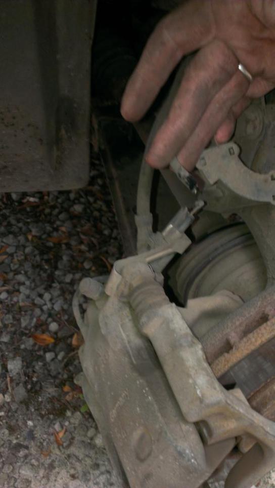

              Also noticed that my brake pad sensor wire has been severed at some point. Recently by the look of it too.
              And last but certainly not lease, i had to drive 40km in 3rd gear this arvo to get home. The gearbox crunched going into 3rd and then would not come back out again. An interesting drive to say the least.
              I'm not exactly sure what the part is that snapped though? If somebody could take a look and let me know what and where to order this/these parts, that would be very much appreciated.
                Something has defiantly come undone or broken on the selector. Can you move the shifter from inside the car?

                  Yep! The shifter moves from within the cabin but feels all sorts of wrong.
                  That flat bracket in the lower half of the photo looks to have snapped off. I need to dig up a factory diagram to see if i can identify the correct part number. I would not think that part comes with any short/quick shifter offerings?

                  EDIT: This bloke seems to have a very similar problem only his complete bracket has snapped off. It must have an upper and lower section that joins the 2 parts together. Mine has only snapped off on the upper part leaving the lower section intact.

                    The shifter issues have been sorted. Replaced the broken part but need some slight adjustments to make 1st, 3rd and 5th engage smoother. I also ordered a new shifter bush and rubber washer and solid shifter bracket mounts but i have not fitted any of that stuff yet. The main concern was getting it back on the road and i succeeded at that.

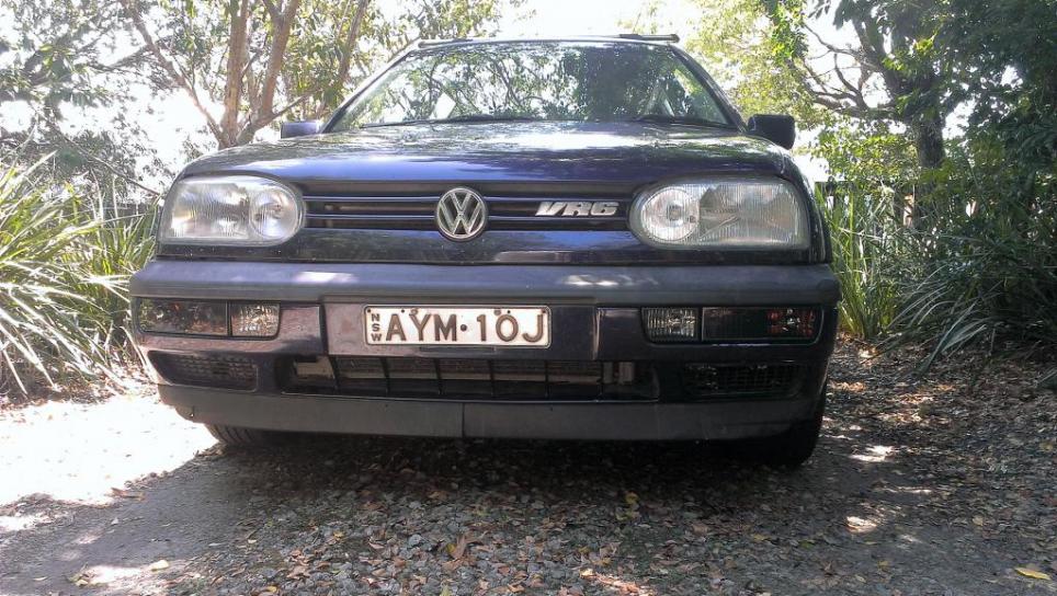

                    I also fitted new clear, clear, red tail lights, smoked front indicators and have a set of headlights to go in also when i get 4x H7 bulbs for them. Sorry but i forgot to take a photo of the indicators... another day when the head lights are in
                    Pic...
                      Really like those tails
                        Pic of the indicator/reflector thingies...
                        That is all for now. Still no progress on the previously mentioned headlights, engine mounts etc...
