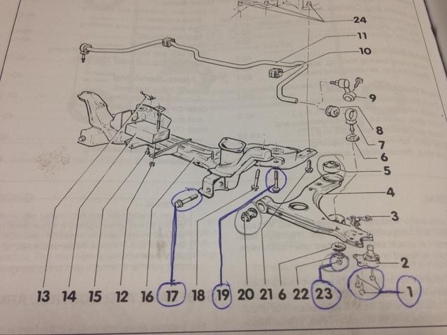

      Pretty simple, just remove bolts 1, 17, 19 and 23, (look at image) and with a bit of fiddling it should come out.
      Hardest part is pushing out the old bushing and pushing in the new one!
      Re torque bolts;
      -1 to 35nm
      -17 to 50nm
      -19 to 70nm
      - and 23 to 25nm
      and you should be good! hope this helped
