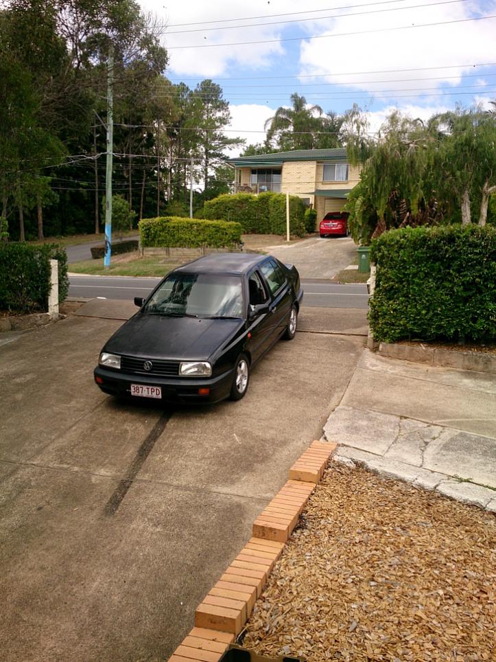

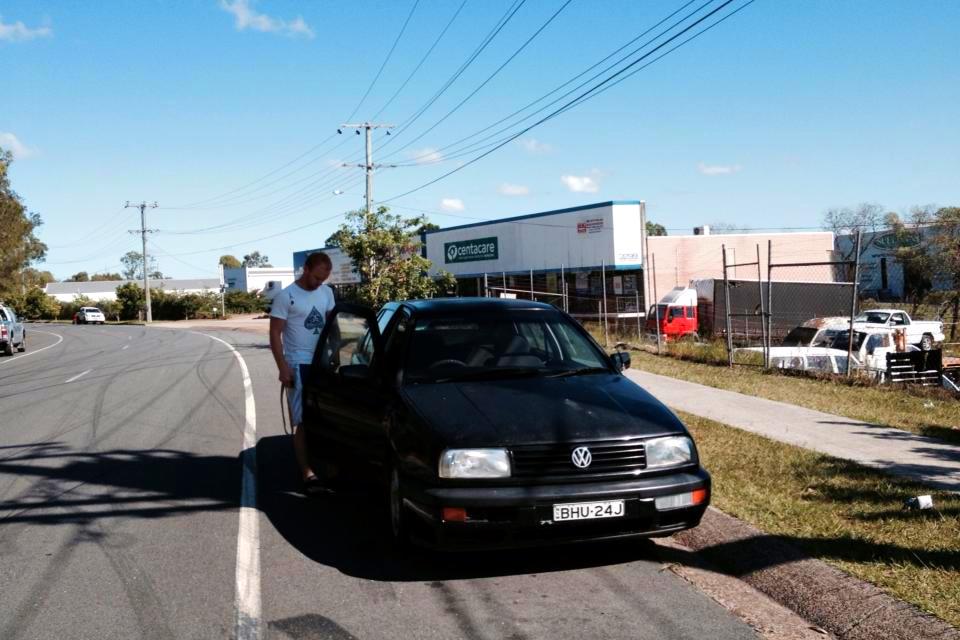

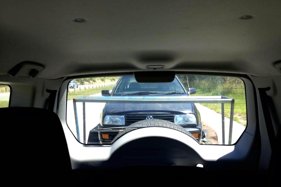

    Either way, here's a little timeline of pics..... will get better ones soon....
    He strikes again....
    Picked up!
    and dopped off....

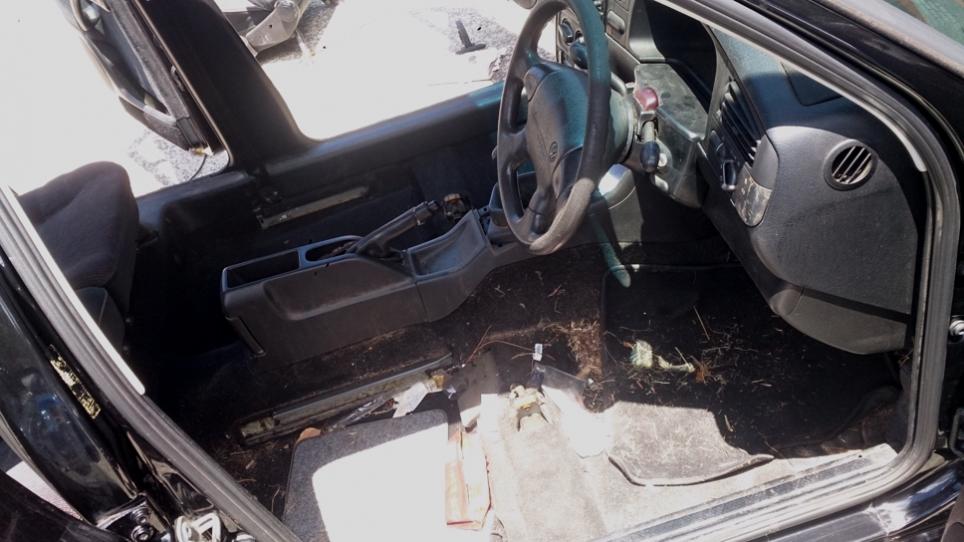

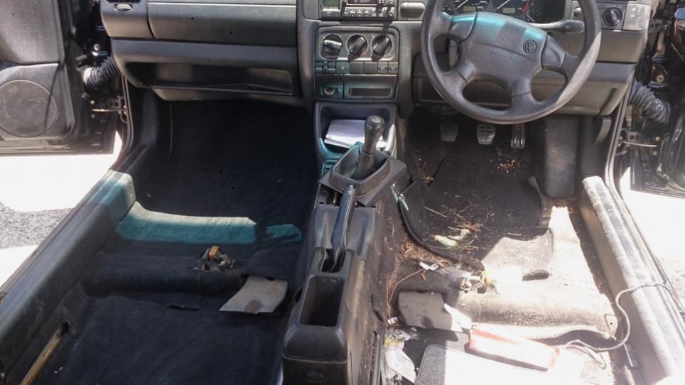

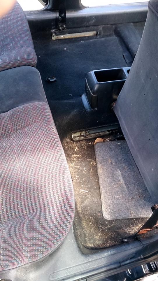

    That interior...... The amount of little white dog(?) hairs, sand and "big" rubbish was insane......
    Registered and home!

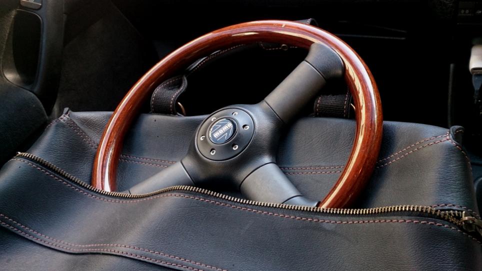

    "New" momo wheel! Love this thing!
