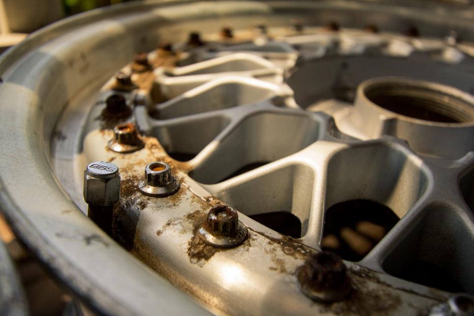

          Pic of said lip?

            best I have is my "artsy fartsy" one at the moment...

              Looks like a .5" to me from the pic

                I'm with dyl here.
                I believe the lips are measured wrong. The measurement needs to be taken on the backside of the lip, not the front.

                  Yeah, thats exactly how mine look/measure up

                    You have half inch lips.
                      So are the new lips 2", or 2" bigger then original? Got a pic of them with a tape on them or a measurement of the whole wheel with the new lips mounted up?
