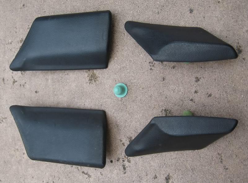

                              If you are pulling the arch covers off a 5door - this is what you need to fill the four gaps at each corner - and it never hurts to replace the eight rubber bungs either - the green thing in the middle of the pic.
