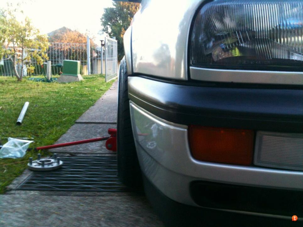

My sorta new mk3

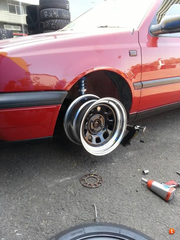

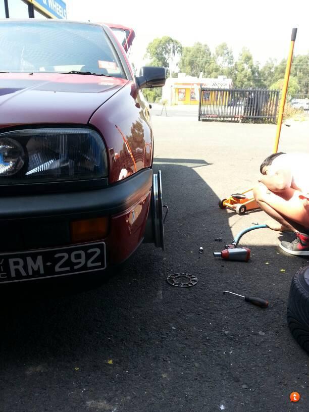

Hey buddy,
This is what 15x8 +0 with camber looks like in the fronts.
I didn't end up mounting then on the back. They needed at least a 3mm spacer to clear the brakes.
So that would make it 15x8 -3. Or you could just shave 3mm off the tip of your brakes.
