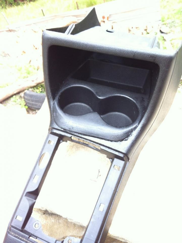

                I had started working on one yesterday. Hacked up one with a dremel, used a soldering iron to plastic weld it in place and then sikaflex to close up any gaps. Turned out average. Still need to clean up some of the sikaflex residue
                  I take it that its the right front / side that needs to be cut. One of those things where hopefully some time and patience will give us both a good end result. Did it fit without cutting back the front right?My ununderstanding is they fit but don't lock in place?

                    I cut out the whole bottom of the console so it sits down inside it. Was a lot of trial and error, test fitting and mucking around. I got a little over it and cut a little too much so it definitely isn't perfect. After the hole was cut I melted the plastic together from the bottom so hopefully it won't move.

                      I didnt realise that there was that much work involved ... Guess I will be tackling it with no rush and trry to get it right first time round

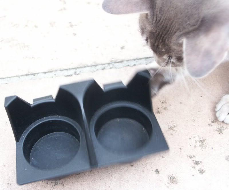

                        I just got a spare incase I stuffed it so I wasn't left without.

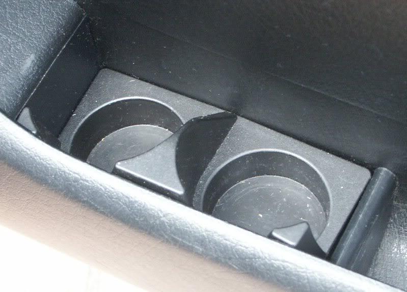

                          Got these in both my door pockets - no brand name, nothing! Never seen them new anywhere! Scored from a mk3 Japanese Import.

                            They're awesome! Shame there's no part number or anything to hunt down more
                              omg i want those!!
