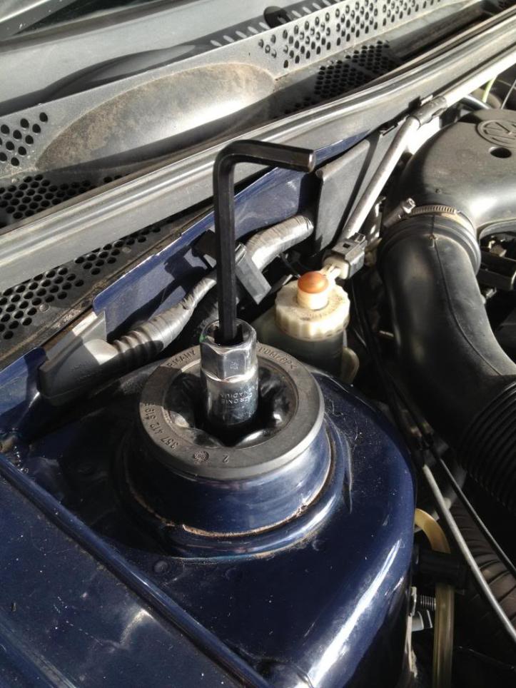

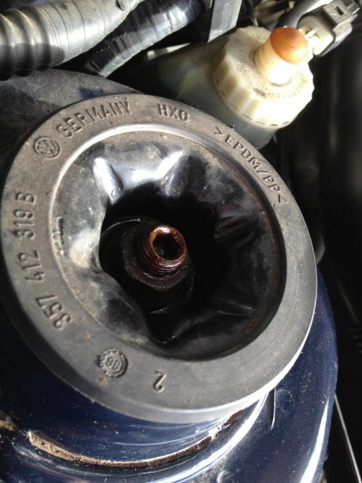

    Hey all, so i'm trying to get my stock suspension out. I've started on the front and so far so good. Untill i reached the 22mm nut ontop of the strut. I don't have access to a rattle gun or whatever it's called, so i'm using a 22m spark plug socket and a 7mm allan key. Though no matter how hard i try, the allan key + strut still move with the socket. Am i doing something wrong? I've covered the nut with WD40 plenty of times and left it to soak in, but no luck! please help, thanks

    You need lots of leverage mate, throw a jack arm on the Allen key and and spanner on the socket.
    In his pic I used two jack arms as I have a vw tool to remove the nut but you get the idea.
      Thanks heaps Anthony! Went back out and put the jack arm on the allen key giving me heaps more leverage and a little bit of elbow grease and they came off! Thanks again mate.
