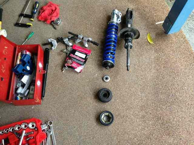

        Got this much thread after doing up the bottom nut?

              Correct, before you stick it all in the car and bolt on that pressed steel cup that stops it all falling out. If you don't have the thread, which you don't, then the problem would be the way you have it assembled or there just isn't enough thread there at all.
              Compare the length of thread on a std strut, with the coil overs, be a couple of mm difference max.
              • #22
                Thanks again for your reply h100vw, I checked the thread before I installed it (From memory) and they where exactly the same size, its defs something I did wrong I doubt I would have been sent the wrong coilovers. Its prob gonna be something small that I didnt even notice. When I did that bolt Im pretty sure I did it as far down as possible!

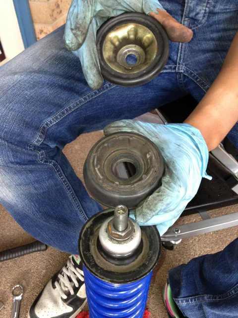

                  While waiting for a friendly fellow dubber to help me out I decided to have another crack at it and got it right!!! I had my order wrong. I placed the nut first then the bearing over it when it should have been the other way around. Now I have all the strut bolt poke I need!

                    Urgent Coilover help needed please
                    That was the old setup that did not work. By swapping the order if the nut and bearing its all good now

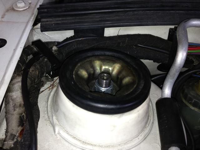

                      This is what worked. And the final result
                      and that's not 100% tightened.
                      Thanks for all the help guys!
