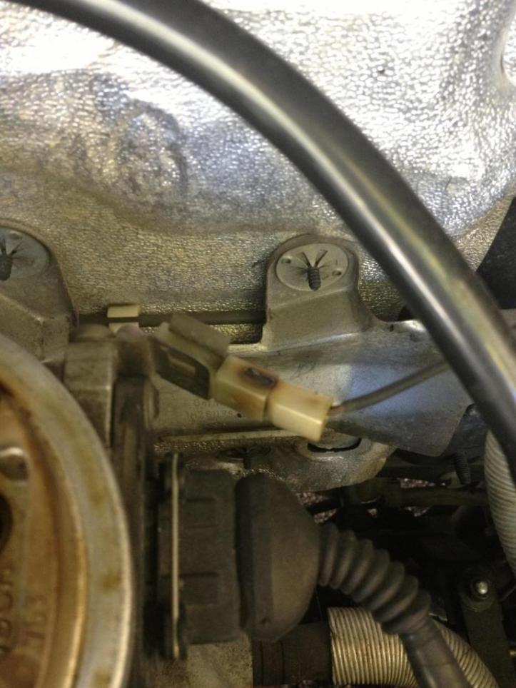

      The plug in the back of the throttle body was burnt out. May or may not be related but still it cant be that good?

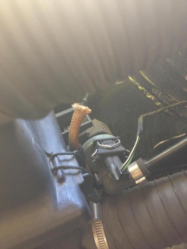

      Also this line, which comes out the back of the bottom of the air box, was freely hanging at the other end, and I could not directly see where it should have gone. Is this a vacuum line?
        The burnt out plug is for the manifold pre-heater, which aids cold starts by warming up the air in the inlet manifold.
        The line that is missing connects to the back of the plastic plenum on the top of the injection unit. This is most likely the cause of your issue as this will be letting a constant flow of air into the back of the injection unit. This line operates the flap in the bottom of the air cleaner box and should be fixed as it will be always pulling hot air off the exhaust manifold even when the engine is warm.
