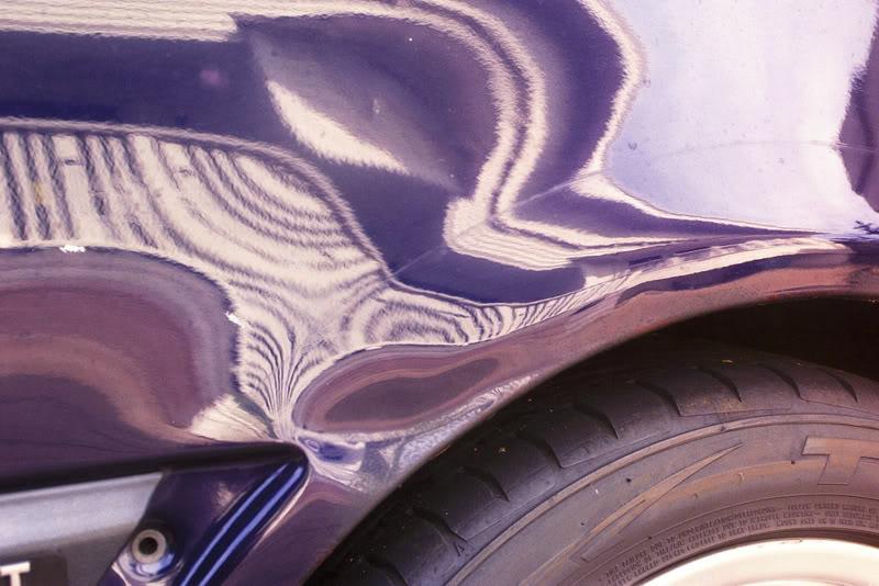

                            Some of you guys with arch covers might find the horror i found when i took mine off, the top edge of them has rubbed against the clear coat and left a mark in the shape of them In all four corners so i have to sand the paintwork back or do a heavy cut and wax job.... and fix the small supermarket dent hidden under the LH side rear one...I have the GLI/CLI narrow rub strips all painted my colour and ready to put on...then the bumper tops will get done
