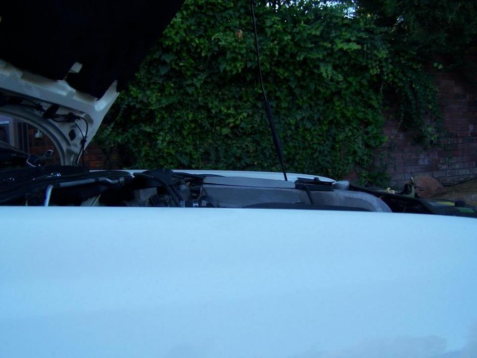

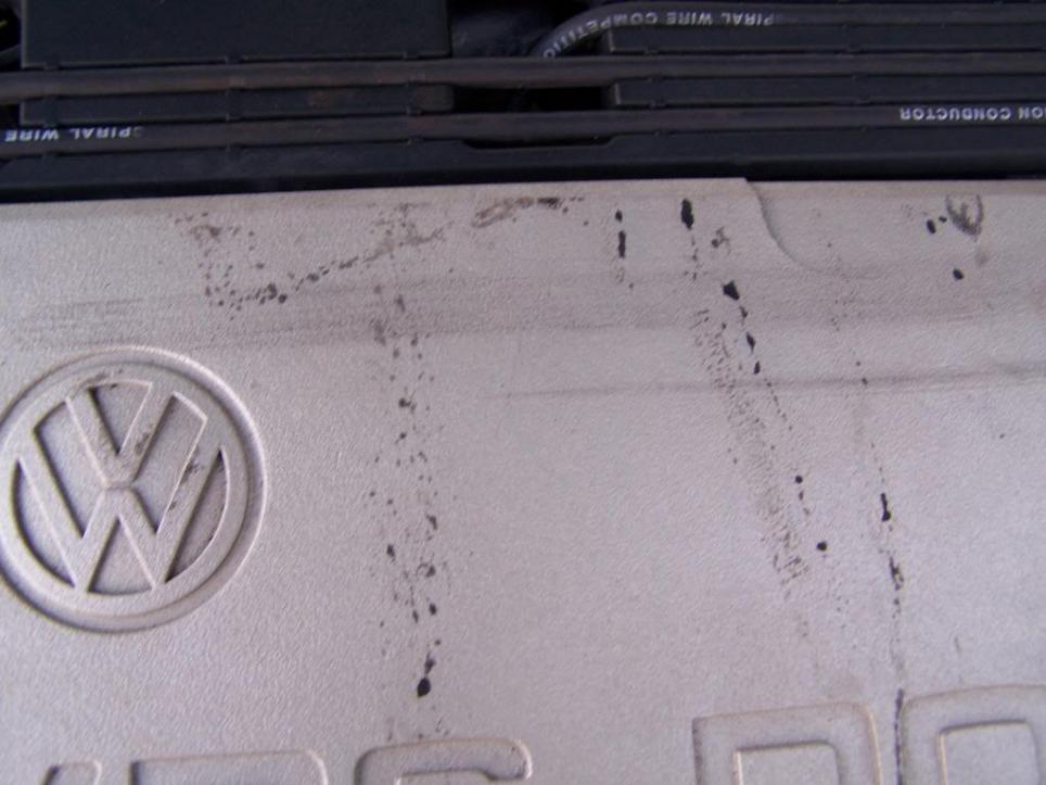

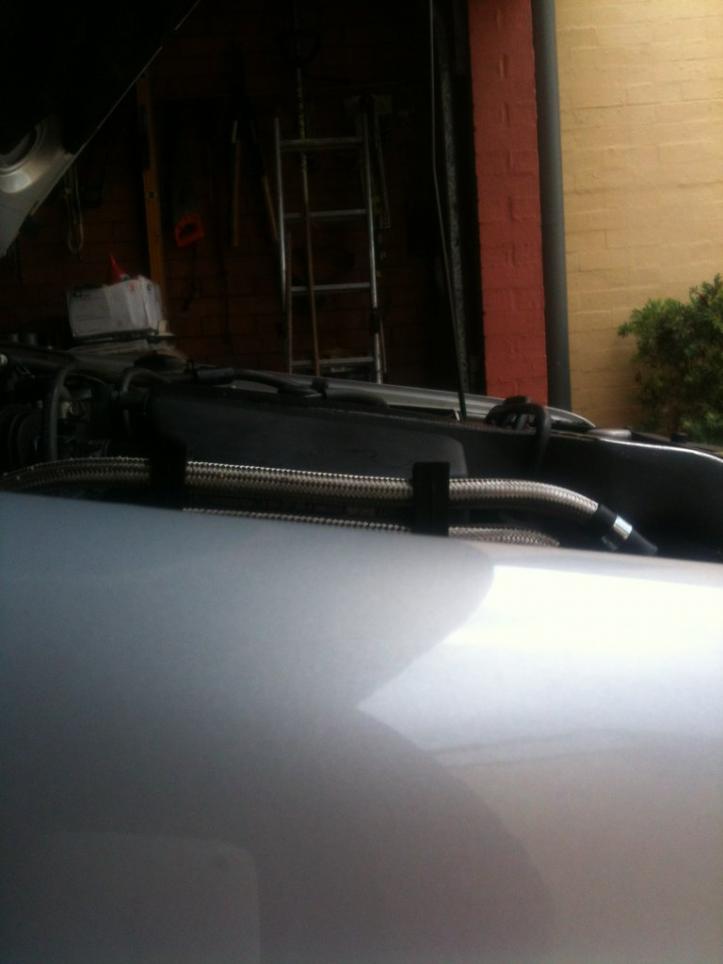

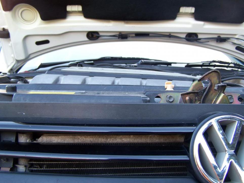

            OK I've had the mount out to-nite and took it to pieces, all looks ok provided I've used the right bit of urethane. here's a couple of photo's;
            Firstly this is what i noticed, the lines across the cover
            view from the front
            view from the side
            Without the mount installed the engine moves up and down without interference.
            Even with the crooked engine and the bonnet closed there is 15mm of clearance so I've no idea how those lines got there.
            Anyway, now I'm not bothered about the clearance but more that the engine isn't flat and looks wrong. The only thing I can think is that I installed the front urethane in the drivers mount and vice versa.
            Anybody got any ideas? Does it look worng/right?

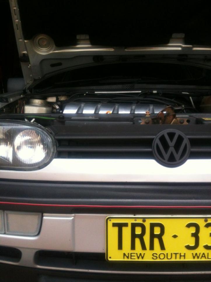

              This is how mine looks.
              The front and rear mounts are the same thing. So it doesn't matter. I think the tranny mount should be a bit higher thus making the engine more horizontal.

                  I meant. Mine looks like yours.
                  I'll show your some photos. Cars getting some stuff done till Thursday though.

                            thnaks for the photo's. Yours looks similar to mine
                              VR6 Engine very high
                              That's before I put in spacers. The spacers make the engine look like its out of the bay.
