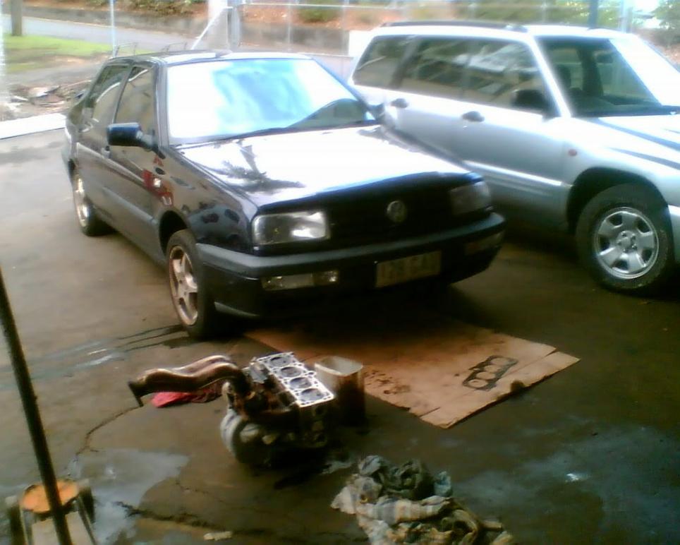

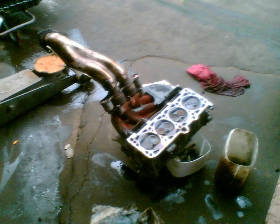

    So last Saturday with my mates help we pull the head off to survey the damage. Surprisingly it is not so bad. One bent exhaust valve.

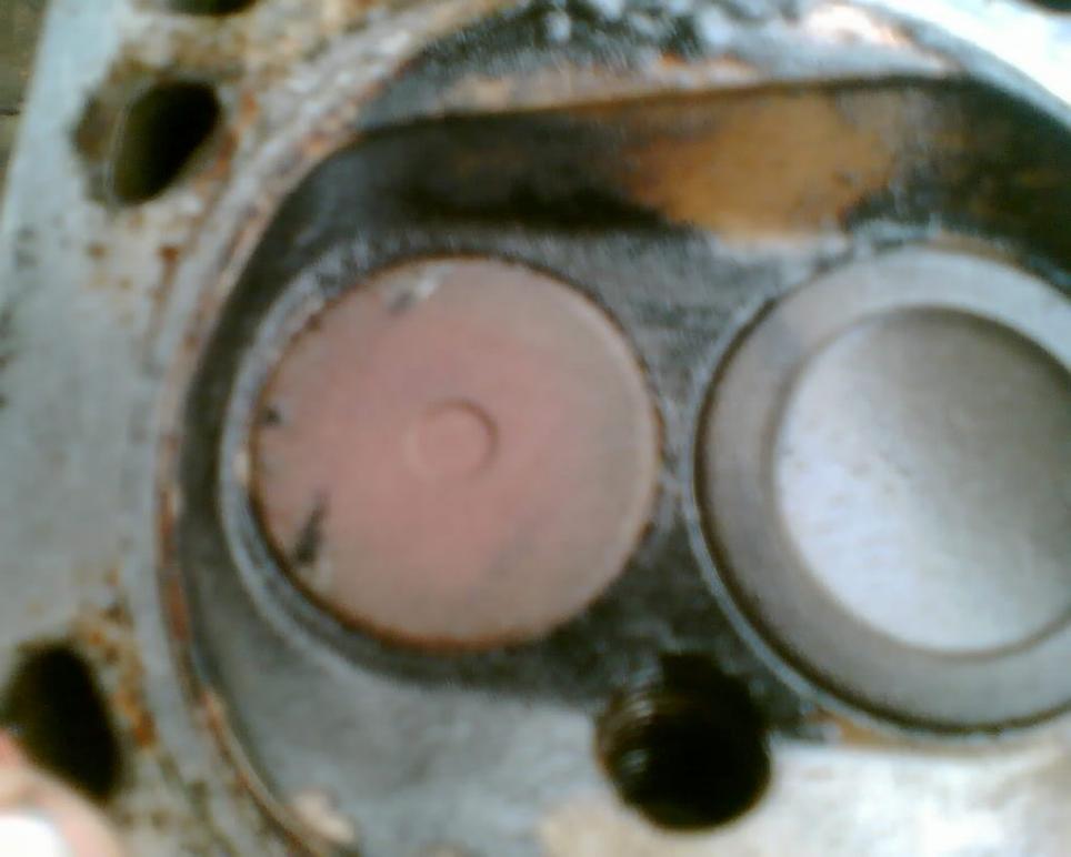

    I have included a few photos. Sorry about the quality I only had my phone with me. You can see in the close up (hopefully) there are 2 little black arcs on the left of the valve which are the witness marks of where it came into contact with the piston in number 1 cylinder. There is a noticeble mark on number 4 exhaust valve as well but an old fashioned kero test appears to show that it is OK.
    I am hoping to get it all put back together tomorrow. A bit of a bugger just before christmas.

    Side note, the front end looks so high without the block in
