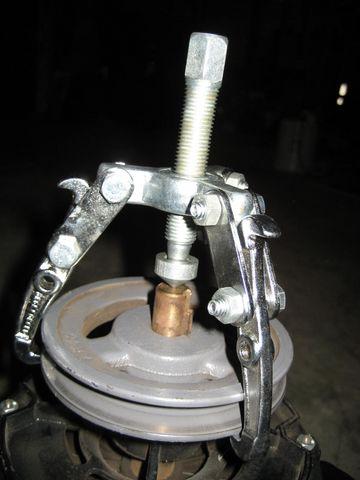

        Can you get some sort of a puller on to it like the ones to remove pulleys or the steering wheel?
        As you are replacing it, doing things to it is not impoetant, as long as you don't damage the bits you will have to re-use.

            I use jaw pullers. Also used them for seized on rotors.

              Yep, that's the sort of thing. I had to use an old gear puller I had to remove the plastic drive square on a tap spindle the other day when I changed a tap washer. The only other way would have broken it and then I would have had to buy a whole new tap cartridge. Another way is to find someone with a hydraulic press and press it out.
