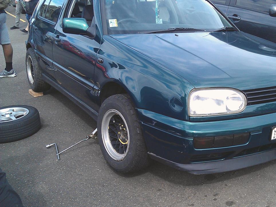

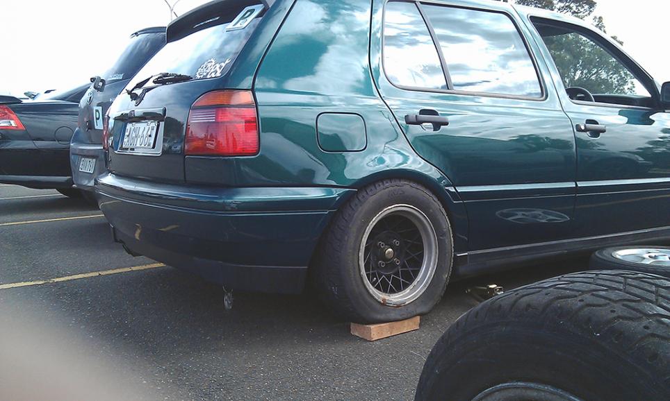

    Just a quick question guys, I tried to test fit some wheels the other day. Rears cleared just fine, but the fronts hit the calliper and looks like I'll need at-least a 10mil spacer.
    Was wondering if anyone had similar spec wheels on their cars or others that can show me photos of?
    Technically speaking I'm looking at 13x7 +10 up front! Too much poke? Too small rim?
    Obligatory fitment pictures.

    The ****? 13's fit over the 256mm brakes? I always thought they didn't.

        Haha that's awesome. I say do it! With an et10 should be fine. I was going to run 7 et0 with vr widetrack so I'd say you have nothing to worry about. I too am surprised it clears the rotors.
          I got a 7 with a et of 20 with a 20mm spacer and I have good poke. This is on a vr too.

              Yes, rechecked if they fit over the rotors. They do surprisingly! Just need spacers to clear callipers and obviously extended wheels studs and centre bore adapters.

                      13's are tiny for a mk3! Even on the little mk1's they look small. Must admit in those test fit photos they look kinda cool in a different kind of way, will be hard to pull off though.

                        are you sure they actually fit on?? or are you sure they're actually 13's and not 14s?
                        becareful of pushing a really skinny wheel really far out, doesn't always look good

                          though might be ok with the chunky tires....
