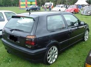

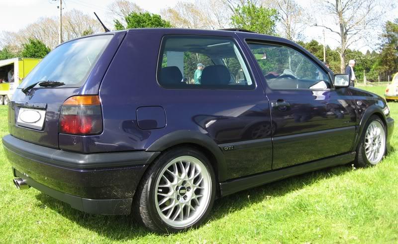

                          VR6 with
                          without
